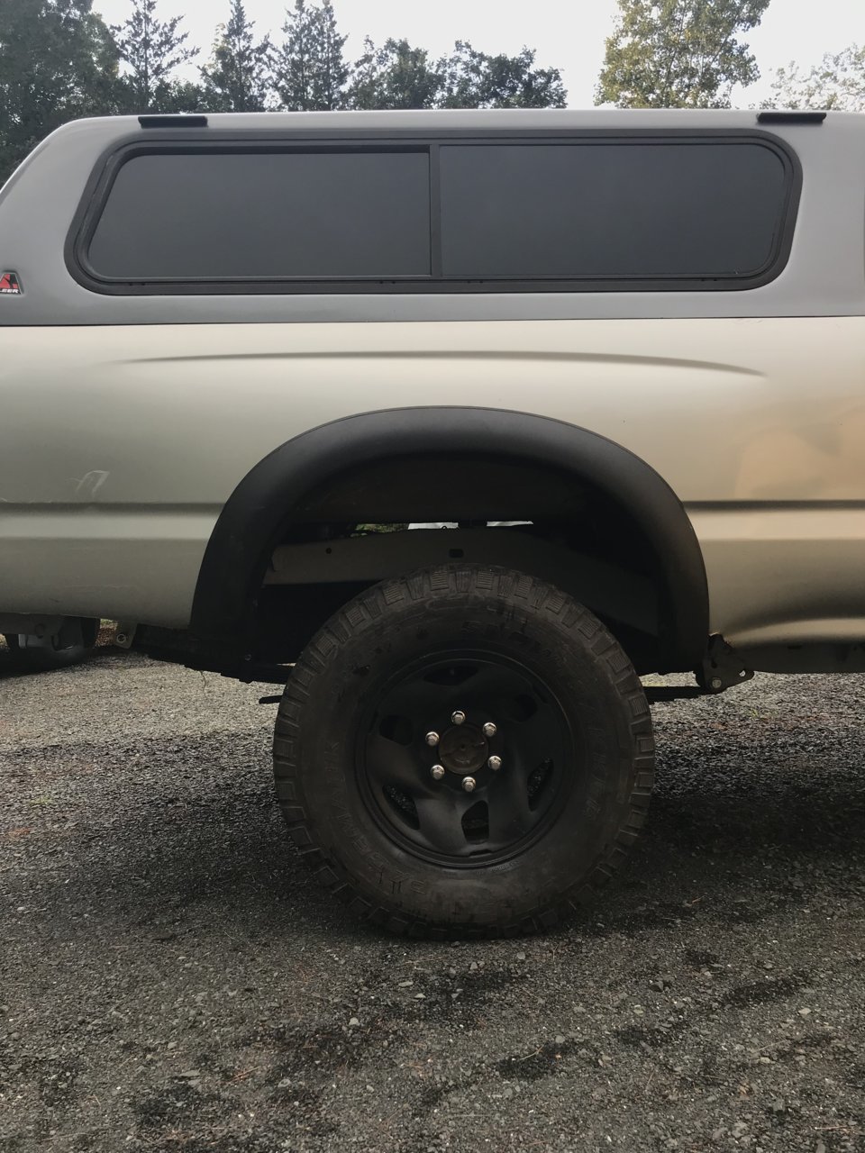

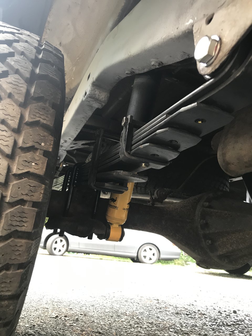

    Rear suspension done!

    more progress!, looks like you got a bigger bolt for the leafs
    did you by chance get any pics taken of the surface after the wire wheel/grinder and before the undercoat /primer was applied?
    were you able to get that O2 hookup fixed that got chewed up
    and just one newb ? ... that piece that the U bolts attach to on the axle, is that attached to the axle or is it a separate piece? ... not sure what it is called off hand

    Yep, Il post some more pics of the before and after. And I figured out the O2 connection!
    The plate is separate from the axle and held on by U bolts and shock.

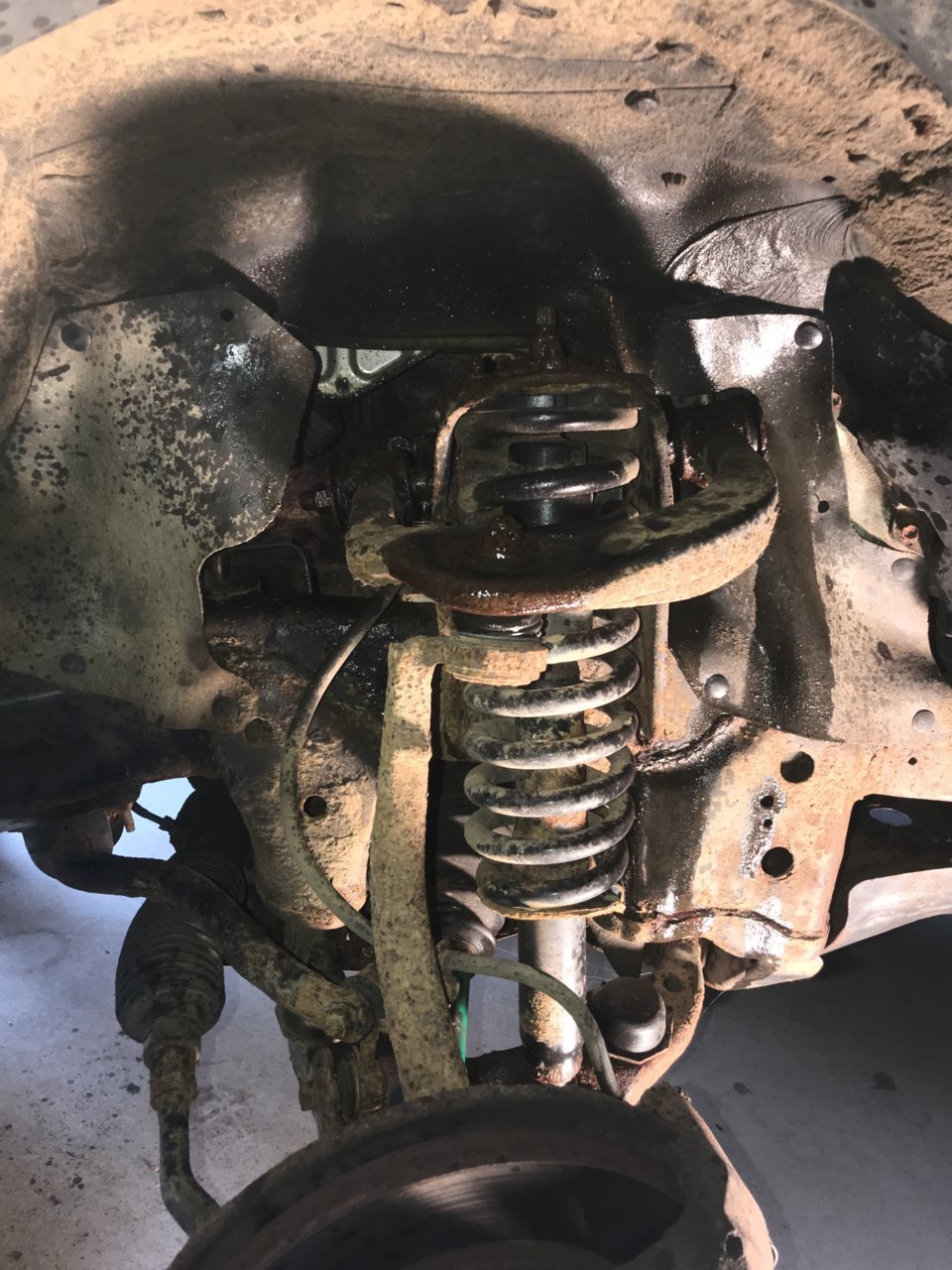

    6868B552-1714-4A9E-BB7D-DCB4A9648A6E.jpg Ran into this issue while removing my UCA bolt on the passenger side. The bolt is blocked with inches to go... I don’t want to cut it and get a new one. It’s one of the only bolts that wasn’t seized...

    Yikes
    Seized nuts...
    Finally got it out and new one in
