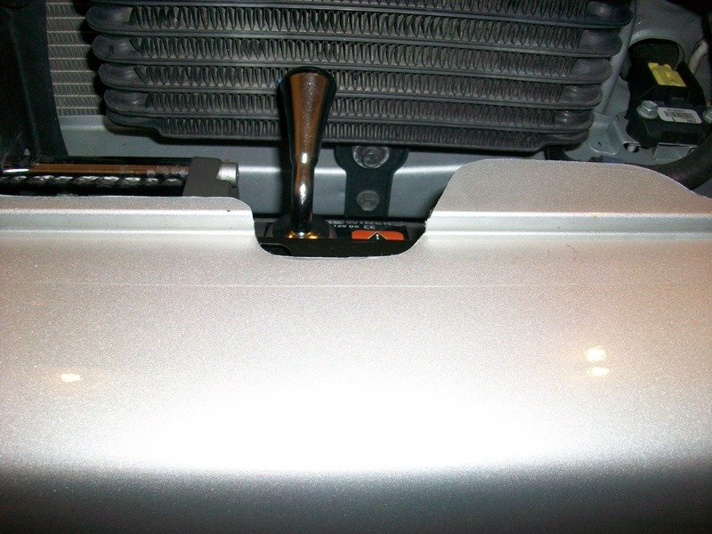

    Do you by any chance have a pic of how much you had to cut off of the back of the bumper? I'm about to measure (with template) and start cutting.

    Sorry just seeing this.. I didn't take a photo of the actual bumper after trimming, but hopefully this will give you an idea of how much to trim (there was approx 1.4" to the front edge of the black insert just before the silver plastic of the bumper transition):

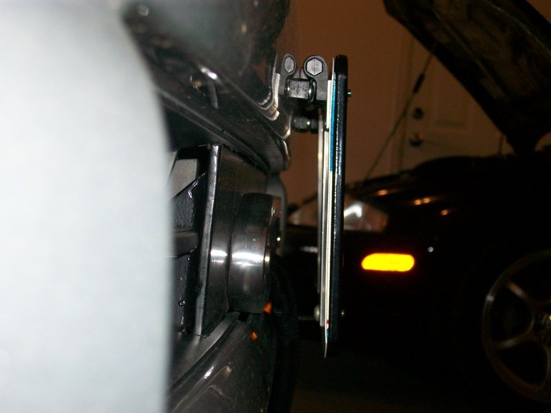

    And another where I trimmed for the winch handle if you use the HFT Badlands winch like I did:
    Hope that helps a little..
