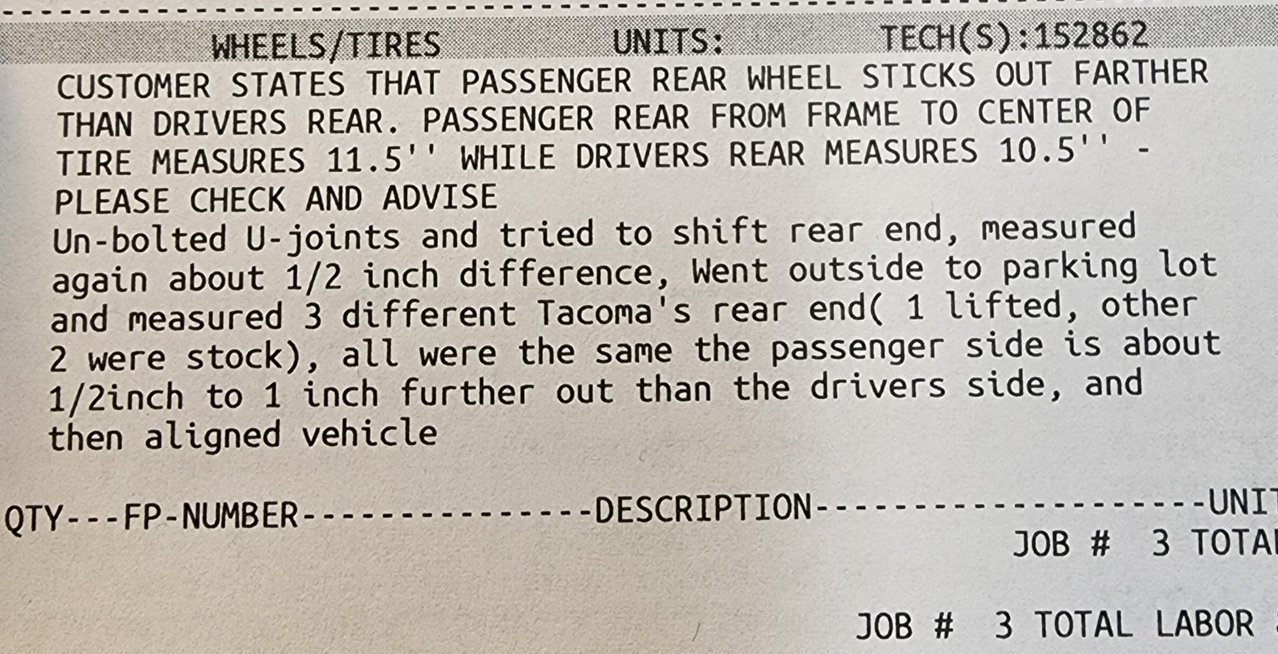

    Here is the dealer report for my truck. Sorry. Been busy and didn't have time to update what the dealer said. I still need to measure to see if they actually shifter anything over.

    Thanks for getting back to me @Coma4by , I asked my buddy with a ‘22 TRD Or MT and his has the same offset. I’m thinking it’s gotta be part of the design. Either way doesn’t seem like it’s problematic. Now I just need to figure out if I want to install a 1” wheel spacer on the one wheel with less “poke”. Currently they all have .75” spacers installed.
