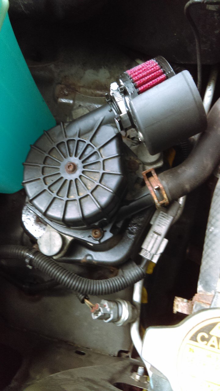

    I have a 4 Banger & my air pump doesn't have the plastic over cap. The pump is also located up near the back of the grill /headlight area. I was a little worried about rain water getting sprayed onto the UNI filter ,so I made a splash guard out of a spray paint cap . won't hurt but it might help.a UNI.jpg
