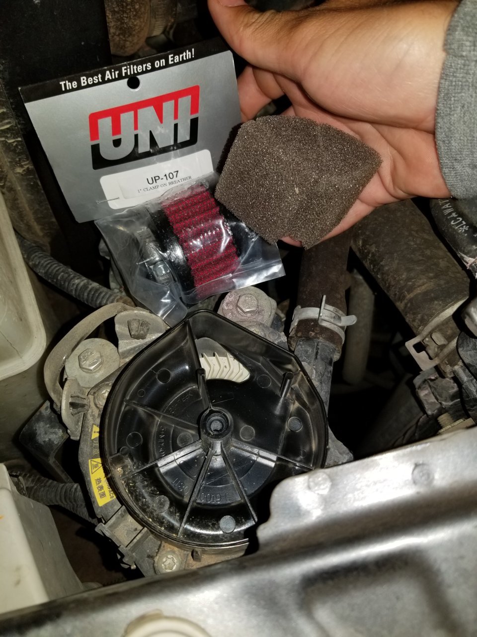

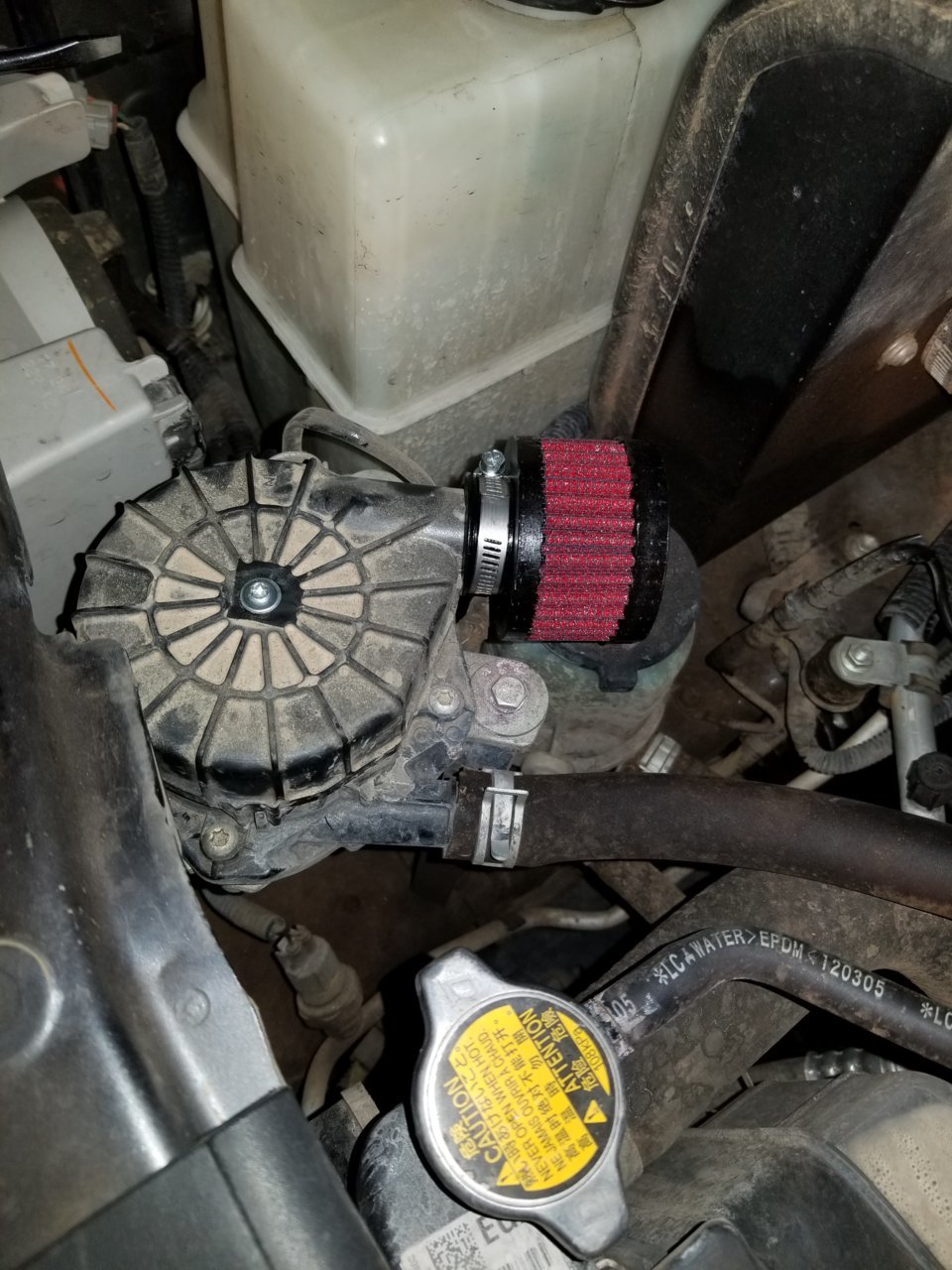

    Oahu, Hawaii
    2013 Gray Tacoma TRD
    K&N cold air, Exhaust, rims and tires, 3" king extended travel coilovers and total chaos UCAs, rear diff breather mod, CBI off-road ditch brackets with Cali raised LED pod lights and painless wiring harness, 4xinnovations rock sliders, cab mount chop.
    Super fast mod. I probably spent 5min doing it. That includes me walking from the truck to the garage to get the tools to do it. Looks cool. My foam filter was perfect still but better piece of mind.
    Out with the old and in with the new
    Honestly hardest part of the mod for me was getting the damn top cover off. Assholes wedged it in behind the front passenger light. (2013 4.0L)
  4. Sep 15, 2018 at 11:51 PM
    #84
    bagleboy
    bagleboy Well-Known Member
    Aug 5, 2017
    #226018
    7,264
    Scott
    Norcal, Santa Rosa
    2014 5-lug AC 2.7L VVTI
    Snug top Rebel, Thule tracks, ditch tracks, Bagged rear suspension, F/R anytime camera, intermittent wiper switch...
    So, why not just replace the stock filter every 3-4 years?

    Hey guys I just did the uni-filter mod and had a question.
    Most of the guides to this mod imply that there is a snap-on housing cover that is annoying to detach. Most of the guides are also for the V6 motor's.
    Looking under the hood on my 2012 2.7L I didn't see a cover, just the top of the whole assembly with the lone T25 screw in the center.
    Is there supposed to be a cover for our 2.7L trucks? Will the cover from a V6 fit? The cover looks like it does a good job protecting the uni-filter from taking on spray/moisture.

    Not if its supposed to but I just did my Uni mod on my 09 2.7 and it did not have a cover.
