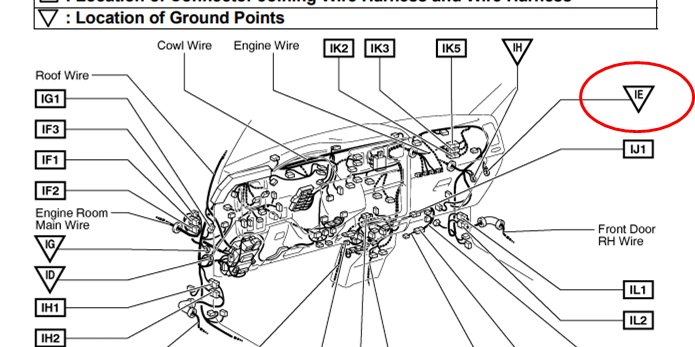

    without taking pictures of the wiring diagram and uploading them to validate my thoughts the ONLY thing these things have in common is the ground point IE which is located the right of the glove box on the inside of the support member. It has White-black wires, how many, the manual does not state.

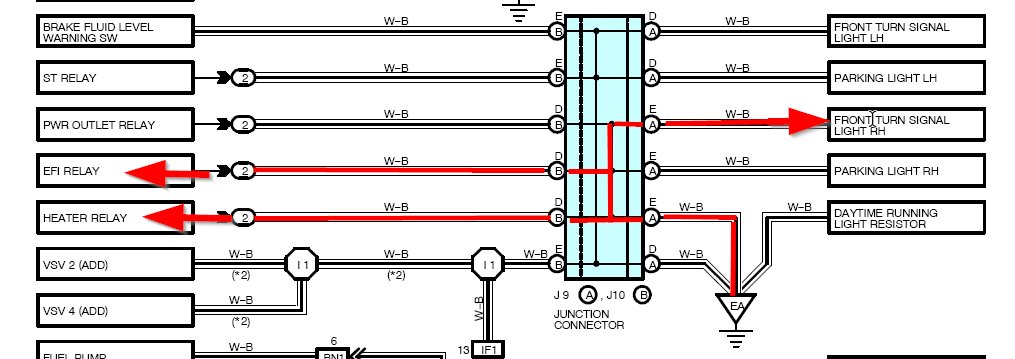

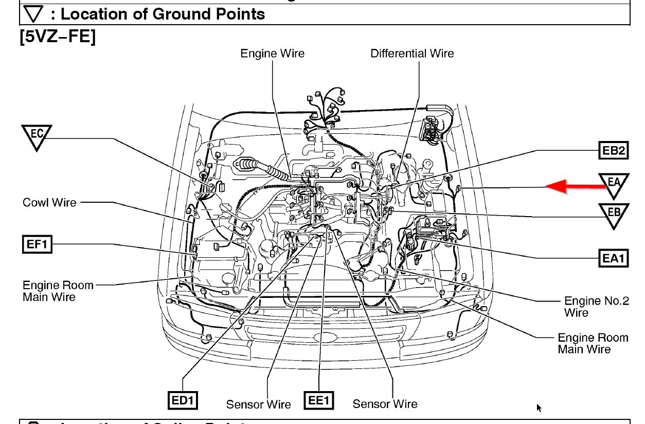

    If grounding is suspected here the common for possible grounding issue: blower relay and front turn signal use the same ground as EFI relay. Bad grounding would make EFI relay to cycle and then the engine is affected.
    Ground point EA is on Front Left Fender,

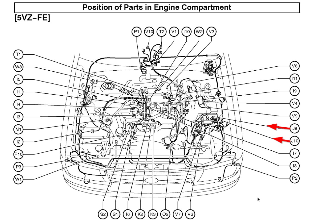

    Junction connector J9(A) J10(B) is near by:
    Just some things to check

    According to that diagram, so does the LH front signal

    LH front signal uses different connection in junction and different ground wire (same ground point tho).

    You guys are rad. Thank you. It was the EA ground. Two wires share the same ground, one had severed. Crimped a section to the broken one to extend it and grounded it a different bolt in the engine compartment. Problem solved!

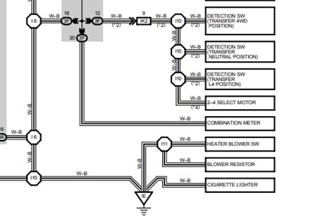

    In case the possible solution RysiuM gave (1st choice) doesn't resolve it, there is also a common grnd point between the blower resistor and the combi meter("IE"). It is near listed as right end of the reinforce, meaning the bar that hold the instrument panel (dash) in place.
