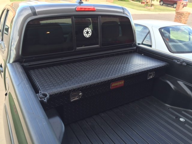

    I have been looking for a bed storage solution for some time now. I have a roll up tonneau cover, and wanted something that would fit in the bed under the cover, and provide some measure of security (lockable). I looked at several heavy duty plastic possibilities, but nothing was quite right. I happened to check out a company in Michigan that makes high quality stuff out of aluminum, and found something I thought might work. I looked at their spec sheet for "regular" over the side bed tool boxes and found something interesting......
    Well -- I just received my new aluminum, locking bed tool box today. It fits better that I could have hoped. It is from Owens Products in Michigan (owensproducts.com), and is actually made for a step-side Ford Ranger - but fits perfectly under my tonneau cover and between my wheel wells!!
    They come in bright or power coated black like mine. Mind you they are not cheap, but this is a very high quality tool box. I plan to secure it in the bed using the supplied "J" hooks to the tie down loops on the side.

    There are two holes in the bottom - I suspect for drainage. The owner drills holes for installing the "J" hooks. Normally they go down and under the side rail on the truck. I will be going to the side to hook to the tie down.

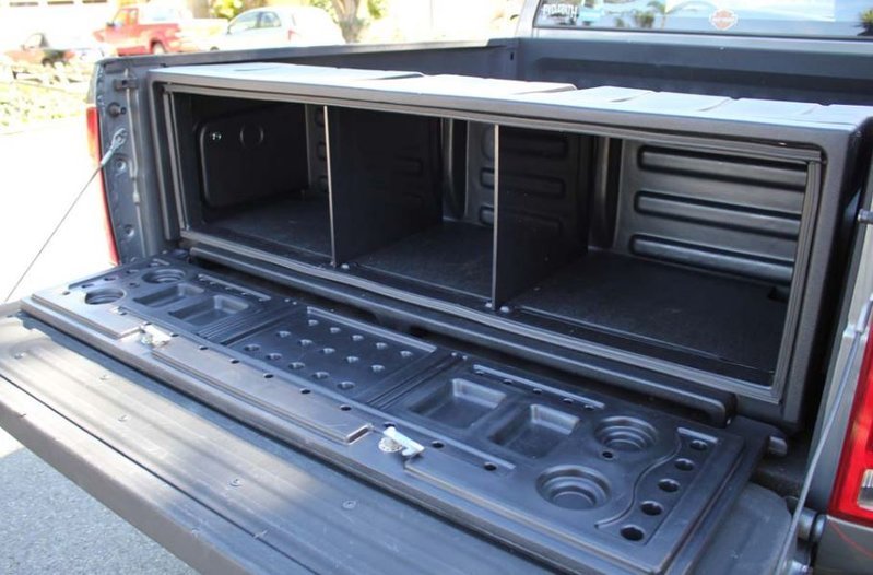

    Anyone know of anything comparable that might be available for Tacomas? It's an AeroBox http://www.ecoological.com/aerobox.html, however they do not make them for Tacomas and do not have plans to do so. Trying to find some sort of secure storage solution without using a tonneau or a shell. Would love a bed vault, but can't swallow the prices they go for.

    Mine arrived today! It didn't come with the J hooks, so I was thinking of picking up some U bolts to secure it. Can you post a pic of your final

    I did not use the J-hook myself either. I went to Tractor Supply and got U - bolts. I drilled two holes in each side for the U- bolts and simply installed them finger tight.
    I'll try to get a couple pics tomorrow and post them up.

    By the way - I love mine and it works perfectly. I can easily install or remove the tool box in a couple of minutes by myself using the U-bolts through the side tie downs.
