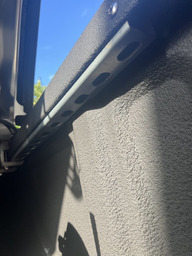

    Yes I did. I used to re-enforce the bed rails before I put my hard cover on. Had to trim some of unistrut backside to fit the bed side wallsupload_2025-4-3_18-2-30.jpg

    Thanks for responding! How did you attach to under the rail?

    It fit pretty tight. I drilled and put bolts through the inside lip of the bed into the unistrut. I did not bolt through the top because I put a hard cover on.
