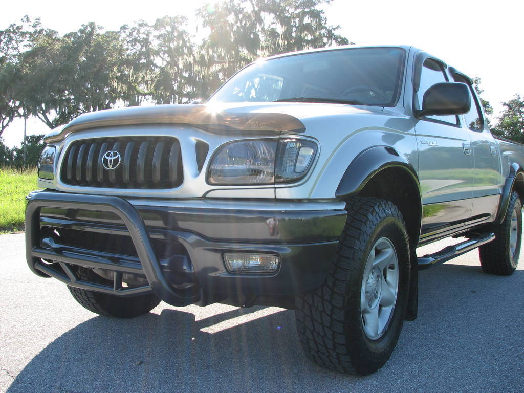

    Paint typicall does not stick well to plastic. When I had my valance painted the guy used a special plastic primer (adhesion promotor) first after sanding it.

    No, it is regular automotive paint (base coat and clear coat) on top of the primer/adhesion promotor. I used a Toyota color, Magnetic Gray Metallic. The pictures are a little dark and looks black, but it is dark gray.
