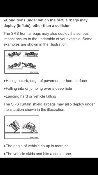

    Side airbags tend to be more sensitive because they have about 1/3 the time to deploy as frontal airbags, due to the greatly reduced crush space. The fact Toyota put a button there means there's an "overlap" in the forces experienced while offroading vs. the responsiveness required for the airbag system to meet federal crash requirements.
    Do you have a lift installed? A lift is known to screw with the truck's accelerometers resulting in VSC errors. Perhaps they can affect the rollover sensing logic as well. :notsure:

    Struggle as you may, I don't think any manufacturer is going to cover this type of incident as that is what they are designed to do. You may have caused the deployment as your butt dynomometer is not an accurate measurement instrument.

    You can exceed the limits of the Yaw Sensor / rollover programming without actually having a collision or rollover. That is the part you need to understand.
