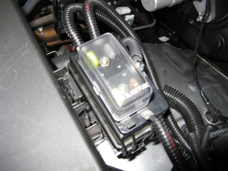

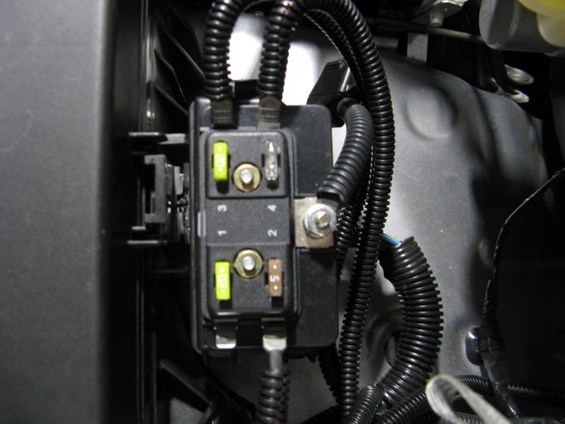

    Sourced fuse block from Amazom. Ran a fused 12ga wire from batt post located under the fuse / power distribution box on the left, to the battery post on the fuse block. You can then source fused 12v power from the fuse block. I have driving lights, underhood lighting and aux hella fogs wired to my fuse block w/ one open power spade left. Could easily be located under the dash.
    [​IMG] [​IMG]
