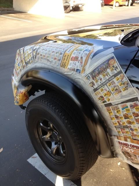

  18. May 22, 2015 at 9:21 AM
    #18
    Styx586
    Styx586 Well-Known Member
    Apr 13, 2011
    #54822
    2,085
    Terrance
    Lake Elsinore, Ca
    2013 Tacoma DCLB TRD Sport, 2001 Tacoma TRD Off-Road
    23D2AA9C-0720-4CBB-A9FC-9A09415A7333-698_5d946a442f20a25e695832e40156872a585967a2.jpg
    I didn't get any overspray... :notsure: Though It took FOREVER to mask off all 4 flares. If I ever do it again I'll probably take them off and have them bedlined.

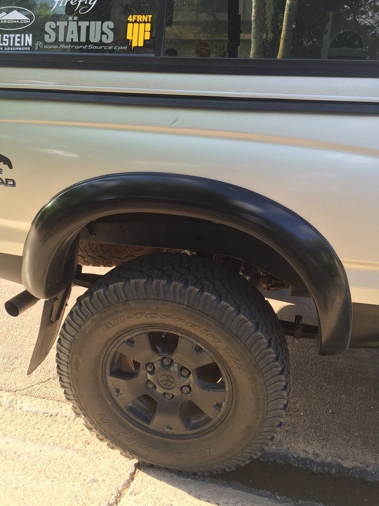

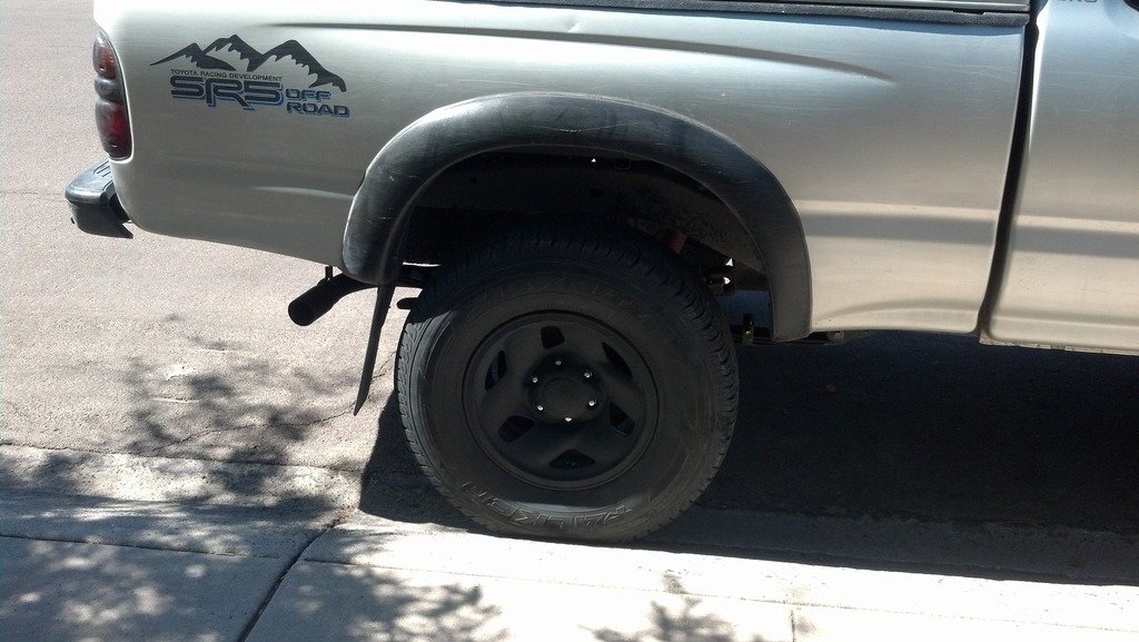

    I would just paint them if you want it to last more than a month or so. I took mine off, sanded, primed, painted, and clear coated. Its been about 8 months and they look like I painted them yesterday. Before that I used plastidip but that didn't last more than a few weeks before tearing.
    Before:
    After:

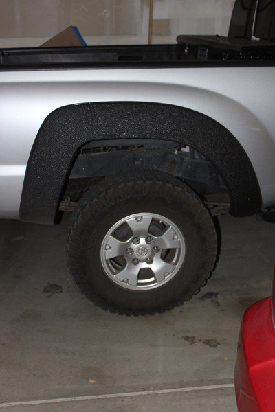

    if u want them to REALLY last, and be damn near bulletproof, take them off and have them lined with a bedliner like full metal jacket
