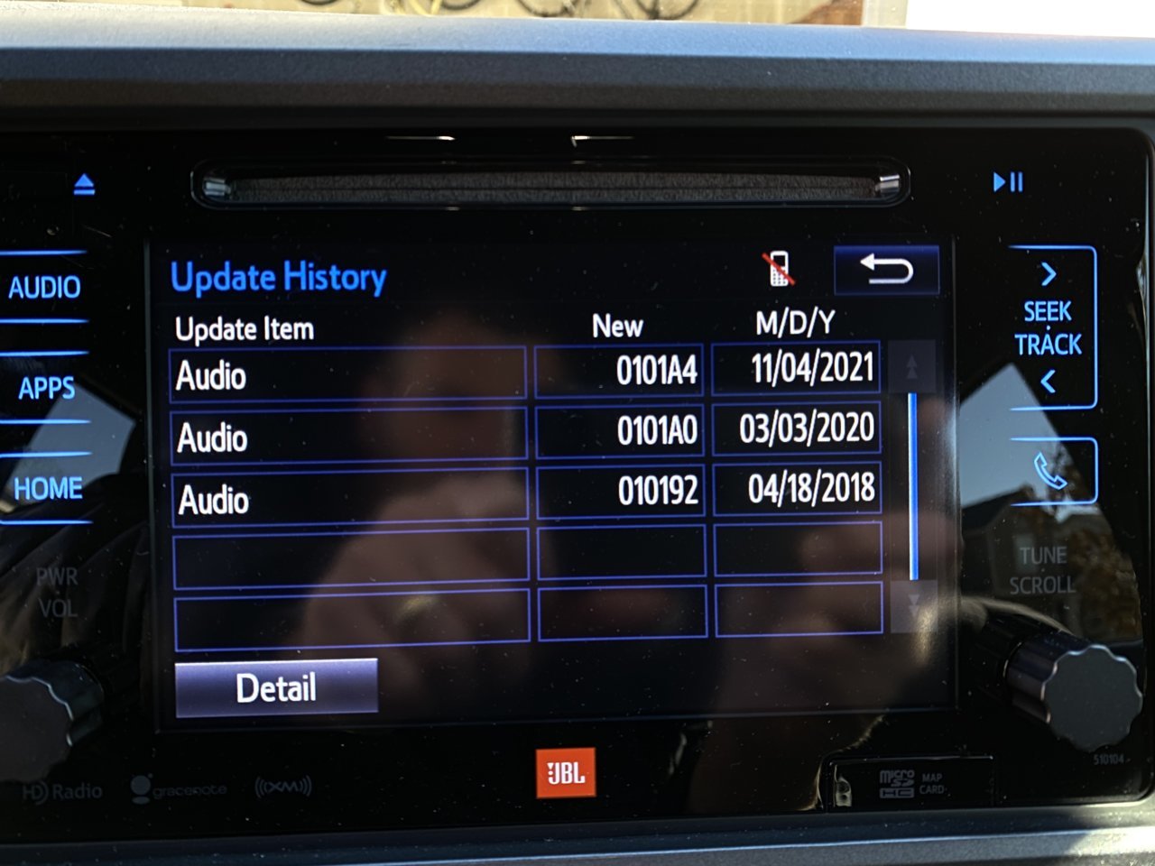

    Ok, I just tested it out with a 32 GB FAT32 formatted thumb drive and had no issues. I think your issue is that you're tapping on "Check for Update" when all you need to do is wait a few seconds.
    1. Start truck
    2. Press [Menu] button
    3. Select "Setup"
    4. Scroll down to and select "Software Update"
    5. Ensure your current versions are below the following:
      • Audio: <1784
      • Navigation: <1109
    6. If so, insert thumb drive into USB slot below headunit
    7. Wait a few seconds and you will see a popup saying "New software was found" for about a second and the "Check for Update" option will turn into an "Update Software" button
    8. Select the "Update Software" button
    9. Follow prompts
    10. Profit

  14. Nov 4, 2021 at 3:11 PM
    #194
    ryanvar42
    ryanvar42 Well-Known Member
    Feb 9, 2021
    #355569
    2,924
    2024 Silverado Trailboss
    None
    Why tf isn't this done over the air. Have to use a damn thumb drive
    Skydvrr likes this.
  15. Nov 4, 2021 at 3:18 PM
    #195
    ktbell444
    ktbell444 [OP] One who throws exceptions
    Aug 8, 2017
    #226306
    2,969
    ᚺᛖᛚᚺᛖᛁᛗ
