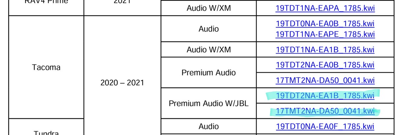

    You're missing a file...

    ummm, I actually downloaded from toyota.com from audio updates but it was only 1 file! When im trying to download from link in pdf I cant do that

    First post. There's a link to all the 3rd gen headunit update files in my drive. It's 1 zip file with almost 4 GB of data, so get ready to be waiting if you have crap internet connection.

    All right! Software updated! That was it! :bananadance:
