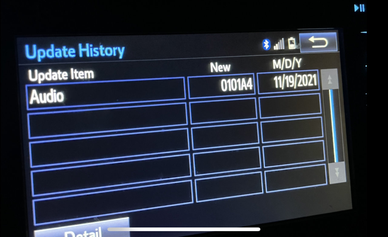

  6. Nov 18, 2021 at 10:56 AM
    #226
    iceage1001
    iceage1001 New Member
    Aug 14, 2020
    #337629
    iceman
    SF Bay Area
    highlander

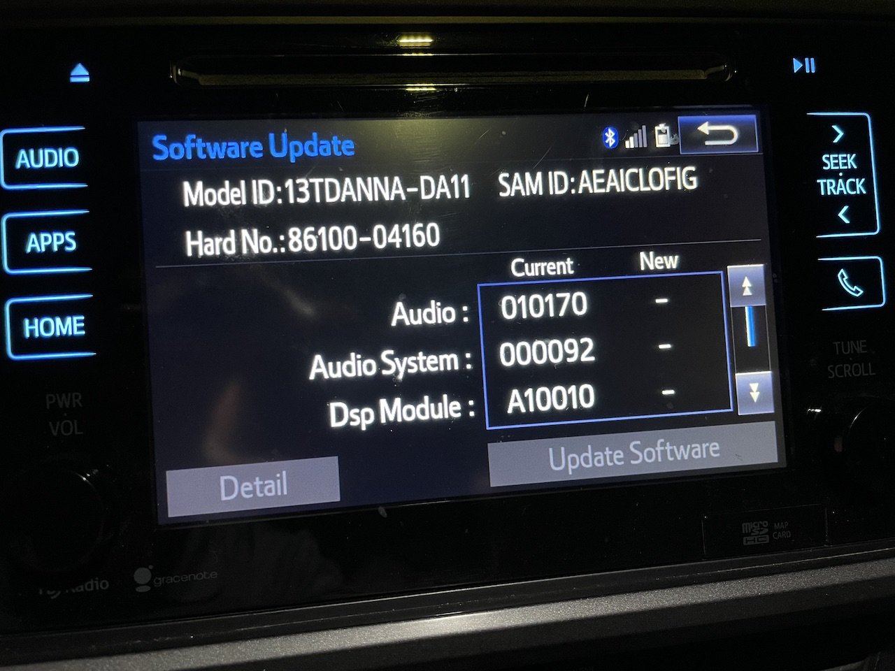

    Thanks KTBELL444
    I was having bluetooth issues on my highlander 2018-2019 where the phone would disconnect from the radio and message displayed call ended while the call would stay on the phone.
    i was looking for update files everywhere for .160.kwi and finally someone mentioned your link.
    I have updated 13TDANNA-DA11_0164.kwi which is newer and the update went smoothly, am yet to test it but finger crossed.
    thank you soo much for posting it.
    ktbell444[OP] likes this.

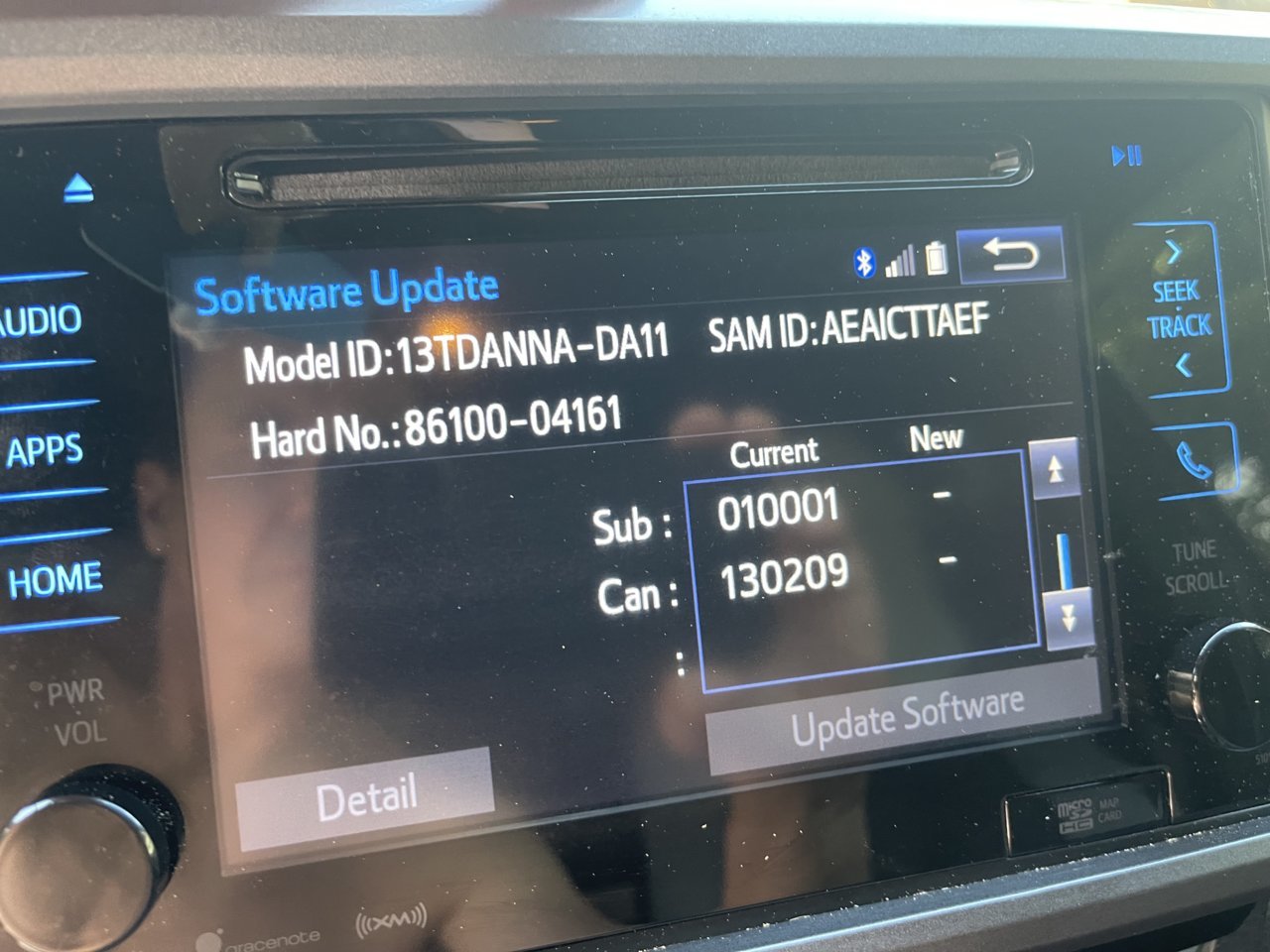

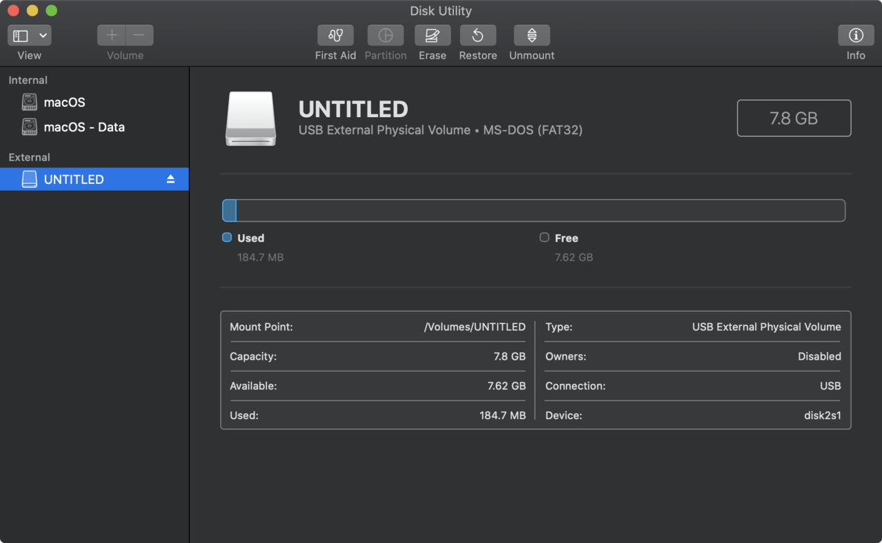

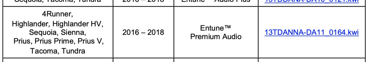

    Would the two file thing apply to a 2016 w/Premium Entune?
    Per the PDF, here's my head unit's stamp on the bottom right:
    Matches Premium Audio. TRD Sport.
    This is all that is on the flash drive:
    Formatted FAT32. It's 8GB and USB 2.0 only.
    And this is my updates screen.
    I think it's updated a time or two but not for several years, and it's an October 2015 build. Usually has no issue but had it glitch out a few times in the last month or so.
    I'd love something with CarPlay but just can't justify the price when I already have a perfectly fine phone mount that's been in here for 6 years. And it's all hooked up to the OEM Audio + system so I'd rather not mess with it. Figured why not try an update, what's the harm right?
    EDIT: Ignore me. I copied the file to my Windows 7 Virtual Machine. Formatted the flash drive from Windows Explorer again as FAT32. Copied the file back. And boom, it’s recognized. Good ol Windows.
    Disk Utility must do something just slightly different.

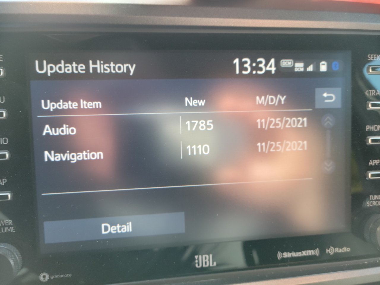

  12. Nov 25, 2021 at 1:51 PM
    #232
    abrams2112
    abrams2112 Active Member
    Mar 1, 2021
    #357869
    39
    John
    Mid-East Alabama
    2021 Cement Tacoma TRD Sport 4x4 w/XP Package
    TRD lift kit
    I always thought there was no update by checking OTA. I followed the directions here (toyota link), put my VIN in, and it stated to download 3 files. Put them on a FAT32 USB 16GB, and the system recognized the files right away. Install took like 6-7 minutes. No issues at all...thanks! I see the interface is different for the menu (changed from round to square), but it didn't fix a minor issue I've had since new (1 March) and have not researched a fix. I mainly use USB music. Mostly Hi-Res FLAC and I have some CD quality .mp3 in there too. The album art only shows when the truck is in Park. Put it in Drive and the album art goes away and shows the plain USB symbol. Not a big deal, but wish this update would have fixed that. Otherwise, all seems good so far. Happy Thanksgiving!

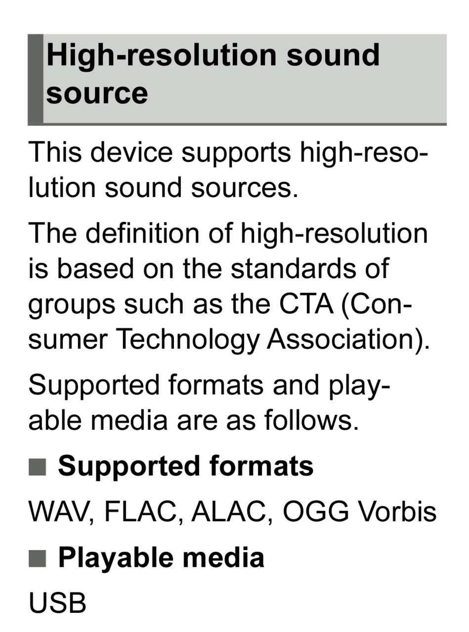

  14. Nov 25, 2021 at 4:25 PM
    #234
    abrams2112
    Mar 1, 2021
    #357869
    39
    John
    Mid-East Alabama
    TRD lift kit
    Yep! Always risk with software updates. Like updating a PC's BIOS. If it ain't broke, don't fix it. I was hoping the album art would show while in drive (only complaint), but not fixed. I'll research it someday as my issue could be so many things. Maybe because I'm using mostly FLAC files. I too only use USB music. No subscriptions needed, no talk, no commercials, etc. Just music.
    BOMBS and DES2009[QUOTED] like this.
  15. Nov 25, 2021 at 6:29 PM
    #235
    Saturnine
    Saturnine YVAN EHT NIOJ
    Jun 25, 2020
    #332540
    4,373
    Dar C
    North of the wall
    TRD go brrrr
    All the mods
    2021 reads FLAC?
  16. Nov 25, 2021 at 6:37 PM
    #236
    ktbell444
    ktbell444 [OP] One who throws exceptions
    Aug 8, 2017
    #226306
    2,969
    ᚺᛖᛚᚺᛖᛁᛗ

  17. Nov 25, 2021 at 7:21 PM
    #237
    abrams2112
    Mar 1, 2021
    #357869
    39
    John
    Mid-East Alabama
    TRD lift kit
    Yep...as OP posted. Hi-Res FLAC work great. Not sure when Toyota started that with the Tacoma since this is my first one (prior F-150 owner...POS).
  18. Nov 25, 2021 at 7:40 PM
    #238
    Saturnine
    Jun 25, 2020
    #332540
    4,373
    Dar C
    North of the wall
    TRD go brrrr
    All the mods
    Neat. I had to convert my entire collection to mp3 for my 2017
  19. Nov 25, 2021 at 8:48 PM
    #239
    abrams2112
    Mar 1, 2021
    #357869
    39
    John
    Mid-East Alabama
    TRD lift kit
    There is a bit rate limit on the FLAC files that can be played by the HU. I have some albums in 32 bit rate FLAC, and the Tacoma HU cannot play those. When I set up my USB back in March, I recall only putting on 16 and 24 bit rate FLAC files. The HU plays them fine. Just no album art when shifted into drive. Not sure I'd convert just for the HU to display album art. That would take days if not weeks for something like 20GBs of music. Perhaps a future firmware update will resolve it. Now I know how to really check for it thanks to all in this thread. If your HU shows album art all the time with USB music, I'd think it best to not update if there's no current issues for the features you use in the system.
    BOMBS and ktbell444[OP] like this.

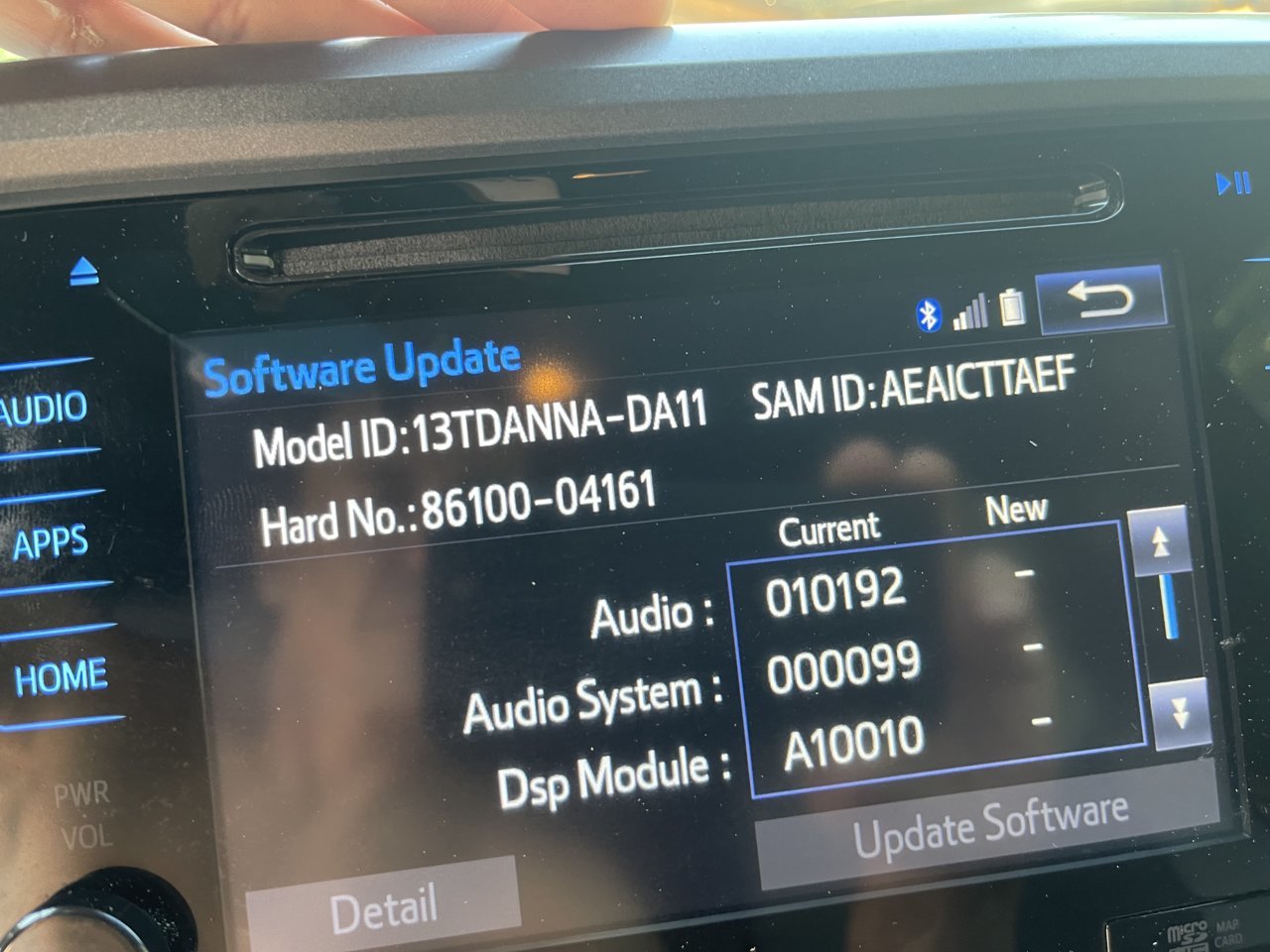

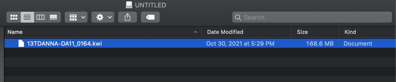

  20. Nov 25, 2021 at 9:06 PM
    #240
    jarpil

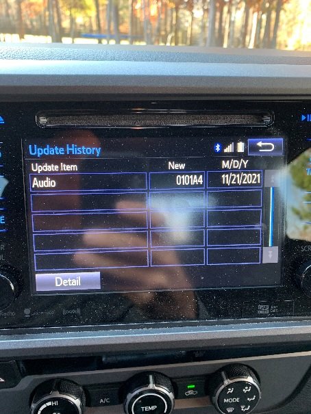

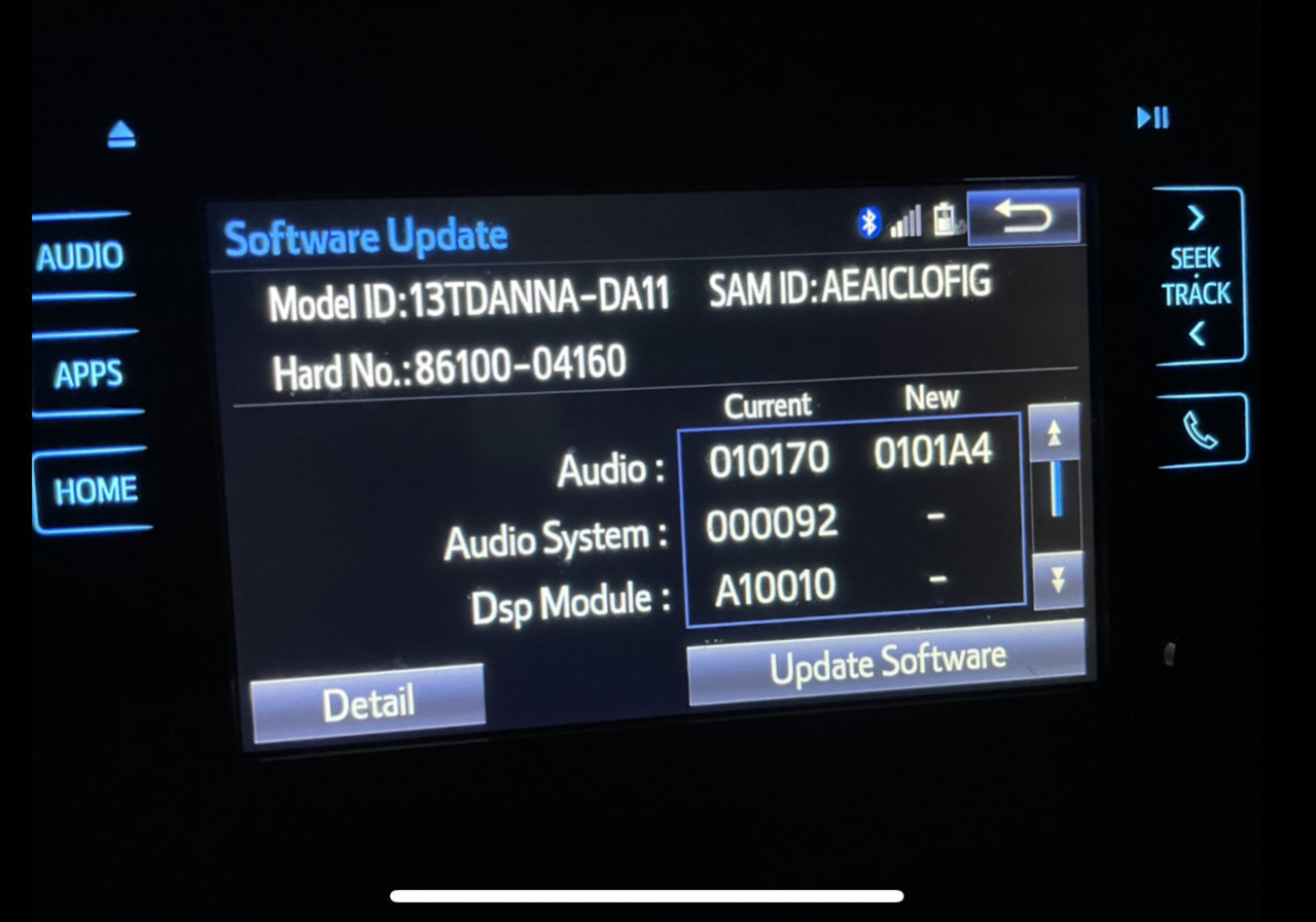

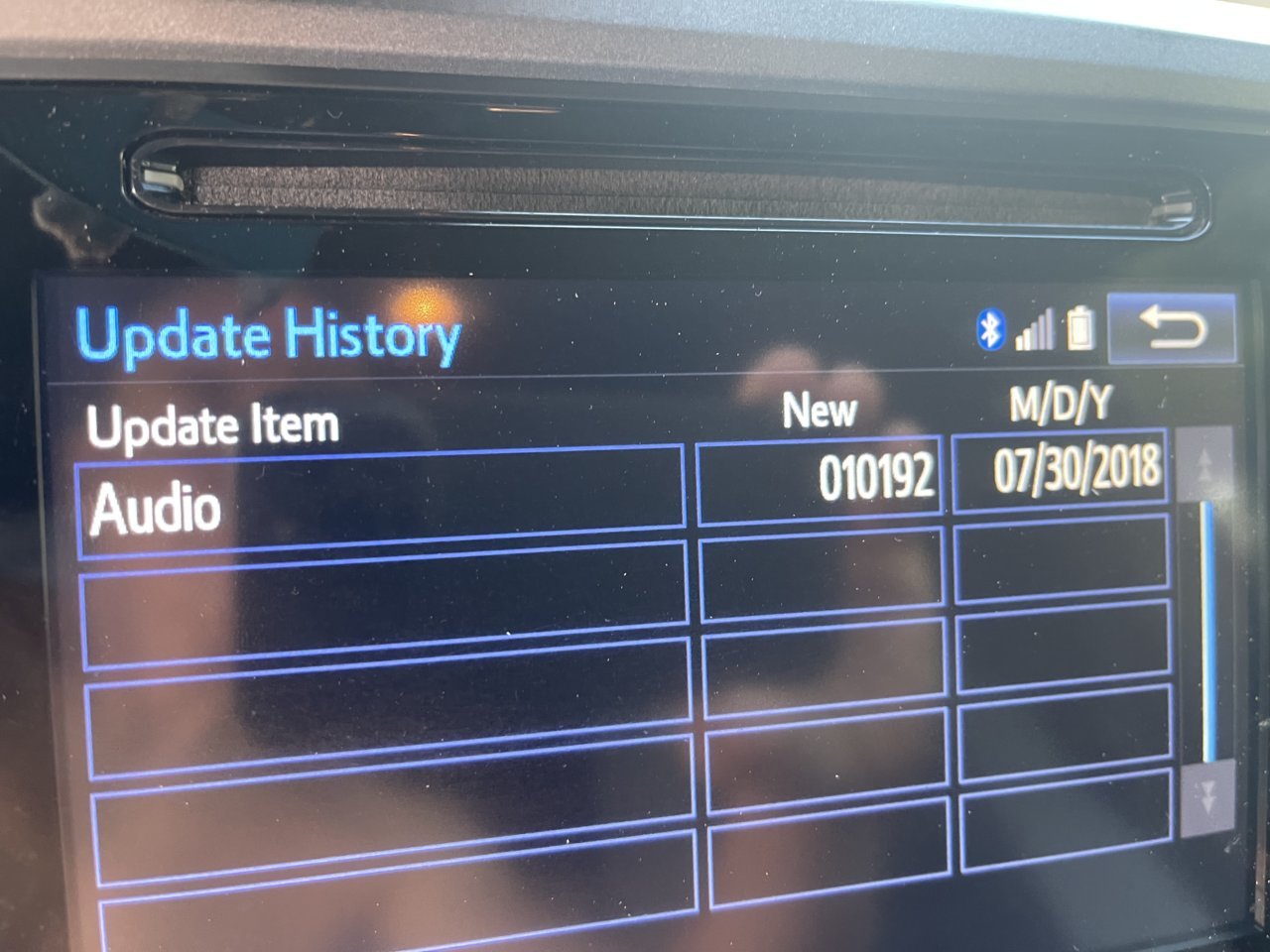

    jarpil Well-Known Member
    Mar 7, 2011
    #52512
    364
    Kalaheo, HI
    2017 Tacoma TRD OR DCSB, black
    Spent all day with this and no luck. Mine is 2017 TRD OR DC. USB stick is Kingston 32gb formatted in fat32. My current version is 010192 and tried to update to 0101A4. The HU will not recognize the file. Frustrated! Tried with NAV microsd card in and out with same results. IMG_0880.jpg IMG_0881.jpg IMG_0882.jpg
