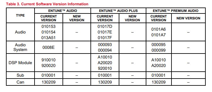

    So I had to look. Sure enough... I just put the factory head unit back in a few minutes ago.
    Soooo DA21. So T-SB-0045-22 doesn't list DA21_0166 under Tacoma.
    But then on T-SB-0003-20 it does list DA21_0165 under Tacomas.
    Looked up the head units for the other vehicles listed. Does look like the same head unit with functions. Possibly just without out the JBL integration. Wonder if it is the same head unit that just sends out the audio signal to the JBL amp and the amp does all the JBL stuff. Been looking for ways to upgrade the sound system without chopping and removing too much crap.
    I guess this chart is one way to check it:
    So the chart on T-SB-0045-22 would probably say 0166 is safe.
    I guess I could try the update from @ktbell444's original post then try out @r81984's updated files and see if it auto selects it.
    Since the 19 is listed there and the result shows it should be fiiiiine....
    Maybe they added the JBL Premium stuff at the port or dealership before it left the plant?
    Then there is always that coding slip up where they coded the wrong stereo into their database. There was a case of that before for something, which I don't remember what it was. But it was something small and stupid. Did you by chance try the 0166 update?

    Update for 19 with JBL Premium. Model number ending in 04173. Took the DA21_0166 update.
    Updated to 0101A6.
