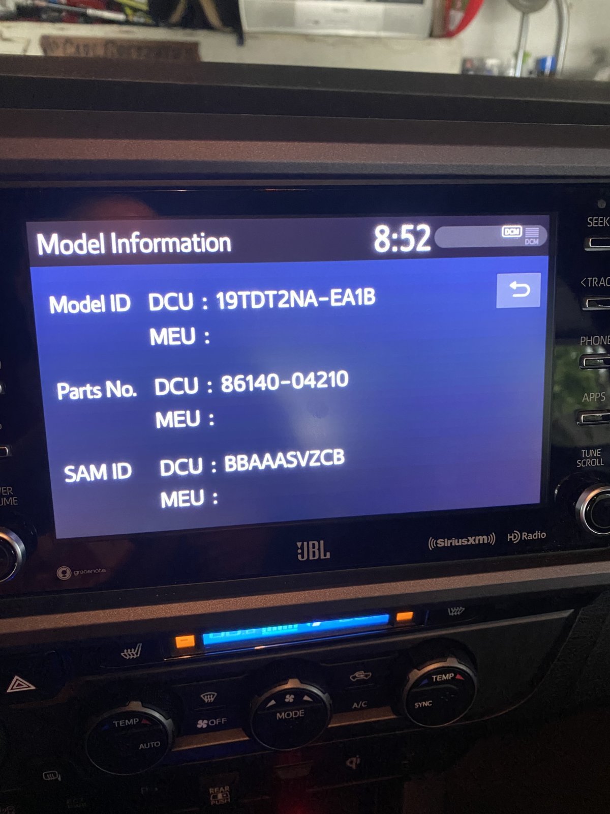

    Has anyone with an SD cardless version tried buying one of these sd card map packs and transferring them onto a thumb drive and uploading them that way? Unless I just don’t know where the sd slot is. I’ve had this truck for a week so I still don’t know where anything is. My head unit reboots itself over and over for about a minute every time I start it up. Unhooking the battery seems to have made it worse and now I can’t adjust my clock which is conveniently stuck at —:—

    Confirming you have an Entune 3.0 with a separate NAV module then it would only be accessible in the back. What’s your HU look like?

    Pic is from before I unhooked the battery and somehow deleted clock adjustability and the dcm logo is gone now too. Dcm signal strength hasn’t had a single bar on it since I got it.

    No separate NAV box on this model

    Just like @TacoSupremo19 said…no built in NAV module. This one is a subscription NAV only via bloat apps by Toyota.

    Gotcha. That’s fine as I just use my phone anyway. Was just hoping for another avenue to take in my quest to fix my reboot issue.
