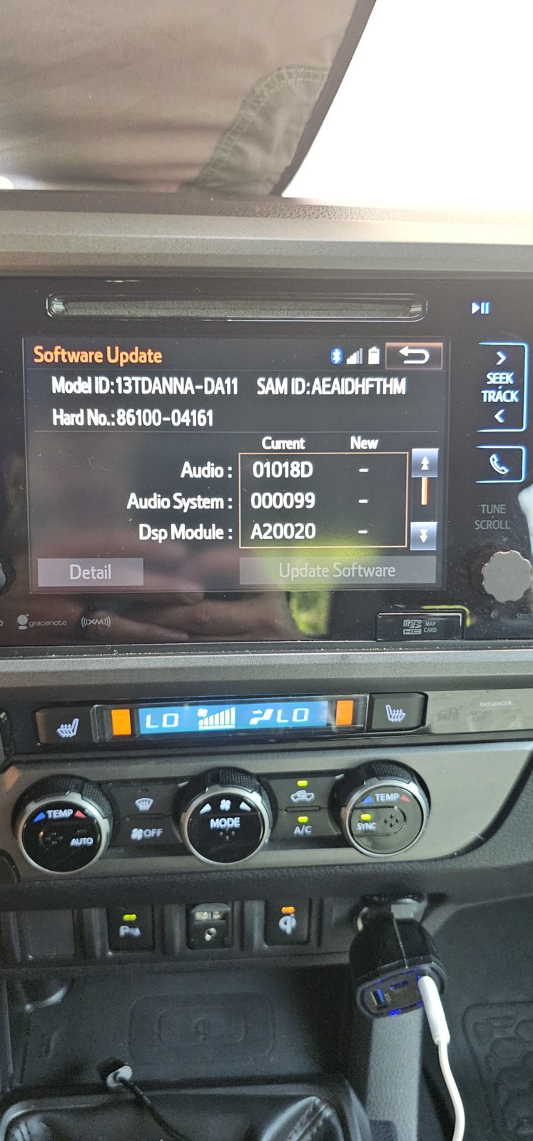

    9
    20240812_150232.jpg This is what it says for software update and I'm sorry for my stupidity but I can't seem to figure out of it is updated I know my maps version is dated 2017. But is this the latest software.

    Brushed Copper Blaze 10 Rims | 265 70 17 Toyo Open Country A/T III tires | Bilstein 5100 w/ Eibach Coils 2.5" lift | Blackhawk UCAs | ICON Rear 3 AAL |TRD Skid Plate | TRD CAI | OEM Rear Bed Lighting | OEM rear Tailgate lock | RC Bed Molle Racks | Custom Blacked out OEM LED Headlights | MESO V4 Mirror Turnsignals | MESO Interior trim blackout | TG DMM dash mount | TRD Shift Knob | OEM SR5 interior door handles | Upgraded Stereo including Alpine 700W Amp Alpine Type R Components & Hertz speakers 12" Sub | Custom Clazzio Seat covers | Mobtown Sliders | Front Camera
    the numbers are hexadecimal the version showing on Toyota is an updated version from 1018D to 10192 by 4 versions

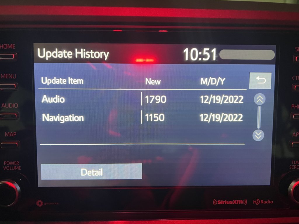

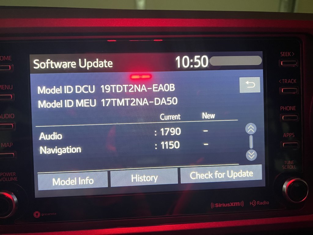

    2019 Tacoma TRD Off-Road DCSB
    If you check and matched your Model ID number from here:https://www.toyota.com/firmware-updates/download
    Yes,, the latest software is 1790 for 2020-2022. There’s no updates for 2023.
    I also have a 2019.
    AUDIO software with/without NAV 20-23 are all the same. The NAV module has separate software updates. Here’s my 2020 with NAV module:
