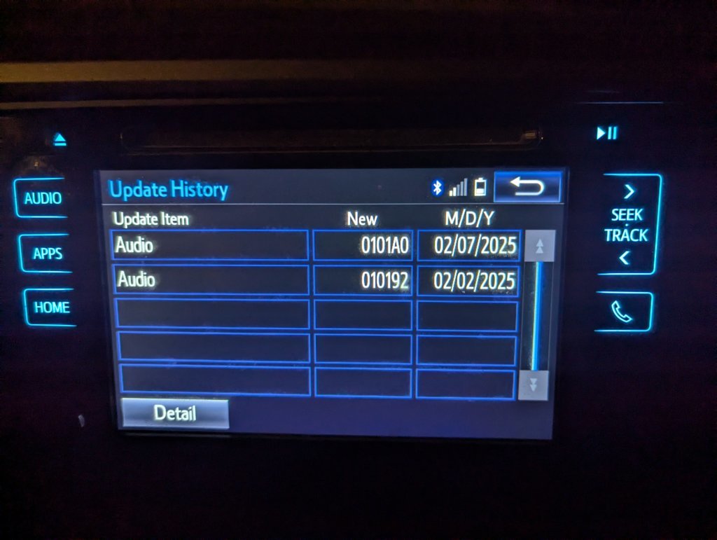

    February of this year I bought an updated Nav map card. I also updated my head unit firmware for the first time since new. New map card and new head unit firmware has been working well for me since February.
    I have Entune Premium no JBL.
    SandyTaco4x4 and Canadian Caber like this.

    I put my VIN in to this site which back in February which stated I had one newer update I could install.
    https://www.toyota.com/firmware-updates#
    Just checked my VIN again today and it says no new updates so it must know I grabbed the newer file in February.
