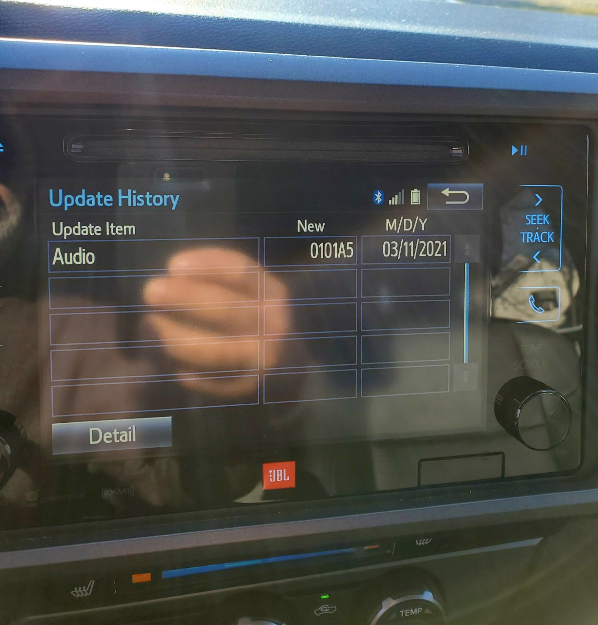

  10. Mar 11, 2021 at 10:47 AM
    #150
    Freelancer
    Freelancer Member
    Jan 5, 2021
    #351808
    12
    2019 Cavalry Blue TRD Sport
    I updated the software today with no issues, went from 01019A to 0101A5. Thank you for this thread, tons of value from this group :101010:

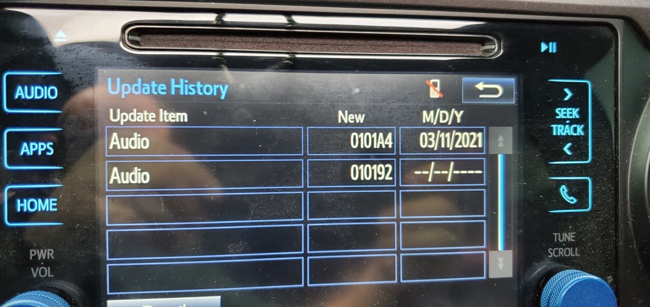

  14. Mar 12, 2021 at 9:11 PM
    #154
    mrkabc
    mrkabc Mall Crawler with a Locker
    Jun 9, 2014
    #131627
    1,642
    Art
    Corona, CA
    2017 MGM DCSB TRD OR
    Morimoto XB LED Head & Fog Lights, Cali Raised Stealth Light bar, OEM Roof Rack, Homelink Compass Mirror, Power Tailgate Lock, LED bed lights, MESO mirrors, gashole, switch panel & Stage 2 tails, PRO grille. Where's the mall?
    You got A5? I see that I and a few others got A4. Is there a change to the update file in post #1?
  15. Mar 12, 2021 at 9:17 PM
    #155
    ktbell444
    ktbell444 [OP] One who throws exceptions
    Aug 8, 2017
    #226306
    2,969
    ᚺᛖᛚᚺᛖᛁᛗ
    Both are the same update, per the T-SB.
    Not sure why there are two separate versions for Entune Premium Audio, and the others.
    And no, I have not updated the first post.
    mrkabc[QUOTED] likes this.

  17. Mar 13, 2021 at 5:37 AM
    #157
    Freelancer
    Freelancer Member
    Jan 5, 2021
    #351808
    12
    Yup here's what the screen read.
