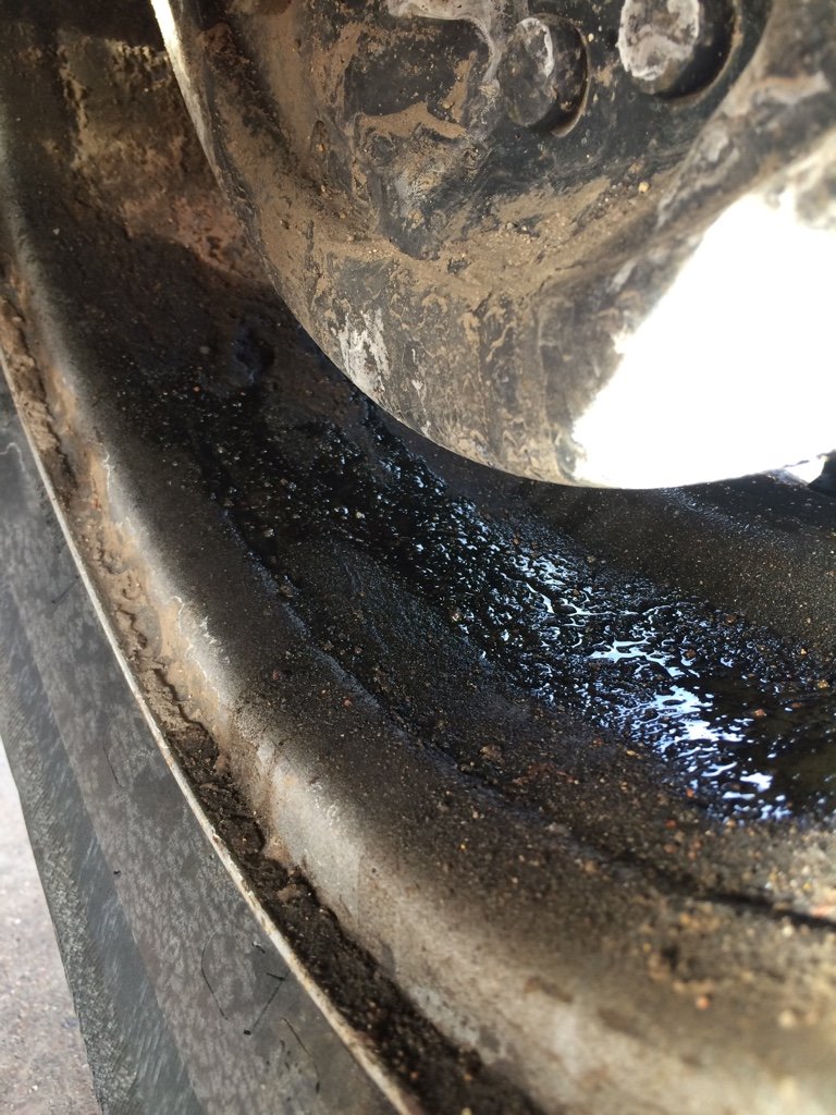

    [Update]

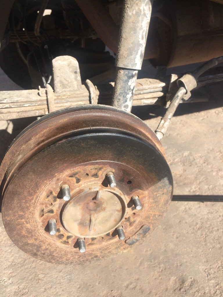

    Can confirm diff oil. I did the sniff test and finger test on both. I cleaned the area off and am going to see if it comes back in the morning.
    Here's a picture of the drum. The darker area is where it was leaking.
    [Original]

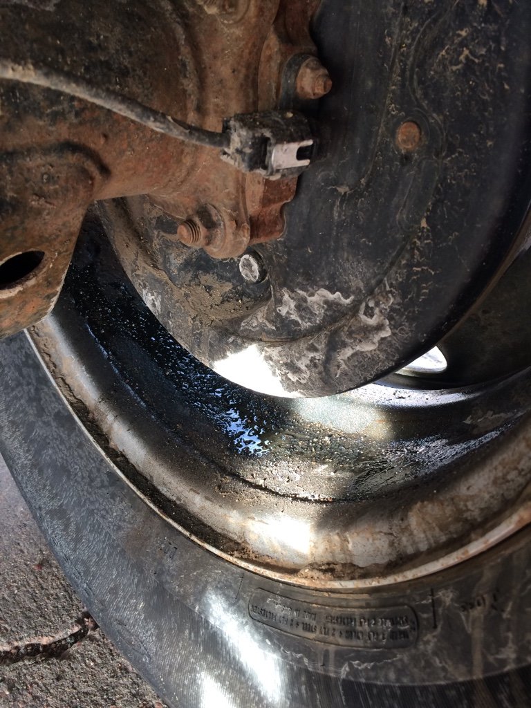

    I was checking my tire pressure today and smelt something funny around the passenger rear tire. Looked at the inside of the wheel and saw this puddle of liquid. It was a greenish yellow color and smelt. The only other wet spot around was on the bottom of the drum.

    Could be wheel cylinder, could be axle seal, best pull the drum off and see where its originating from, The smell says gear oil to me

    Looks like the master cylinder is leaking and that is brake fluid....... check the break fluid reservoir.

    I bet your axle seal is leaking and you're loosing gear oil. I'd go a step further to guess your wheel bearing is failing causing the damage to the seal...

    You can just get that fluid on your fingers and tell if its Brake Fluid or Gear Oil.

    The burntish smell says diff oil, take the cap off the brake res., stick your finger in and smell, thin and not the lubebricity of diff oil, you'll feel difference when you rub the two between your fingers.
    Greenish yellow color says diff fluid, I say you have a bad seal on that side allowing diff fluid to leak out, doesn't mean that the bearing is bad but the seal is and the leaking in the drum has wrecked the brake shoes on that side, so they will have to be replaced along with the seal.

    pop the brake fluid reservoir and give it a sniff. get some on your finger. compare to what you found on the wheel. gear oil (used) is super pungent stuff. I threw a t-shirt into the rag pile yesterday because I couldn't get the stink out of it after doing diff oil change and making a bit of a mess.

    water would rinse that off cleanly
    diff oil/gear oil does not mix
    water would roll off that and leave it behind
    [also... diff oil smells like arse]
