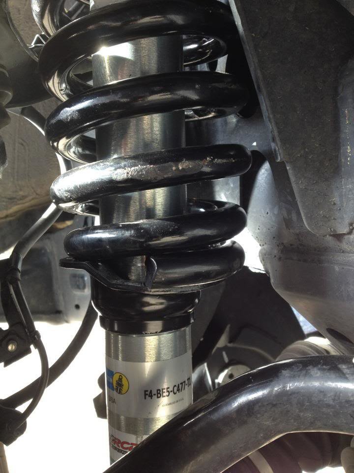

    4 notches total, the last notch would be .00, then .85 and so on, ending at 2.5 the more you move up the notches, the tighter the spring will be, increasing your lift you gain.

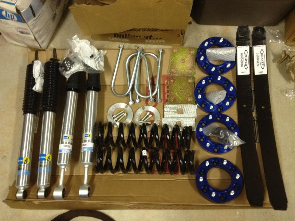

    As far as the spacer, I wouldn't go any more than the 1/4" spacer that I'm running now. I'm just kind of puzzled as to why I'm running the same lift that so many people have and I'm a solid 1" higher.
    What should my rear measurements be at? I'm currently sitting at 24" in the back to with my ToyTec/Deaver AAL.

    That's exactly what I thought! The spring perch that the spring rests on is sitting on the very last notch, so I'm getting ZERO inches of lift from the shocks. So what else could be wrong :annoyed:

    Spring perch upside down ?

    Nope!
    392265_10150471311005935_618265934_10699_702942db282aad0c43e17b75de58b7e32cc3fe0c.jpg
    It was at first ^^^ :eek: ... Talk about a horrible ride :eek:
    But I've since had that fixed, much better ride, except my measurements being F'd up :facepalm: :smack:

    Me and my buddy thought that too, but the box PLUS the little white tag it had on it said 885 :notsure:

    Me too, I mean I've listed everything that is installed on the truck and posted pictures. This just doesn't make any sense :help: :goingcrazy:

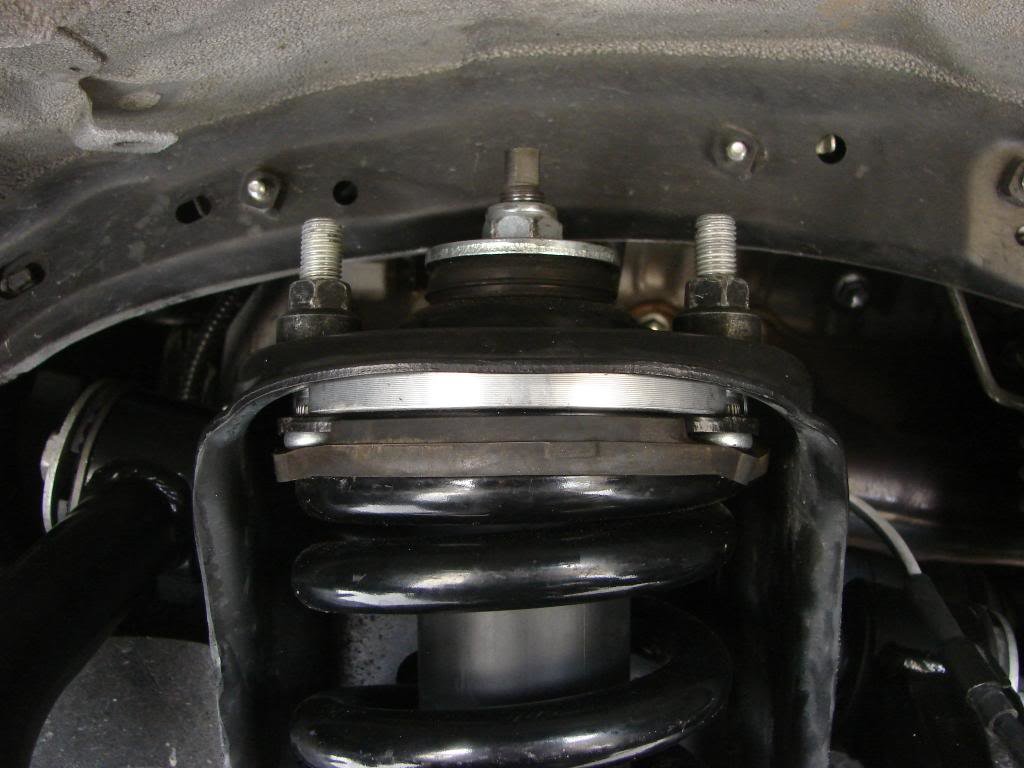

    392625_10150458593585935_618265934_10659_3312d5d6e46630641c3a04b1d8546fe15ad9d112.jpg
    The 1/4" top plate spacers from Toytec usually don't come with longer studs , are you sure you didn't get the 1/2" ones ?

    I bought the kit found here:
    It's the same part number as found in this 3" lift.

    This is the best picture I have showing the top plate spacer:

    Those aren't the 1/4" spacer , they are 10mm or 3/8" and provide 3/4" +/- of lift .
    So , theroretically you should have about 3 1/4" - 3 1/2" of lift from the 885's and that spacer combo

    Being as many 885's give 3" lift as is, combined with the spacers, hthat may well have put him near 4". I tell people to lift without them FIRST, then see if they need to be added later.
