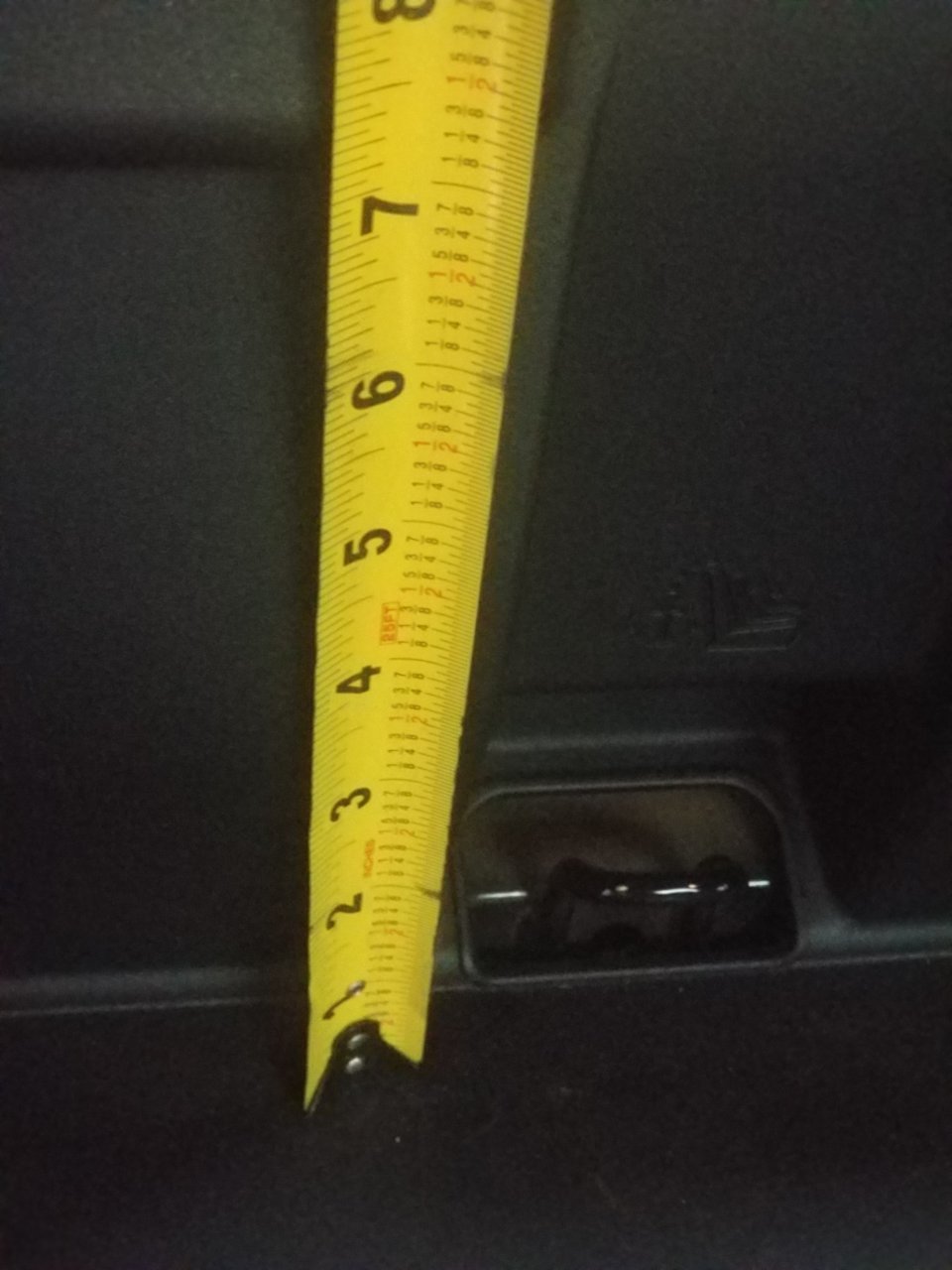

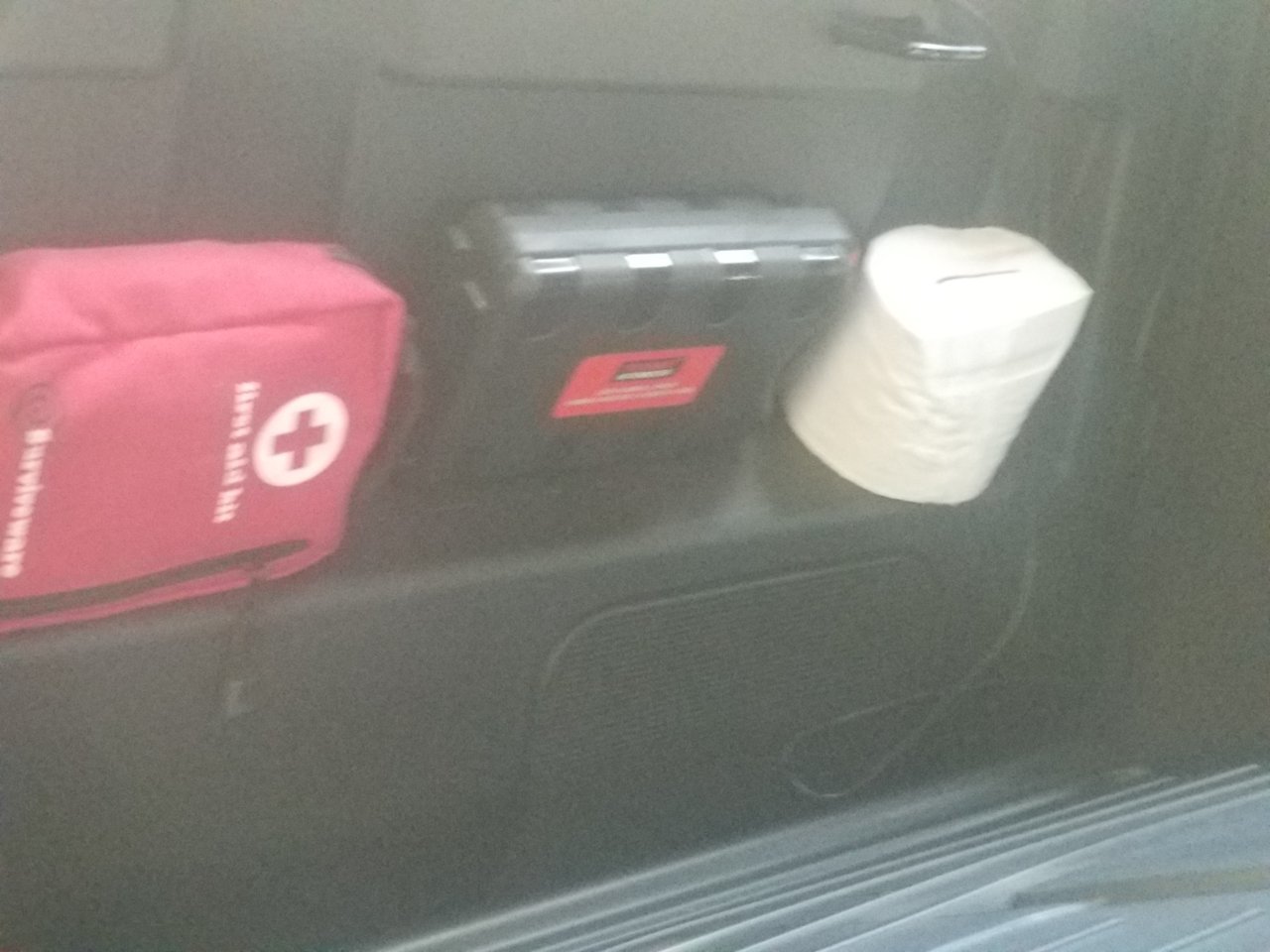

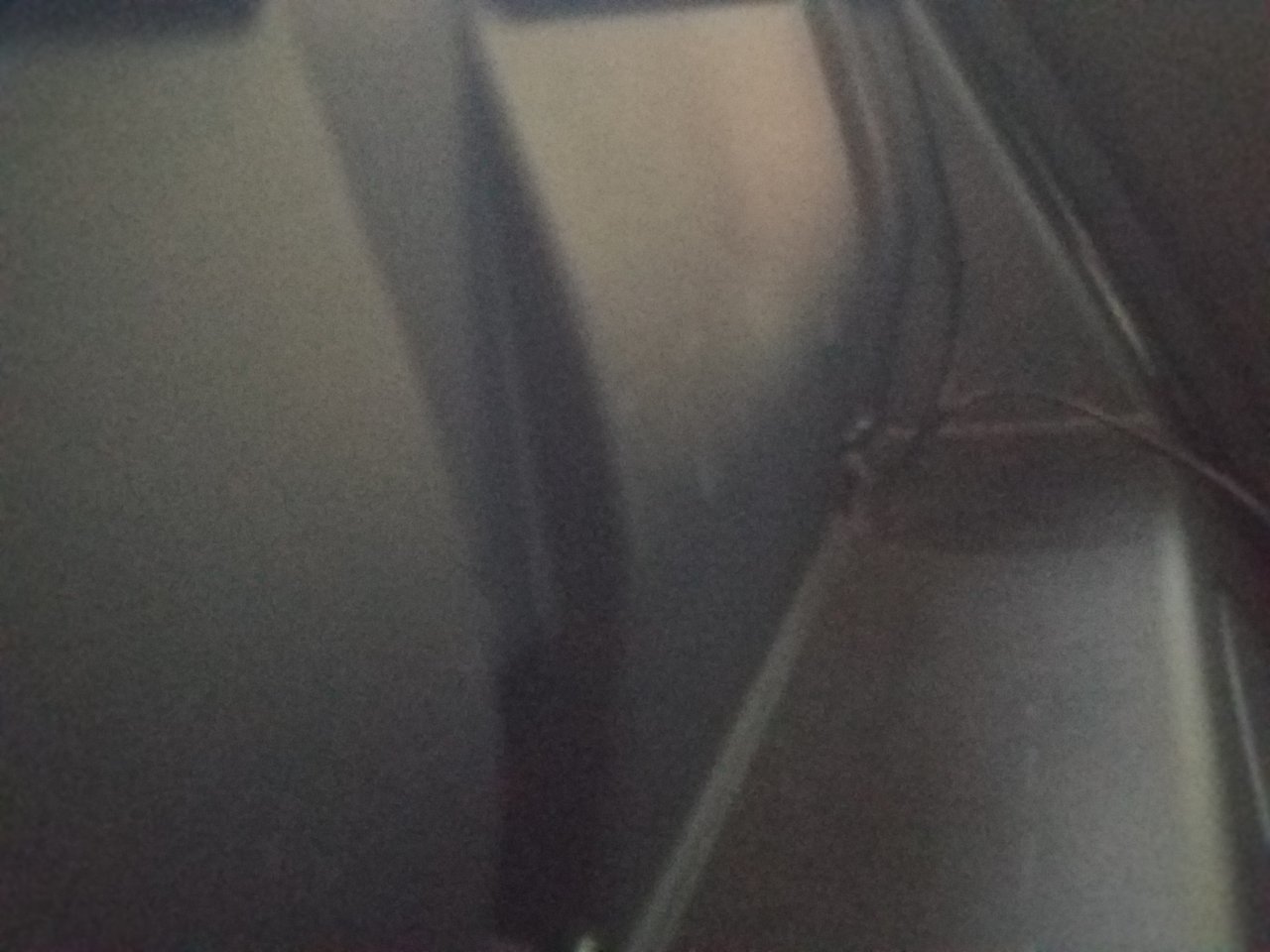

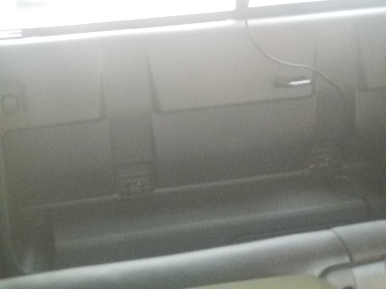

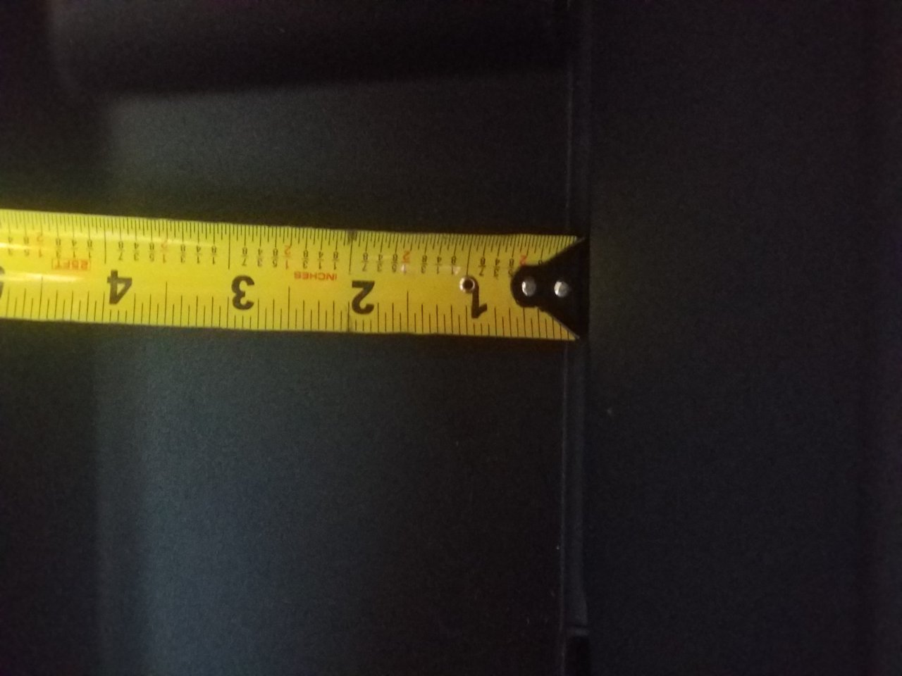

    Thanks!
    So space is kind of my problem, lol. I've got stuff behind the driver's seat and stuff under the rear seats. I just looked at the dimensions, I'm hoping there may be enough space just about the JBL stuff. I'd prefer to keep in as close as possible to the JBL amp since I have to tie into it with the harness. Running wires isn't my thing lol. I'm already freaked out about running a power and ground to the new amp. I have visions of a fiery mess lol!!!
    Here's what it looks like (sorry for the shitty photos, the glass on my phone's camera broke)
    Obviously length and width are enough. But height it's 7.5-ish" from the "shelf" bottom to the little bump out on top.
    20190924_121118.jpg 20190924_121313.jpg 20190924_121153.jpg 20190924_121036.jpg 20190924_121341.jpg
