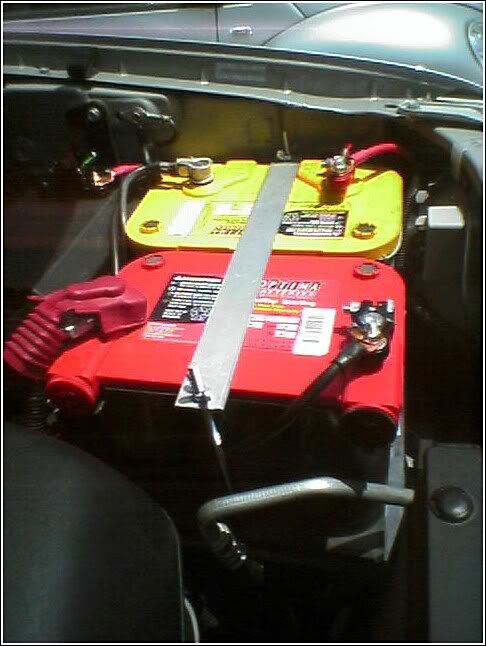

    Will do! I've seen a couple pics where one lady rotated the battery 90* and was able to fit 2 optimas that way. I forget if she she custom fabbed a tray or not... Lemme see if I can find her post on TS.

    Can't find her write up on TS, but it wasn't all that detailed anyway. I found her photobucket pics though so that might help. I was going to figure it out from them anyway since she didn't give much detail in the write up, and hasn't posted in almost 2 years.

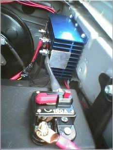

    Yeah, I know. It would take a lot to kill one of those Odysseys, but you still run the risk like you said. I think I may try this setup: If you don't have a login to TTORA let me know. I'm going to save the page and pics for later reference incase it disappears before I get around to doing it!

    Great write up! I wish I would have seen that before I wired my Fj Cruiser.
    My problem is we have the I-4 and it doesn't really seem to have the space for the second battery.
    The Tacoma V6 has pretty much the same engine layout as the FJ and the V6 4Runner.
    That link does help though. Thanks again!

    No problem! I stumbled across it in a tread on TN about a carputer. lol Go figure! I never thought about running one of those smaller Odysseys for accessories, but it sure would make locating it easier. And that fuse box kicks ass! No more inline fuse crap or 15 eye rings on the battery terminal! :laugh:
