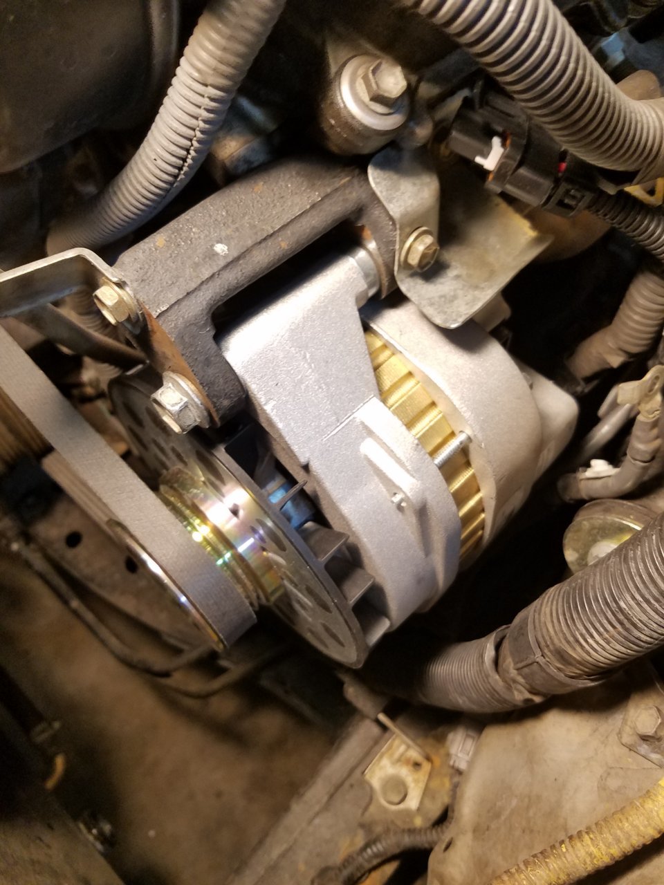

    It looks like people use the CS144 alternator for this. I have to wonder if an AD244 would work instead? It was a bolt-in operation for the upgrade on my 5.7 in my S10, which originally used a CS144. That gave me a 150-amp alternator for about $100. Had to change the plug of course.

    Yeah, that's what I was thinking.
    Oh well, at least I have a reason for having kept the old CS144 I took out of my S10! Now I can get it off the garage floor without tossing it out. Free upgrade for the win!

    With that much room, I have to say, I think an AD244 will fit. Will have to investigate this soon. I will let you guys know.

    Meant to add- I have to do an oil change soon, which will have me in that area. Will eyeball it and see if there is enough room. If I get crazy, might even wrestle the one off the S10 and see if I can swap it out No promises, though- I have been needing to replace the belts for about 6 months now, and that isn't done even though I have two new belts in the back doing me no good lying there.

    The Totota Power Steering belt fits the CS144 IIRC but its a bit snug. The Toyota alternator belt is a bit too small.

    That is easily addressable, just go up a few millimeters

    As I said, the power steering belt works (its what I use). Just to eliminate some of the guessing work.
