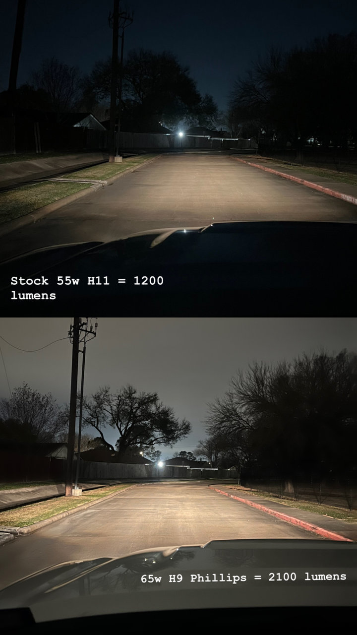

    OP if you don't have the funds yet for it. You can do the H9 bulb conversion for now. That’s the route I went (until I can purchase OEM LED’s)
    here are some pics for ya

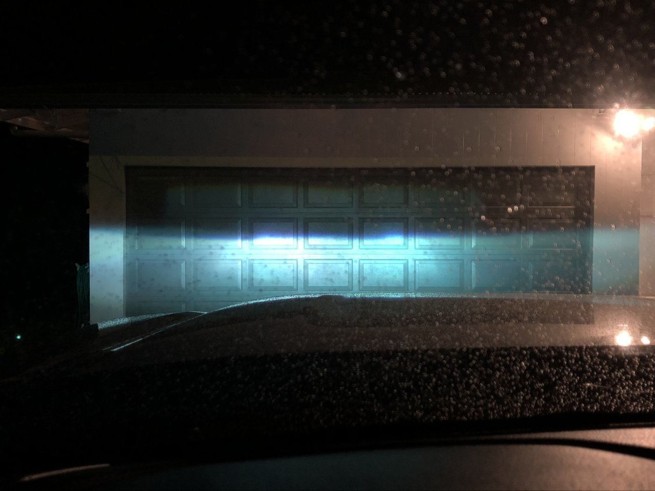

    Projector retrofit hands down. For the price to retro vs new assemblies, it can’t be best.

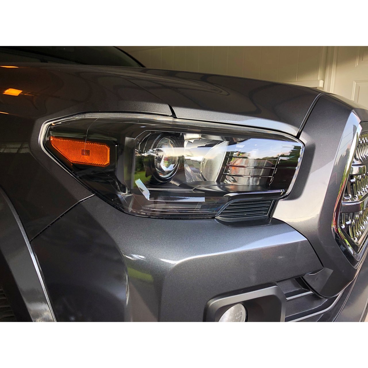

    PLUS - no one has ever posted pics of the aftermarket morimoto/2020+ cutoffs. They just post pictures of the headlights on and on the truck
    here’s some photos from my old phone. The stock pic just had aftermarket shitty bulbs

    I’ll believe it when I see it. No one has posted them up, not even morimoto.
    to what looks good is subjective. expensive? yes totally agree lol
    I’ll gladly put up my retros over stock (for my year), for a 1/3 of the price of morimotos or 2020+
    and you do realize the top photo is stock 2017 lights right?
    Bottom is the retro, that’s not even shown against a wall
    Edit: found Meso’s post
    https://www.tacomaworld.com/threads/morimoto-led-xb-headlight-review.602544/
    I’ll still keep my Rx350s.

    Unfortunately a sharp cutoff alone means nothing. It says nothing about the distribution of light in the foreground or where the hot spot is, and of course, neither of these photos show that either. The factory 2020 LED's have a rather soft cutoff and yet they are some of the best lights you can buy, are extremely smooth and wide in their light distribution, have no over lit foreground and have seamless integration of the high beam and low beam patterns.

    Welp. This is the only one I got from when I first did it. Foreground and width looks great to me and I can see perfectly. To each their own
