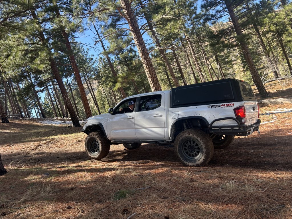

    A few things….

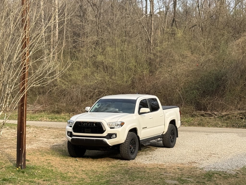

    my simple and functional build
    SEMA Wheels
    265/70R17 Cooper Rugged Trek
    Yotaverse V2 Grille
    OEM Bed Mat
    Gator Soft Tri-Fold
    Rokblokz Mudflaps
    H11 to H9 conversion
    coming soon:
    Color matched rear bumper (chrome delete)
    avs vent visors
    LED fogs
