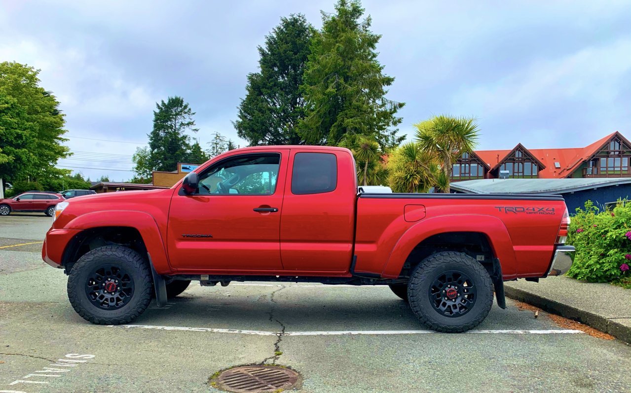

    2 inch in the front (5100) everything stock in the back with a 1 inch block... for now. Truck only has 31k miles on it so she ain’t worn out back there yet but I will be putting medium Dakar’s back there this fall with the coinciding rear 5100’s as well.
    tires are 265 70 16, Ko2’s. And at this angle I think it gives you a precise idea of what you’re asking yourself.
    I’m, personally not over the moon with the look. I have 265 75 16 st maxx arriving Friday going on the truck Tuesday. This will take the tire from 30.6” to exactly a 32”. Am anticipating it will look perfectly proportioned :fingerscrossed:
