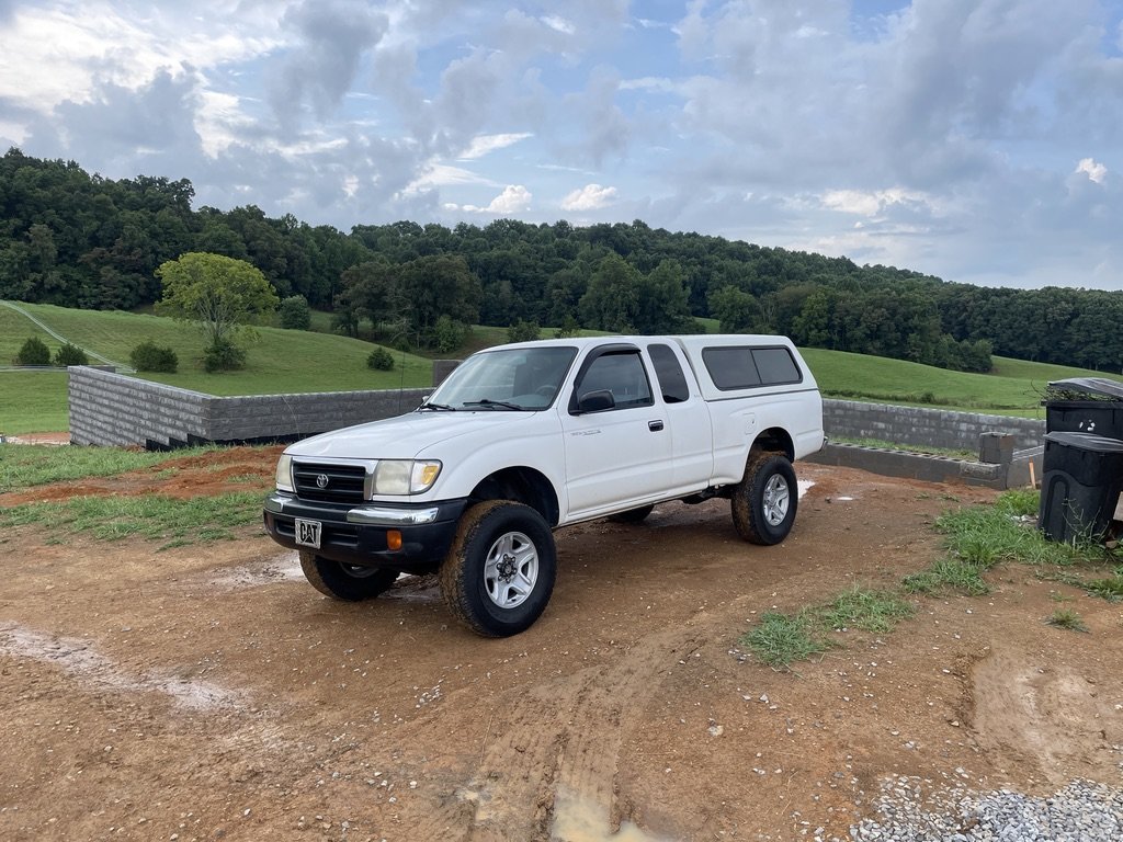

    Hey all- first post as I just bought my Tacoma (1999 3.4L SR5 ExtraCab, 206k miles)
    This will be my daily driver but hoping to do some light to moderate off roading with a fair bit of camping out of it on the weekends when I get time.
    My new purchase jitters has me wanting to throw all the money I have in my bank account into this thing, and I am interested in upgrading the suspension from the stock setup. I am pretty everything is original. I had the upper and lower ball joints replaced last week because there was a shake when it got up to ~60 mph.

    Man that’s a nice looking truck. Aftermarket UCA’s not needed for an inch of lift.
    Replacing bushings in your upper and lower arms would be cheap and effective at improving the handling. Outer tie rods and sway bar end links will help too if the old ones have torn boots and / or are blown out and wobbly.

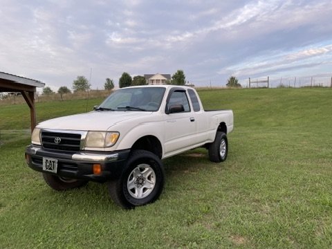

    I’d think twice about adding a huge plate bumper for a truck on 31’s especially on a nice unmodded truck like yours. 31’s mean you’re obviously not crawling through boulder gardens and you’ll notice the almost 200lbs between winch and bumper combo at the front of the truck.
