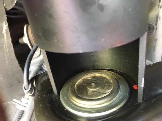

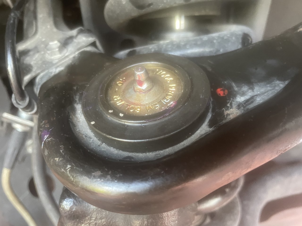

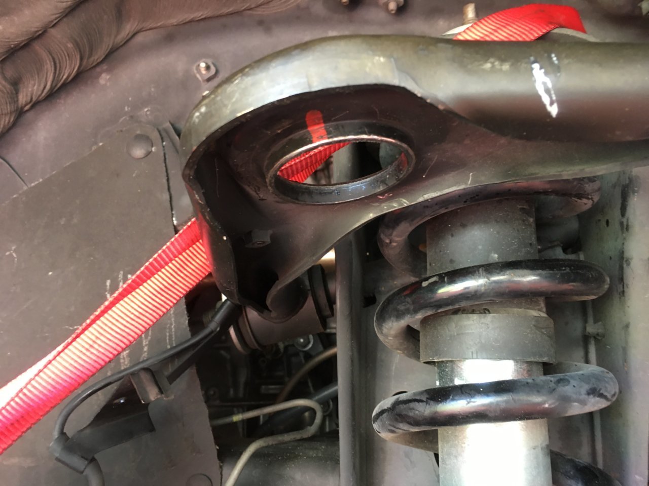

    I have some Moog K80811's upper ball joints ready to install.
    I couldn't get the original ball joints out. Seems if I had a 6.5" C-press it would be very easily
    possible. I got them half way out but had to press them back in for try #2.
    I am now looking for a 9" C-press to borrow/rent/buy. That would make this a quick and simple job.
    I have the right adapters but just need another 1/2" of clearance. Or make that I don't have the right adapters, LOL. I tried cutting one of the adapters shorter and my saw blade failed miserably against this hardened steel.
    This attempt was a rat sh!t, bat sh!t, eat a bag of sh!t experience! Next time will be smooth sailing as I know what is needed. I packed the original boot full of grease and installed back on the upper ball joint just in case it takes a while to do this again.
    Anyone here dealt with this and have input? No wonder why I kept reading about people just replacing the upper control arms.

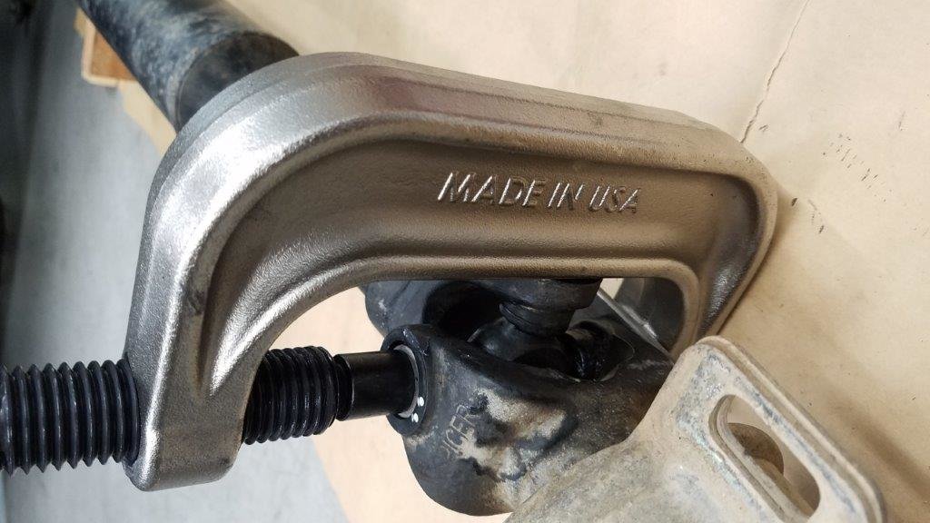

    Old ball joints out and new ones in. 20 minutes per side not including jacking and removing the tires. Thank you compressed air and 9" Astro C press.
    I almost caved for new UCA's but I already had the ball joints and was now determined to get this done.

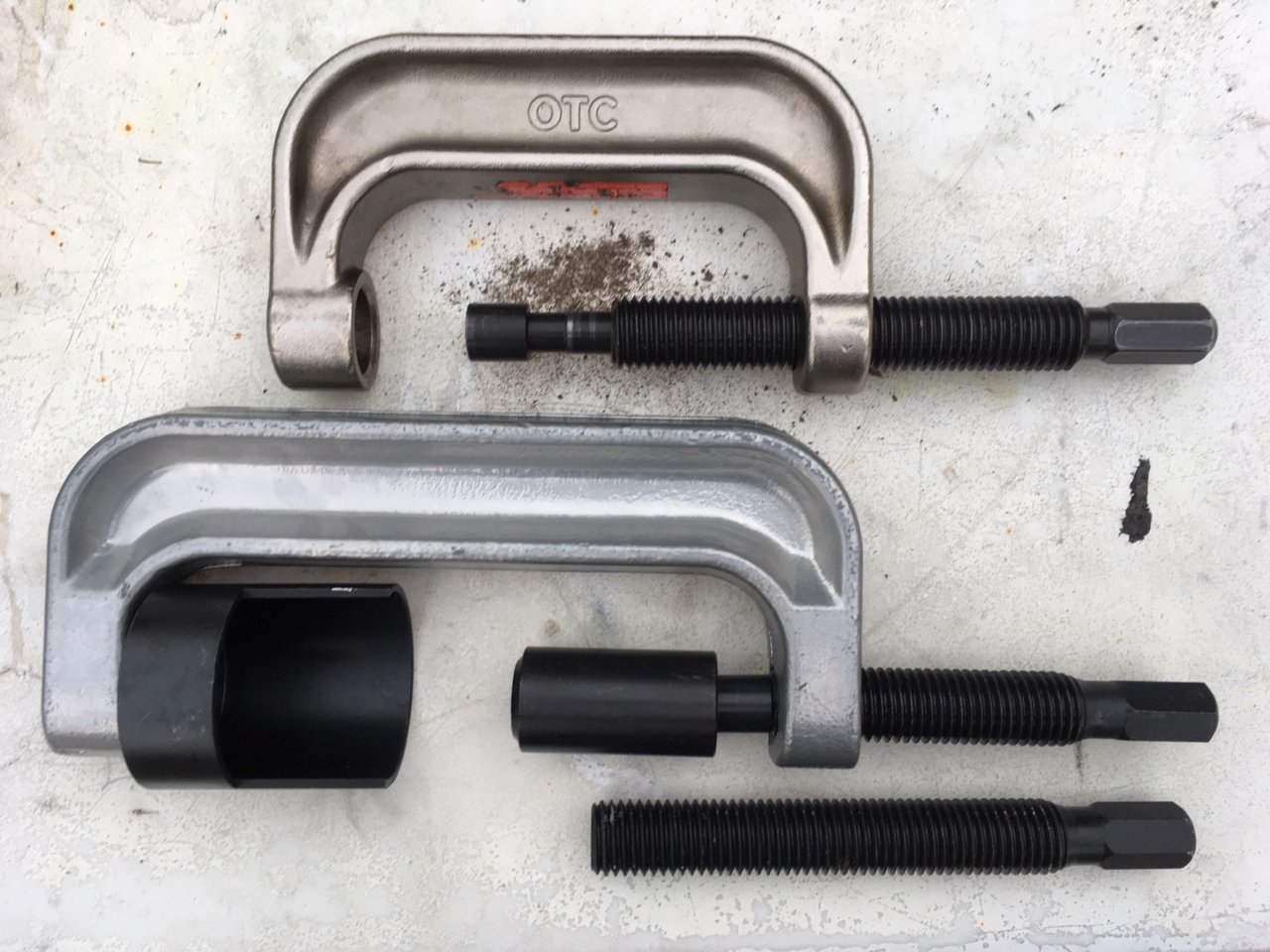

    Good job on the proper DIY and staying away from sledge hammers on new parts :) .
    Is the Astro 9" inside? I have the OTC and I'd guess it's 6". But, the tubes are also probably 1.5" long so it's not an issue. I thought the Astro was about the same size; it looks like it in the pictures.

    Thank you @steve p and @69L46Vert, yes the Astro Goliath is 9" inside diameter and comes with two screws. One is much shorter for limited access and is invaluable in my opinion.
    I own the OTC 6" kit. It was great for the lower ball joints and U-joints but couldn't quite do the upper ball joints with the adapters I have.
    I'll post a write up with pics in the suspension forum when I get some time. Not that anybody really cares, LOL.
    My reasoning was why waste a perfectly good UCA when all I wanted was new upgraded ball joints. It was really quick and easy when I had the right tools.
    Here she is. The two adapters I used to remove the ball joints are between 3 and 3.5" each. I didn't even need to use the short live pin from another kit.

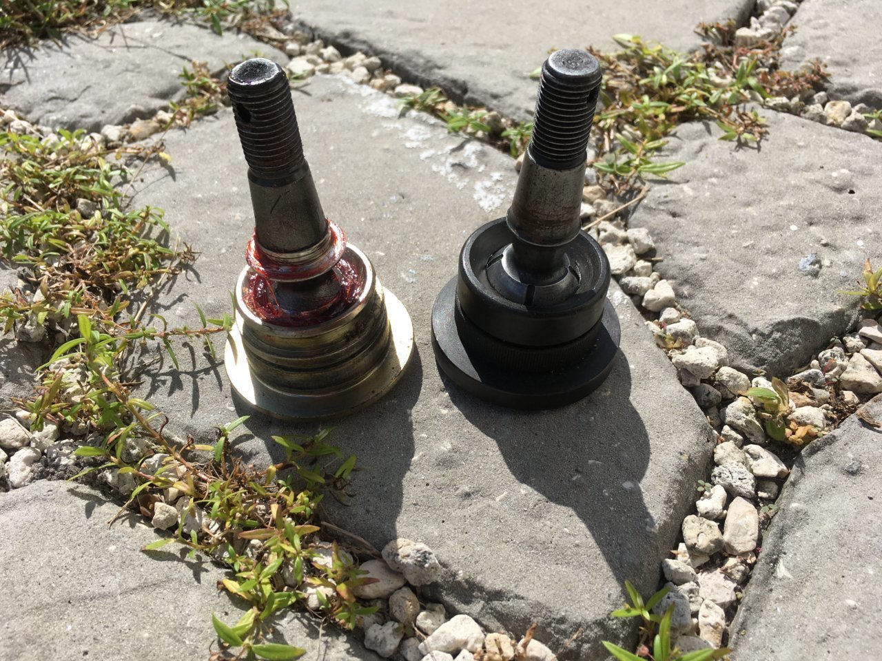

    BTW removing the old upper ball joints took about 3 seconds of air hammer burst but installing the new HD Moog ones took all my old 20 gallon 5hp compressor and HF 1/2” Earthquake composite wrench had to fully seat them.
    E8B779D3-8C18-4652-90F9-BC8482F5DB6C.jpg 837F4FBA-F9C2-4D6E-BA99-017230C90E64.jpg Upper right ball joint.jpg
