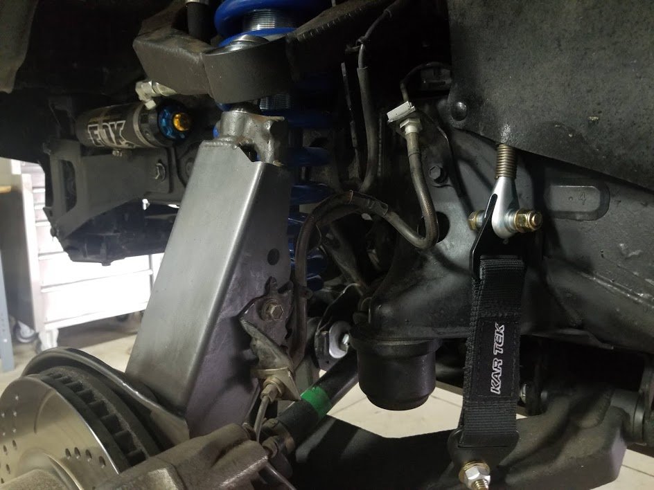

    So what UCA kit is best for someone with a 3"+ spacer lift that wants to keep it on to stop the UCA from hitting the coil. Turning the coil will not work in my case. And i really want to keep the truck height i have now.

    I cant believe theres no ext spindle kit to set up the uca to factory position

    get a limiting strap
