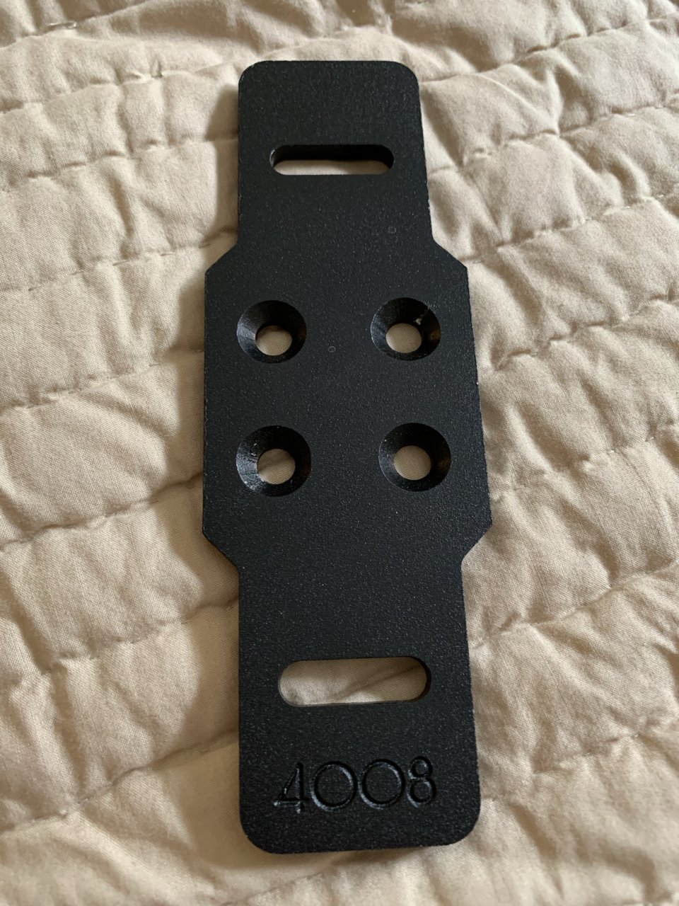

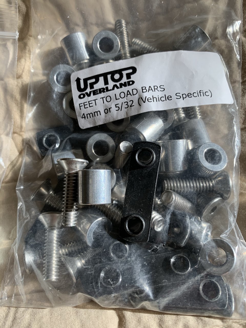

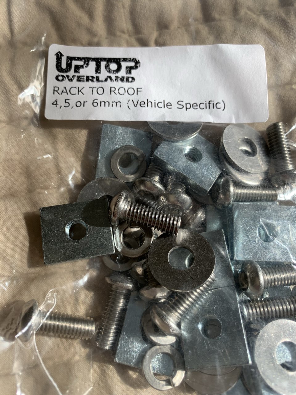

    Looking for some help from anyone who did the eX rack install to camper shell tracks. I have these large brackets and instructions say to attach them to the load bars using tnuts and four-hole squares but I did not get those parts. Instead I got two-hole pieces and no tnuts. How did you attach the large brackets to the load bars? I reached out to @upTOPoverland and they said I had everything I needed. See pics for details.
    Brackets
    Hardware bags

    Put the 2 hole plates in the bottom of the load bar. put the spacers between the bar and the foot and and attach with the flat head screws

    Maybe I was using the wrong terms. I think you are explaining how to attach the foot to the tracks on my camper shell. How do I attach the foot to the rack?

    In the feet to load bar bag. flip the rack upside down to make this easier.
    the black plates with 2 tapped holes in them. place them on the BOTTOM side of the bar 2 per slot. Push on on the left slot and one in the right slot to the other side of the rack. square up the two brackets to make a 2x2 square.
    the silver spacers, place them on the bar in a 2x2 square over the 4 holes for the threaded plates.
    the black feet, place them over the silver spacers running lengthwise down the rack.
    fasten with flat head 1/4" SS bolts

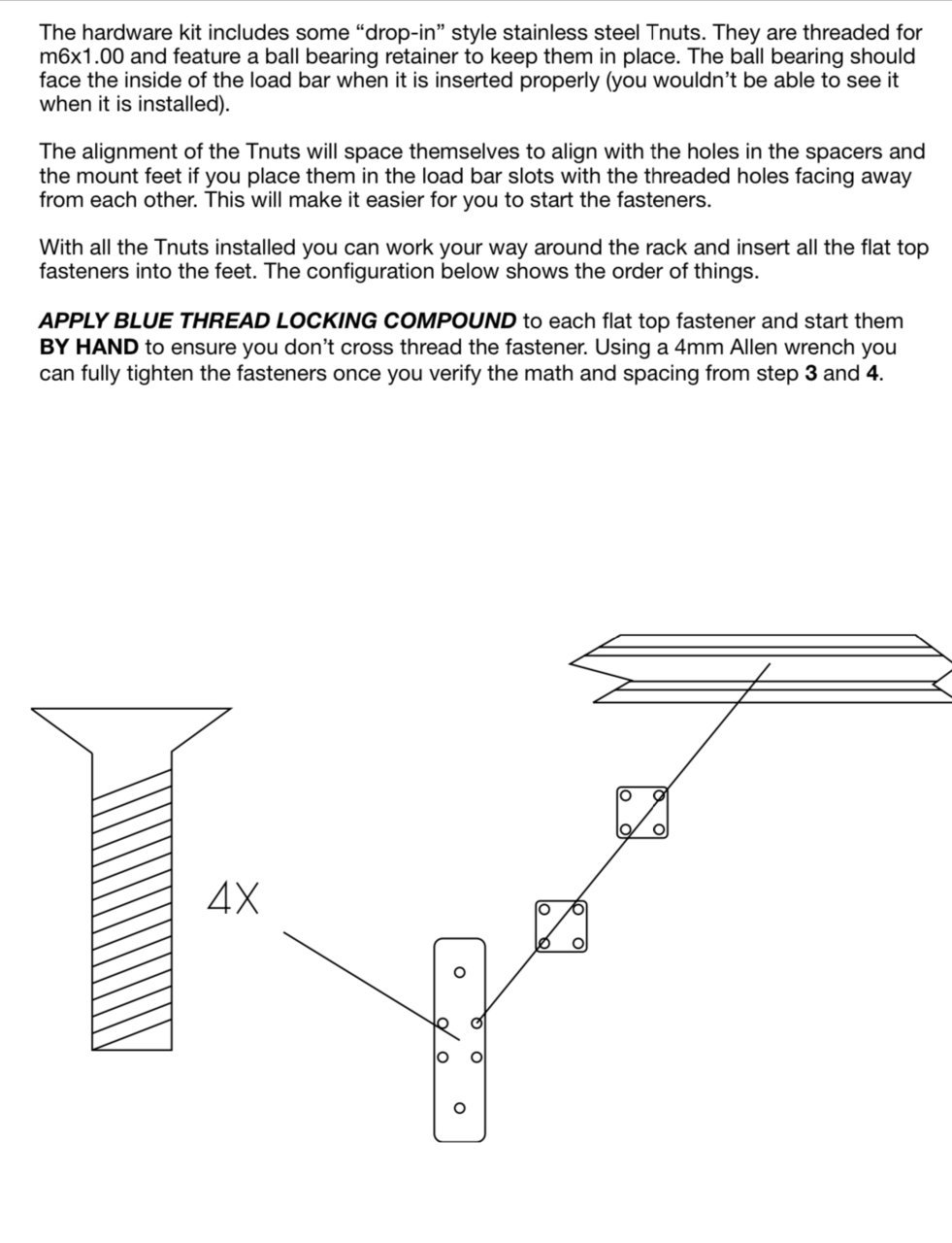

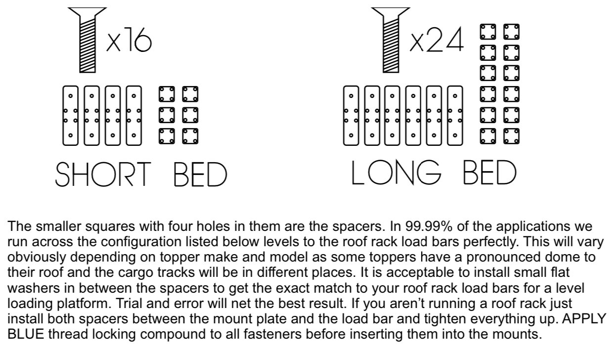

    Thanks. I will try that. Did I pull up the wrong instructions from your website? This is what they say:

    no, those are correct, but outdated. replace small squares with spacers :)

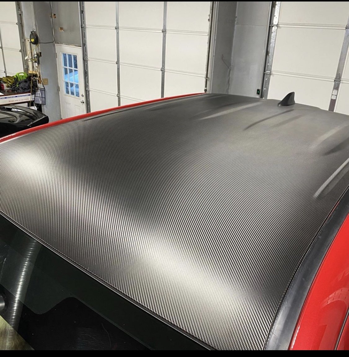

    I like how it looks with the black vinyl on the roof. Like your wheels too!

    Thanks man! I was debating the vinyl but in the end it was so worth it.
