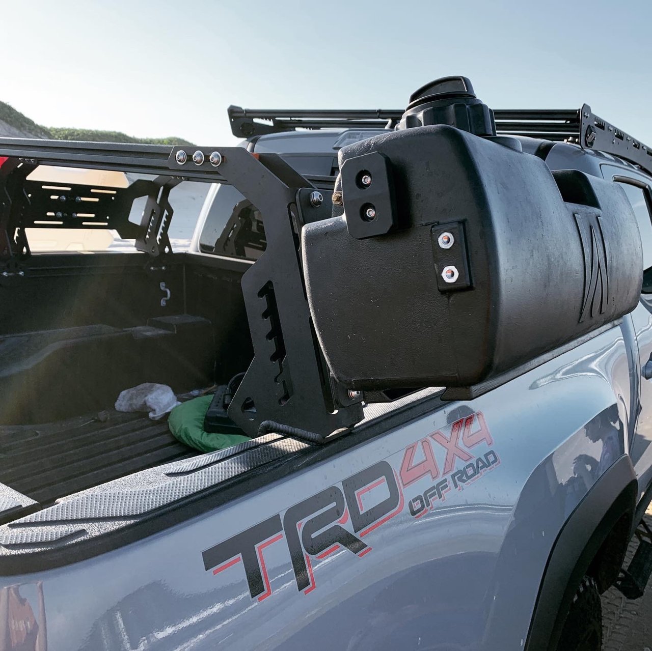

    Anyone have a waterport mounted to either their bed rack or Roof Rack. Mounted mine here pretty quick but it sort of vibrates a lot hitting bumps. I may do something different and mount on top of bed rack using vertical brackets that bolt to the sides of waterport.

    I plan on mounting my waterport like this when my full height truss arrives (just ordered over the weekend).
    I do have the uptop waterport mount for my alpha, but the mounting holes on the newer waterports have changed, and uptop's mount does not fit these.
    I believe Drew said he'd have uptop design a new one for the roof. I will have to follow up on that.

    Our waterport mounts work specifically with their bed rail style mounts

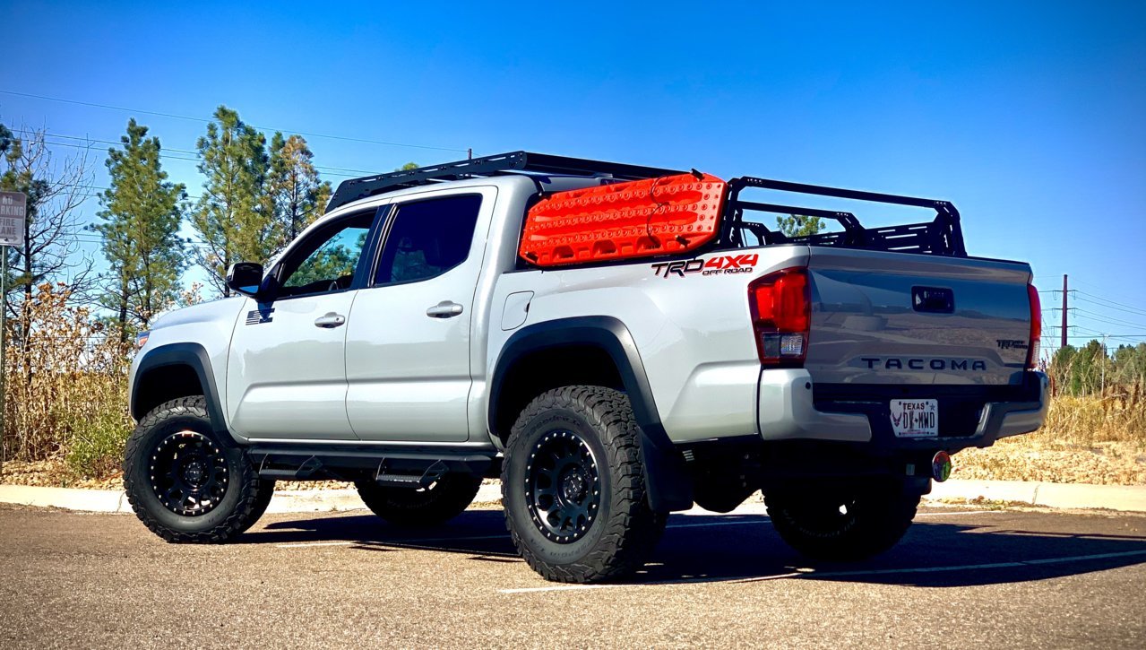

    Added some MaxTrax to the TRUSS.

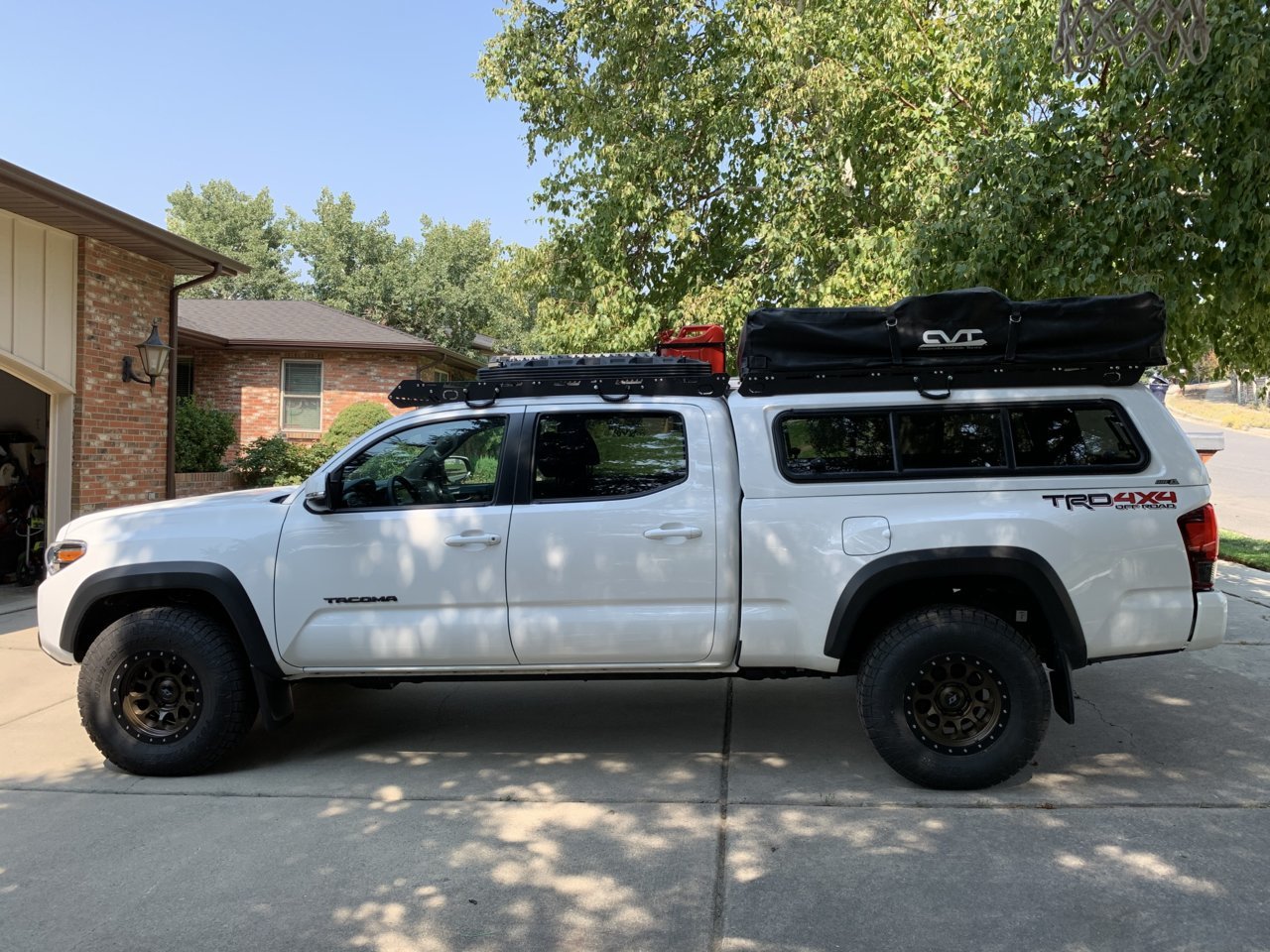

    Will get some pics after work. I purposely mounted it low to fit in the garage.

    So there’s really not a lot of space...
    I should mention that I got two extra bars and attached them to the tent and then lifted the tent onto the rack.

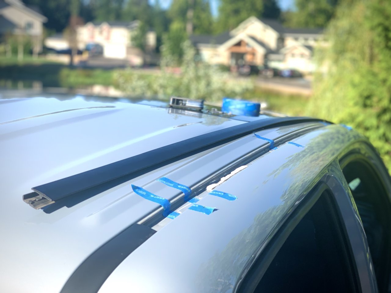

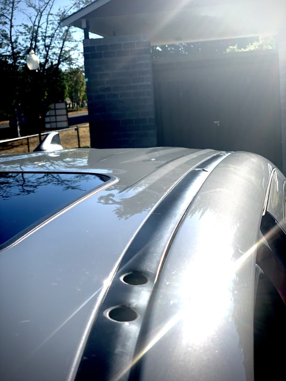

    With regards to the drip LoL dinging, you remove the molding, put tape edge across center of holes, replace molding and mark area of holes with marker. Then use punch to hammer holes into molding.
    You won’t have replace tape or anything as the five holes you punched will hold the molding in along with the silicone you squeeze in there.
    I used a similar method for my Prinsu. But the method is the same for both. Also, upTOP has an installation video with @runnin4tacos TacoTwonz Pro.
    Start there.
