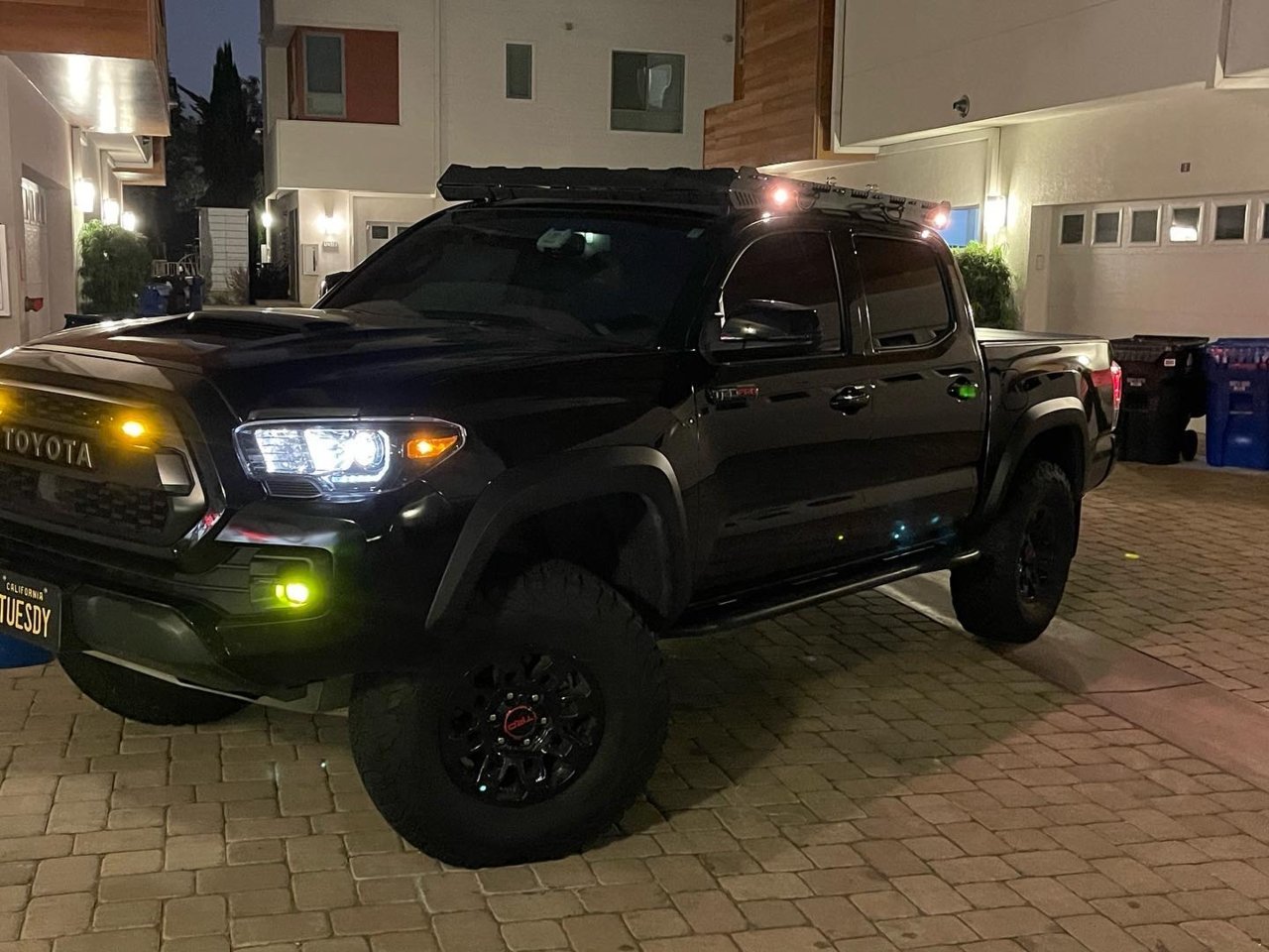

  12. Mar 11, 2022 at 7:54 AM
    #4592
    CAG Gonzo
    CAG Gonzo Ascendant Spaghetti
    Oct 25, 2018
    #270558
    1,688
    2018 OR DCLB BarRed
    What wires did you tap to make the lights activate in those conditions? Do you know what angle your lights are at thanks to the adapters? I made my own and ended up at 35 degrees which is probably too much.

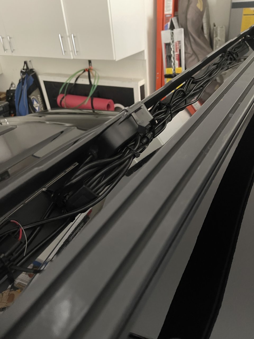

  13. Mar 11, 2022 at 11:47 AM
    #4593
    Mr. Excitement
    Mr. Excitement Well-Known Member
    Feb 19, 2019
    #283659
    537
    J
    Custom floormats, fuzzy dice
    @kmorgan3 made me a t tap. So basically you just unplug the bed light switch connector, his custom tap fits right in. Then plug everything together. Couldn’t be simpler. I had him supply a relay as well even though the vintage is pretty low.
    Only hard part was getting the wires up to the roof. I think I ordered 14 gauge wire at first but it was too thick so went with 16 finally I believe. It’s way over kill for these lights.
    As for the lights angle I’m guessing it’s like 15-20 degrees. Just enough. You can email del torre designs or message him on Instagram and he can let you know. He was super helpful and can answer any questions. Fit and finish looks great imo. And if the lights die for some reason. It’s only like $65 for a new set

  15. Mar 11, 2022 at 9:21 PM
    #4595
    CAG Gonzo
    Oct 25, 2018
    #270558
    1,688
    2018 OR DCLB BarRed
    Thanks for the info. Do your lights all feed into a controller? I've also got a set of 4 lights from them and they feed into one. Instructions say not to mount in the engine bay and I don't know if it's waterproof. I think I'm actually gonna route the wires down the rear of the cab and into the bed as I'm building an aux fuse panel for it. Downside of course is that it'll be more work to tap into circuits towards the front.
