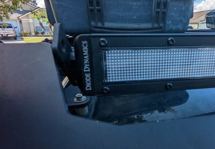

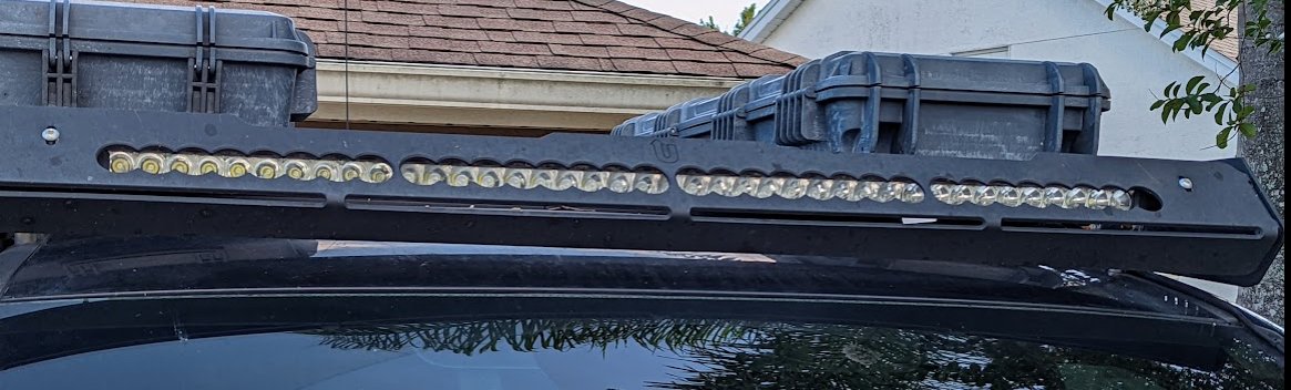

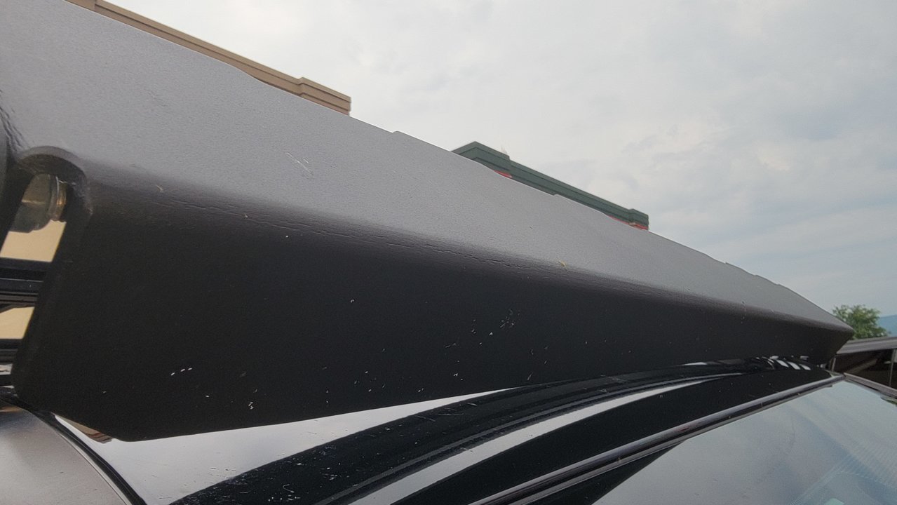

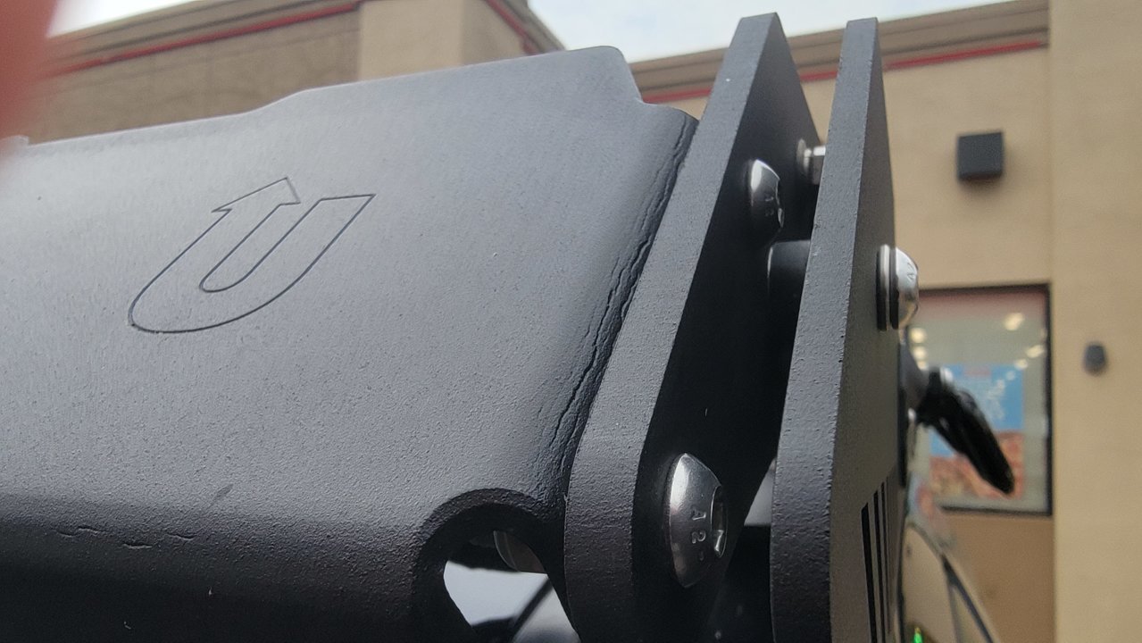

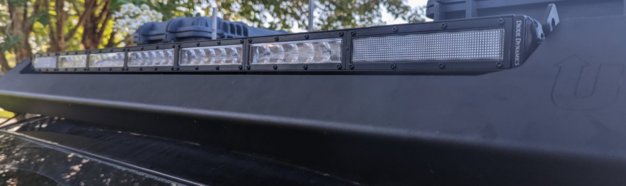

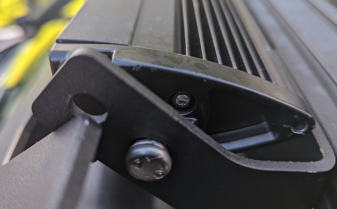

    I have had the bravo rack for a few years now, but never liked the original baja fairing and light bar mount. Picked up a new universal, diode dynamics 42in light bar and some prinsu light bar mounts.
    The fit is very tight and the light bar mounts are actually touching the fairing. There was just enough room for me to force the light bar into place. This combo is simply amazing. The output of the DD is great, there is no extra wind noise difference between this setup and the original.
    Original with cheap nilight bar.
    New set up.

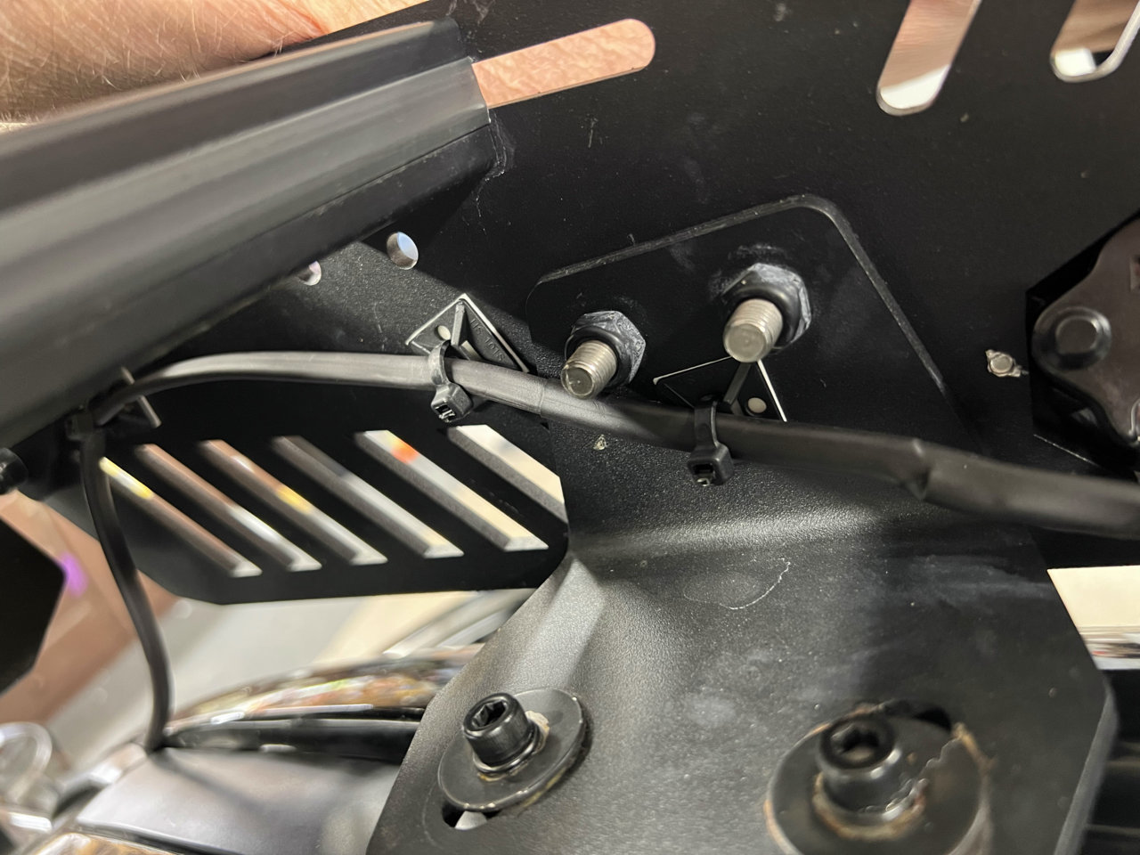

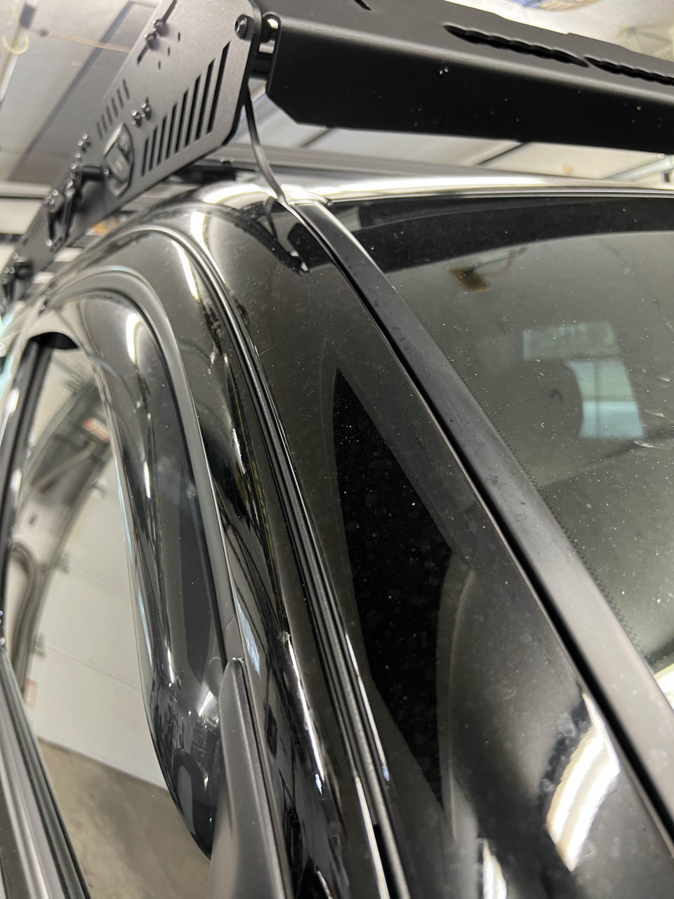

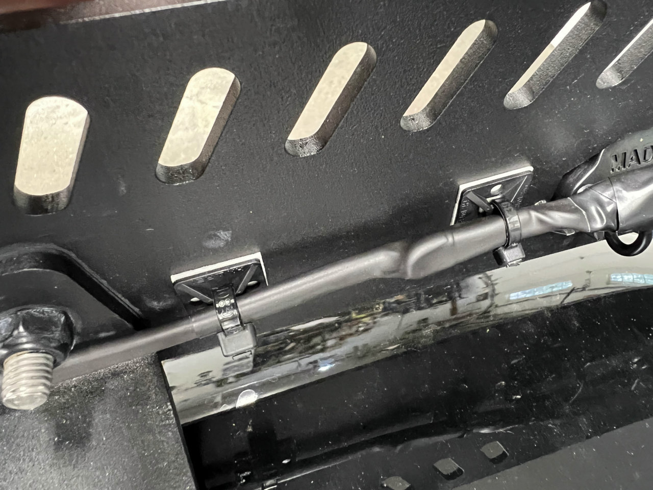

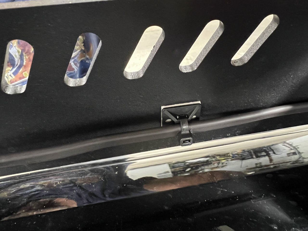

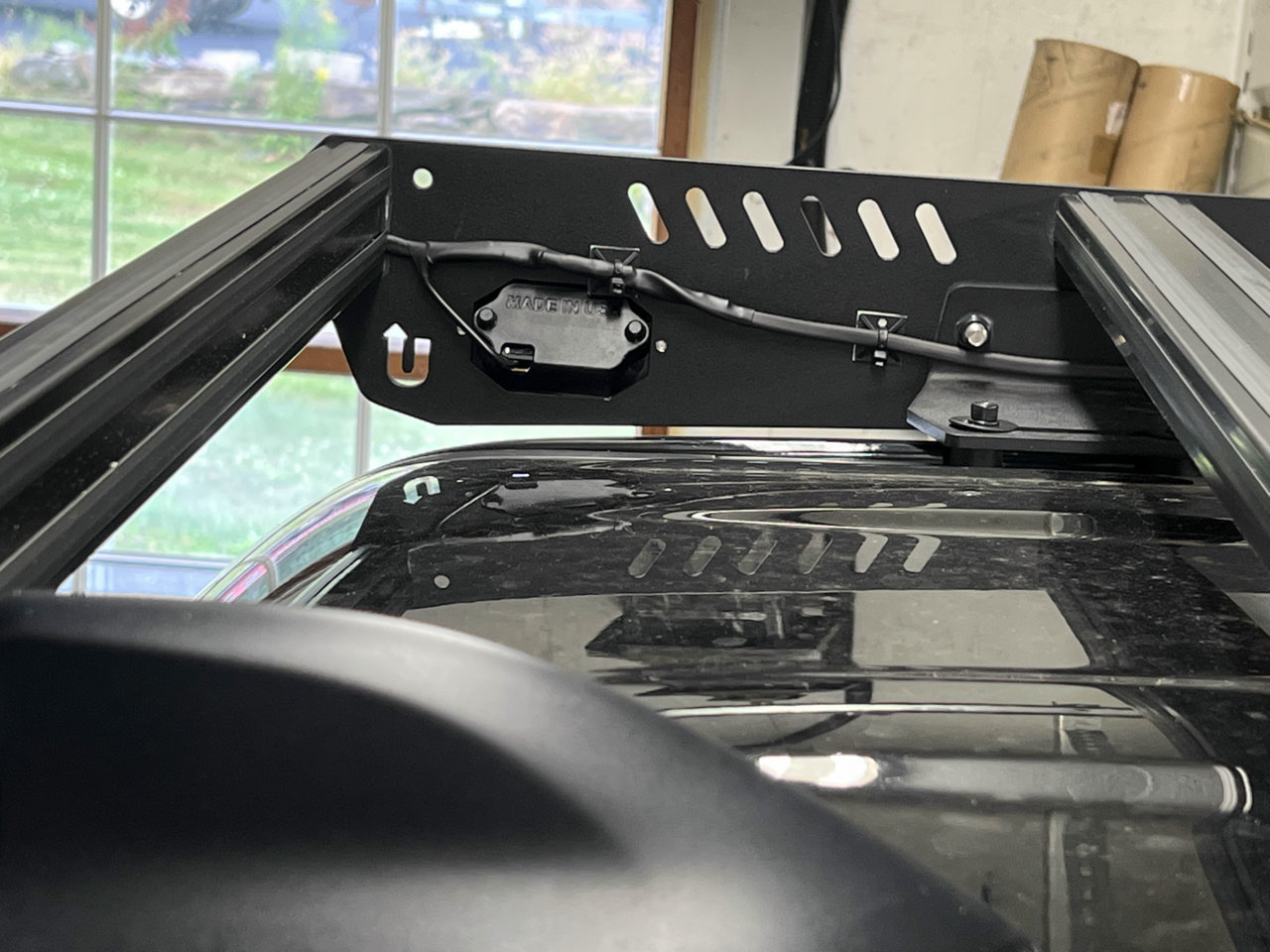

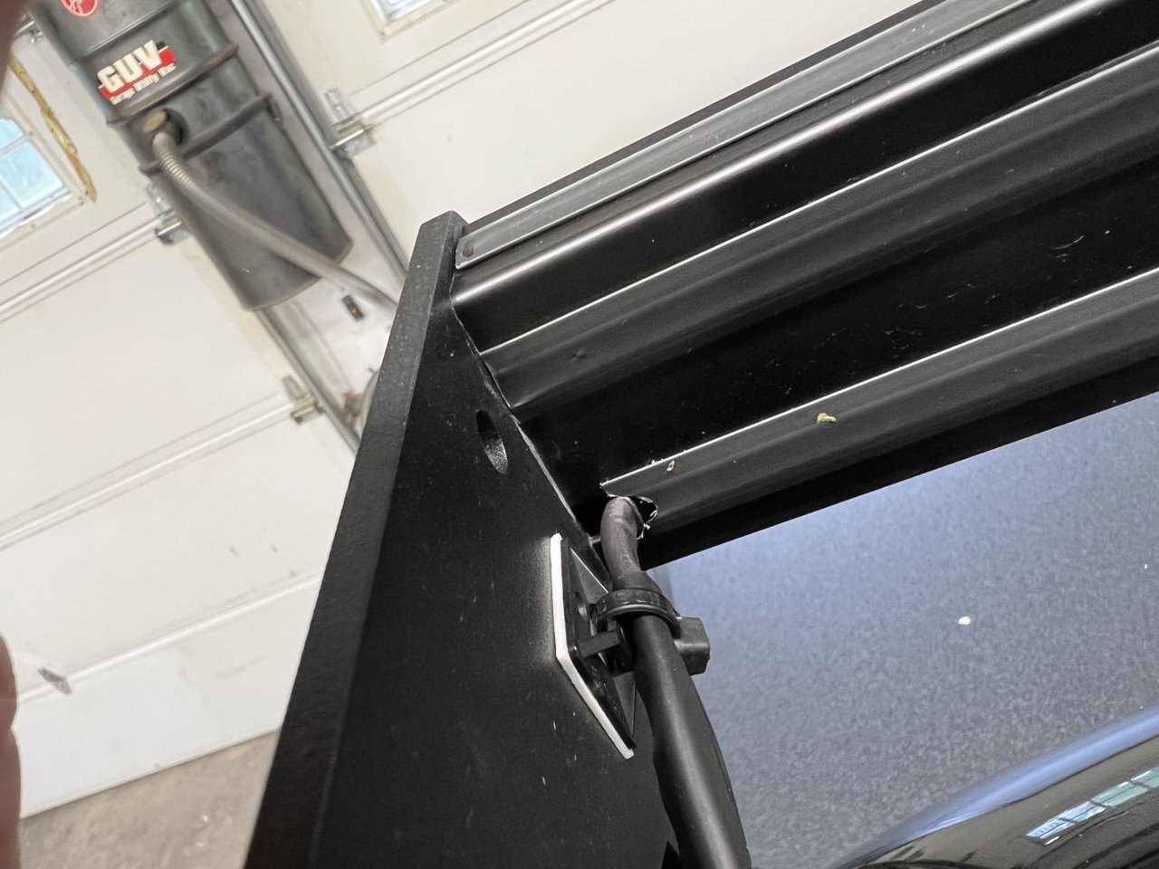

    Made my own wiring harness when I did mine. The feed is coming up on the passenger side of the windshield. Used 3M tie wrap tie downs to keep the wire in place along the rack. To get to teh other side of the rack I feed the wiring in the channel of the rack bar and use cover from 80/10 to cover up the wire.
    Lights are wired to a constant fee from my fuse block. Switch is in the upper console switch panel, for now.

    What gauge wire did you go with for your harness? I'm thinking 16AWG, but wonder if that's overkill (I will be installing lights in the bed rack as well).

    yep 16 gauge wire. The I did shrink wrap tubing around it.

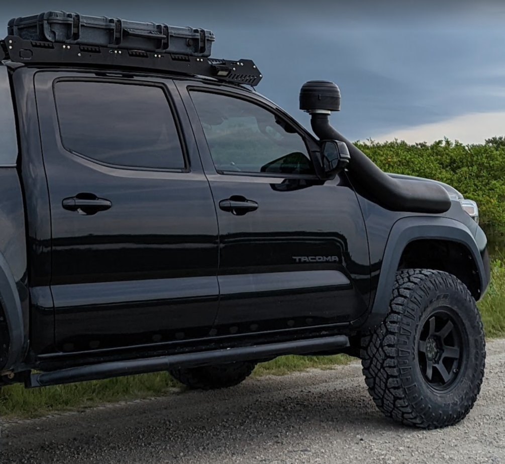

    I have the bravo and a dobinson snorkel

    Wow, cool. Lots of clearance!

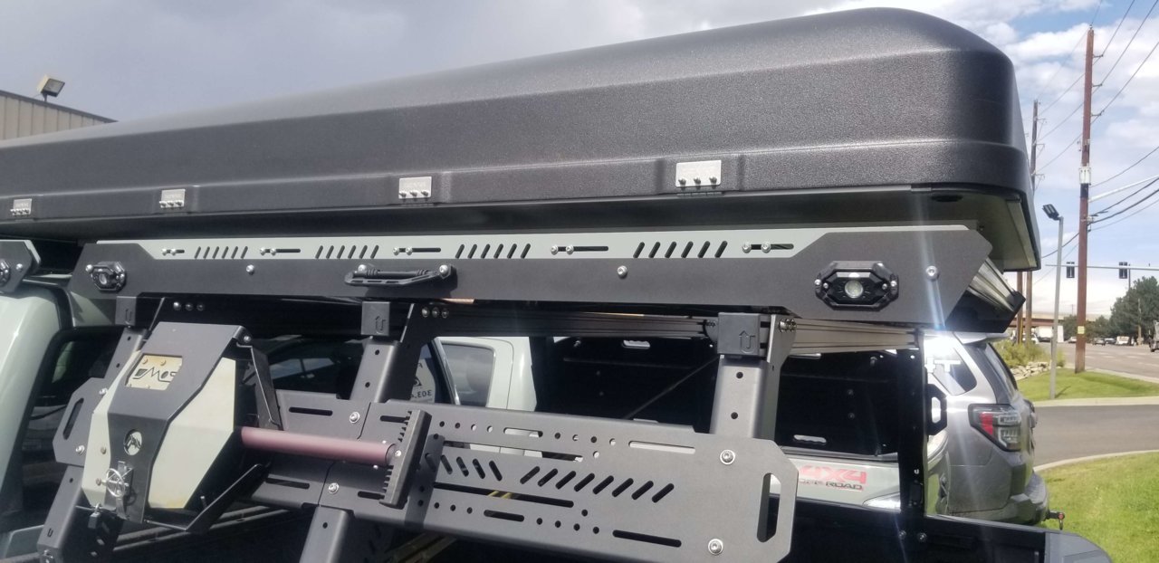

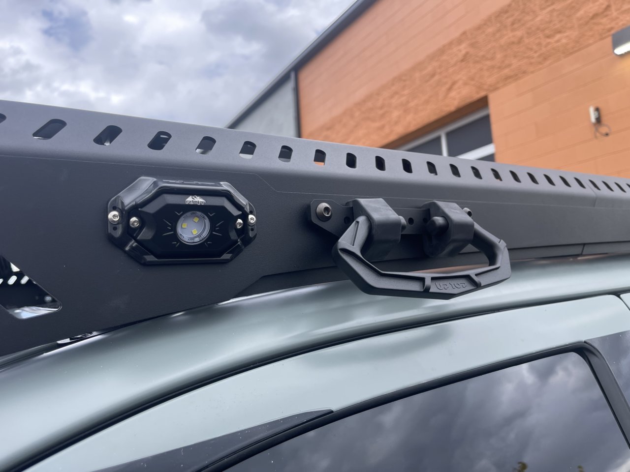

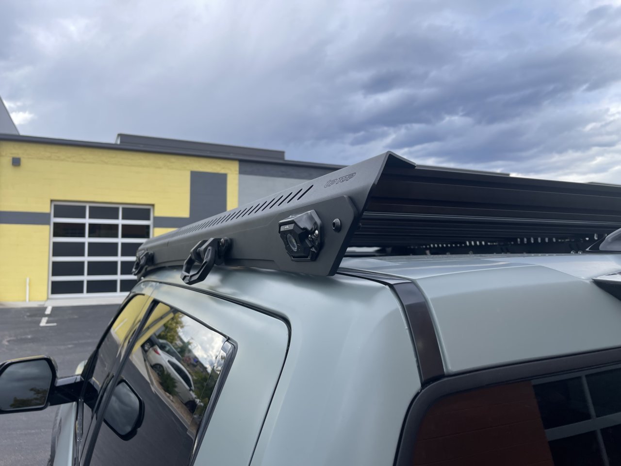

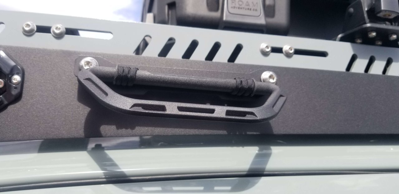

    how sturdy are these handles? looks like they are plastic.

    Aluminum .. I can stand on my sliders and pull up on them.. don't budge..

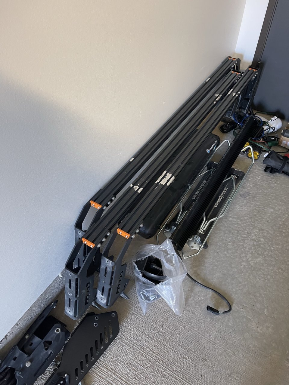

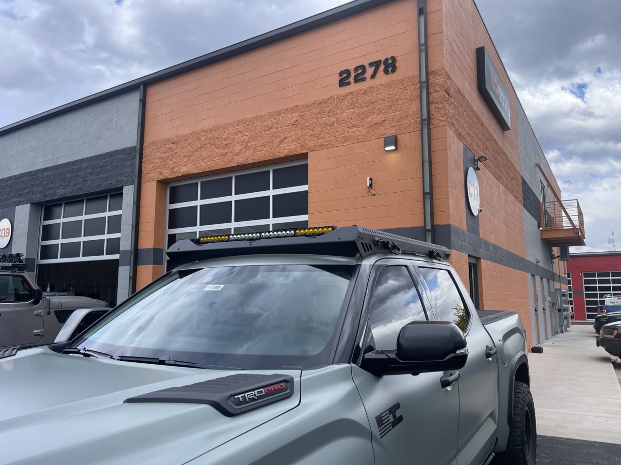

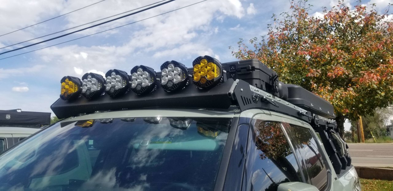

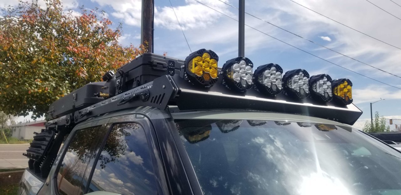

    So I got a new Tundra and am prototyping their new Zulu rack. They haven’t given me intel on pricing or availability yet but I believe they have a Taco one floating around somewhere.
    That said, I am selling a mid-height Truss for 2005-2022 Tacoma if anyone is interested. Asking $500 in Denver area.

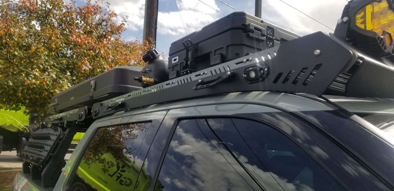

    Thanks. Trying to see if they have more than one purpose. Do you think they'd be strong enough to hold a hammock (say you had two tacoma lined up want wanted to attach a few on either side, front/back like the pix)
    Might seem like a stupid questions since the bars on the roof rack are probably a better attachment point but I feel like the handles would be lot cleaner and more useful especially if the roof rack is fully loaded. Or is the sole purpose of the handles simply to lift yourself up to the roof rack?
