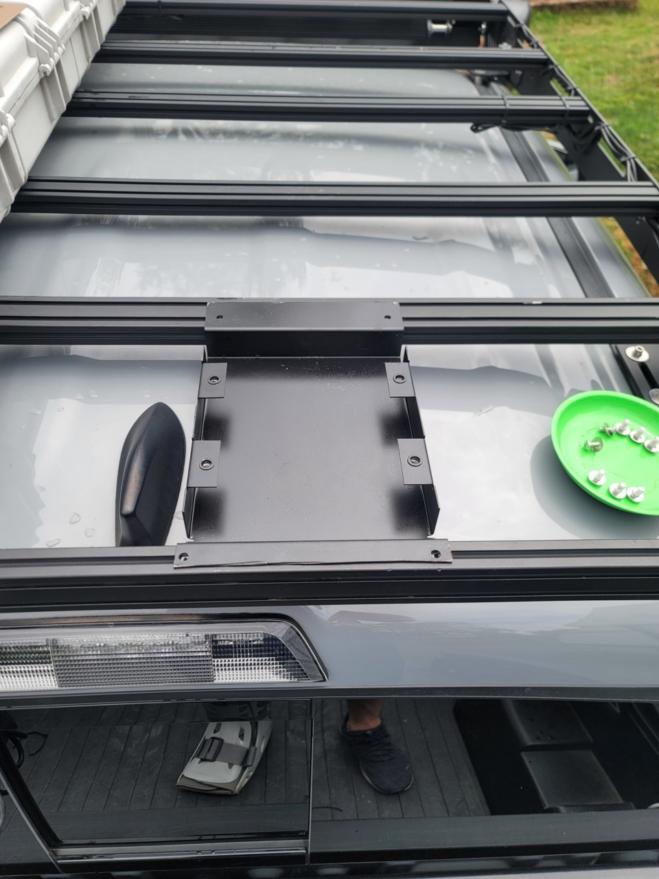

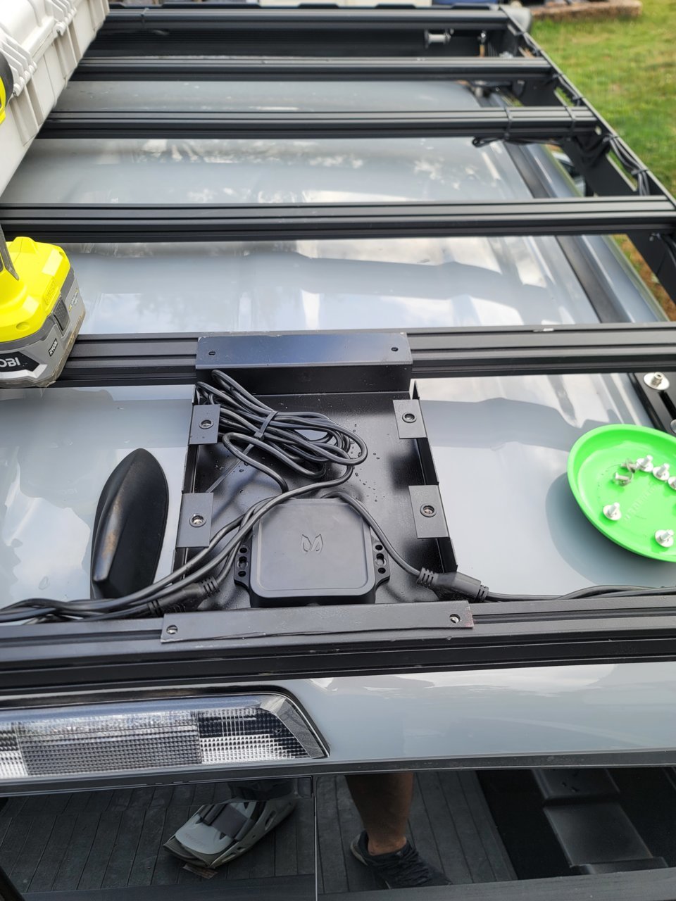

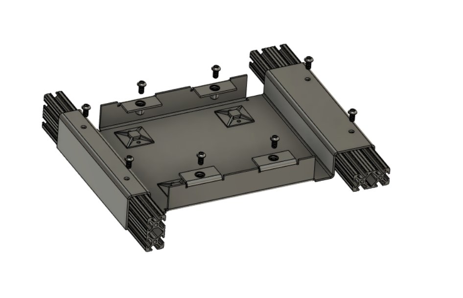

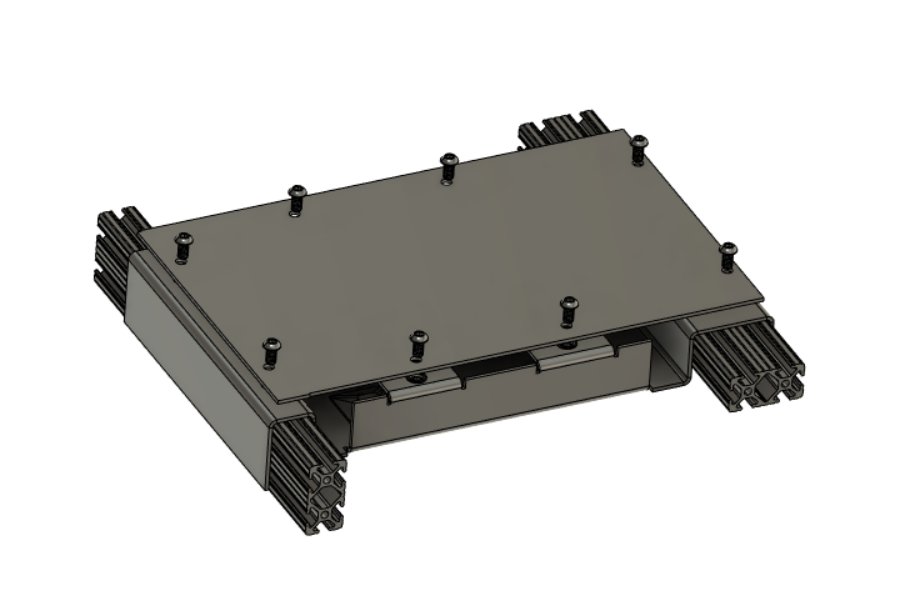

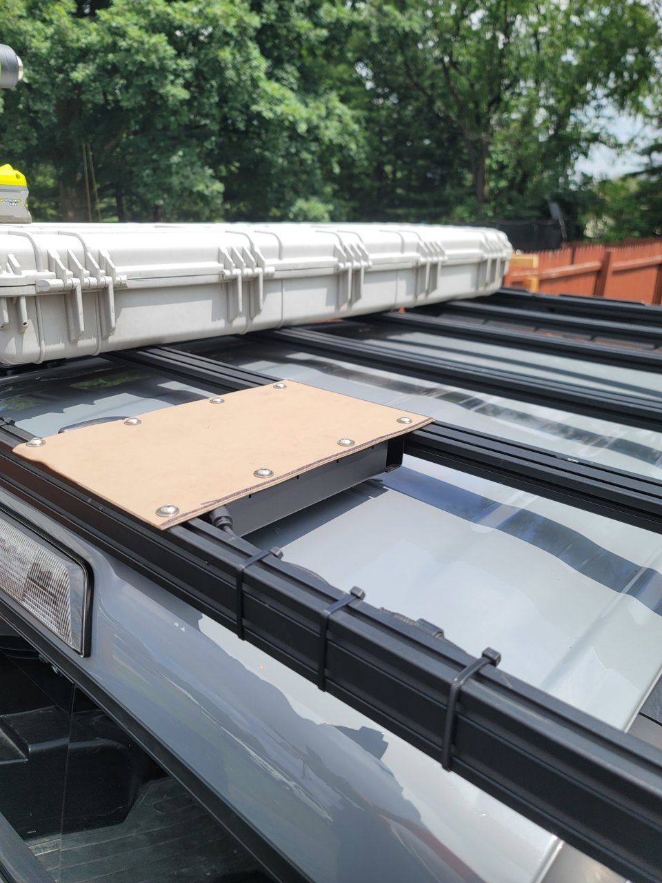

    Designed and ordered a little box for between the rear most rail on the Bravo rack to hide wires and my lighting control box.
    Ordered in steel that I will paint and I will probably just do a kydex lid. Not water tight but should not really take up space and be out of sight.

    that looks mighty fancy. I just cut a couple pieces of steel flat bar to do the same essentially, but its nowhere near as nice as this. Good job!

    Yea my test run was some hand bent aluminum u just wasn't happy with. The the ADHD kicked in and I learned how to use fusion 360 and sendcutsend. Lol
