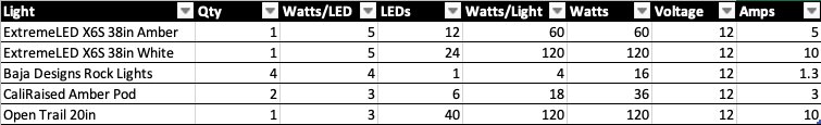

    How would I calculate the amps being drawn? Some of the sites list watts or volts, but not many list amps. I currently have 14 and 18 gauge wire sitting around so I could use either if I have still have enough.

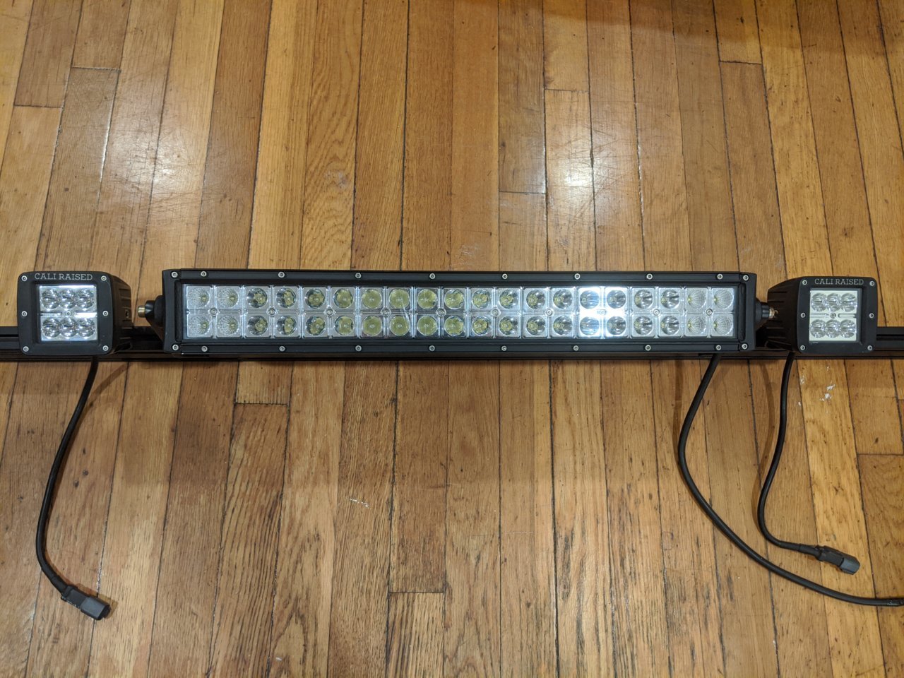

    Also here's a preview of the rear bar

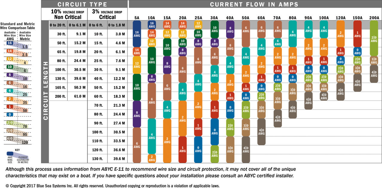

    I would calculate the current draw of each light, and figure out how much you want to put on each wire. Base it off of this chart below to make sure your wires can handle it.
    You can base it off of the chart below:

    Okay so assuming I did this correctly...
    Am I correct in understanding that fully lighting up the X6S would be a bad idea through the provided harness since the total amps would be 15 through a single negative 18 gauge wire?

    2018 Tacoma TRD Sport
    Yes, your understanding is correct. This also applies to both of the positive cables. One of your positive cables would draw 5 Amps, the other would draw 10 Amps. At the least, I would change the wiring to 14 gauge, depending on the length of the wire.

    If you are running 16 gauge for the white and amber separate, that would work. You could then do two negative cables to compensate for it.
