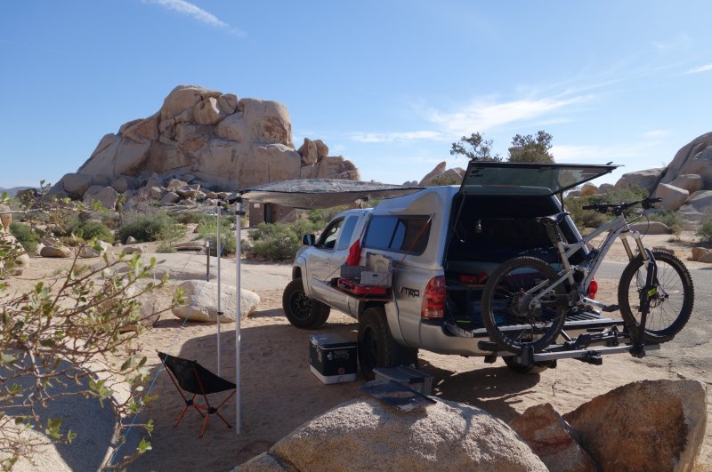

    Finally got to take my Tacoma for a proper road trip and wanted to share my "build" with the other Tacoma owners out there that love to camp and overland. I've done lots of weekend trips in the 2 years since I bought it, but I just got back from 3 weeks and 4400miles over much of the west coast of the U.S. visiting national parks and mountain biking.
    ScreenShot2014-06-15at121849AM_zpse6df46_45702b41a0f07d37e6d8d9cc8b3164edf97c2476.jpg

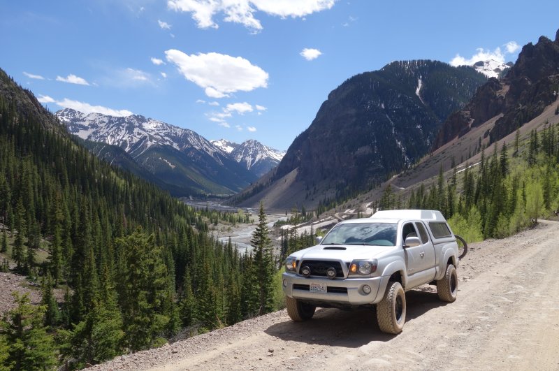

    I picked up this 08 TRD Sport last summer with a canopy (topper) already on it. I knew I wanted a canopy, but maybe not one this high! I soon realized why the tall canopy was the only way to go and learned to love it. First thing I did to the truck was upgrade to some SCS Stealth 6's with General Grabber AT2 265/70/17. I knew I wanted this tire size, and a 2" lift because I do a lot of road tripping and wanted to retain some driveability and gas mileage. Plus, I just like the look of a 2" lift better than 3. I ordered up the OME 884's and Nitrocharger shocks all around from Toytech. I also did the AAL in the rear, though wish I would have just ordered a full leaf pack because the rear leafs are feeling pretty played out at just under 70K on the ODO. I had to do some trimming on plastic and ditch the front flaps, but otherwise 2" lift with this tire combo is good to go. In addition to the BHLM (which took me a couple tries to get properly sealed for Washington State wetness!), I did the K&N air filter and wired up some Hella Black Magic 500's. They are mounted through the plastic bumper skin and are bolted to the bumper support below so they do not shake around a lot while driving. I just didn't like the looks of any light bars out there and am not ready to do a full bumper just yet.
    ScreenShot2014-06-15at120814AM_zps4792c2_979783e07816e85411eb7b9a91e70b1f87b0e606.jpg

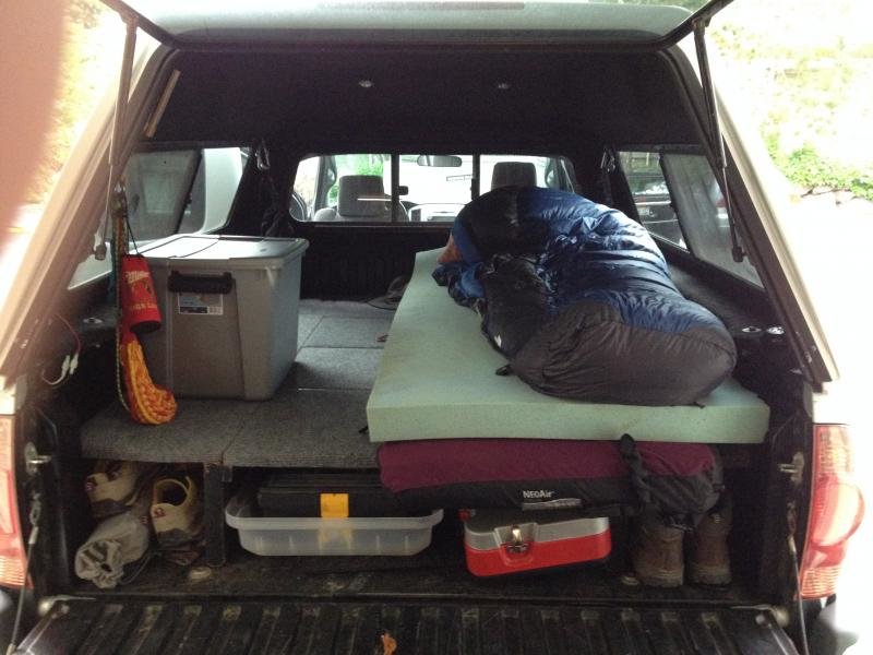

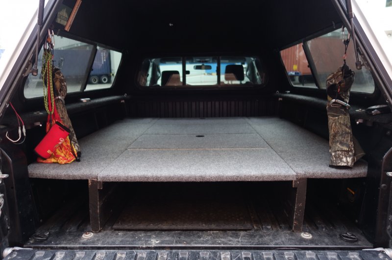

    Now came the fun part- The camper setup! This was planned around having to take out my sleeping platform often for transporting bikes and other toys. Eventually I went to a hitch mount bike rack because muddy bikes and sleeping gear just don't mix very well. The platform is built in 4 large pieces: 2 sides, and 2 removable accordian sections in the middle. This allows me to get at gear from above no matter where it might be under the platforms. I used MDF, pine boards (will be replaced soon) and large 2x12's ? for the main supports. I used bed texture on the lower bits and carpeted the rest with outdoor carpet from Home Depot. Some staples and hinges and I was all set! There's nothing I'd like to change from this setup. It comes out easy for cleanup after the dogs are in there, and is light enough for one person to set up etc..
    ScreenShot2014-06-15at120834AM_zps2c693f_4e7a6da41f1f661b117c3a3882cf1cb3b50ac6ff.jpg

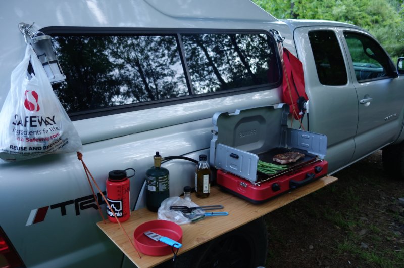

    I noticed pretty fast that I didn't like setting up my grill on the tailgate. Sometimes you need to get in to the canopy area when you're cooking, or the dogs want to jump up etc... it was a pain. In addition, on the inside, it would be nice to have places to clip lights, curtains, clotheslines etc... Being a rock climber, I decided to use stainless "bolts" used for clipping into while climbing bolted rock routes. Using 4 on each side and some rubber washers, I had attachment points on both the outside AND the inside! And they kinda look cool :)
    ScreenShot2014-06-15at122203AM_zpsd94296_a20b2d331398ddce5196441e714837f28c52b0b1.jpg
    ScreenShot2014-06-15at122453AM_zpse91924_d2c476f07a15fd5eba7ccbd261bb6ef6bc4c38b7.jpg
    I added some little plywood shelves attached with some cordlette and now my cooking station is on the side of the truck and a simple tarp awning finished things off. On the inside, curtains and clotheslines etc. finally have a place to go.

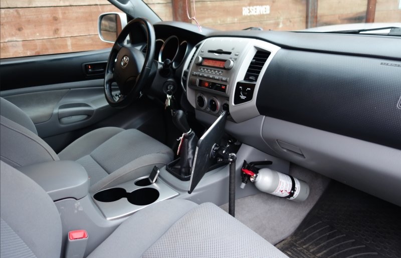

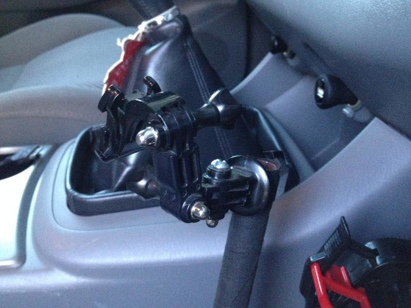

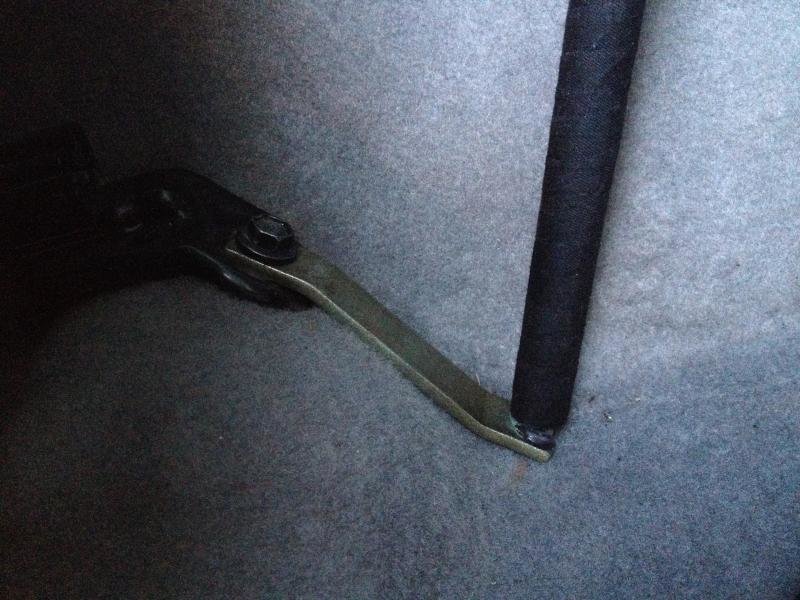

    I would like to see a better pic of the tablet mount/base.

    I'll see if I have a photo, if not I'll post one on here. Basically tied in to the lower seat mount with a diy bracket to a post that uses goPro mounts on top.

    Looks awesome, but I'd watch out for paint damage from that grill being so close to the side of the truck.

    Awesome build and trip! I like the platform and cooking station! I run into the same problem cooking on the tailgate so that's a nice easy alternative (I climb too.)

    Here's a couple photos of the bracket I made. At over $100 on Amazon, it took me only about an hour and some random parts I already had to rig this up. It uses the go-pro mounting hardware so I can take it off easily and stow in the glovebox etc..
    As for Gaia, I definitely liked it. I find that I do prefer to have a physical map on hand though. For most of the hwy travel I just used the google maps app on my iphone to get directions from town to town. The idea with Gaia is to download maps from all the backcountry areas that I go to in preparation for not having cell service or printed maps etc.. It might be cool to couple with a GPS reciever in the future for more in depth navigating. The problem is, I have a first gen iPad, so it is pretty sluggish.

    I thought that would be a problem as well, but the metal conduction on that Primus grill is crazy! The surrounding areas don't change in temp at all while the cooktop gets super hot! I think there's a ceramic coating on the surround of the grill or something. I highly recommend this one, as my Coleman got so hot, the metal griddle melted on it and I had to take it back!

    Thank you for the detail shots! I need to build the same thing, I use a 2nd gen ipad with this Dual Bluetooth receiver. Problem is I don't have wifi so I have to download my maps before I head out which normally doesn't happen. I'm using the motionX app which I'm not overly impressed with. I wish it included the maps, I haven't quite figured out how to download maps and import them into the program. I might try the Gaia app.

    How did you attach the DIY awning to your shell?
