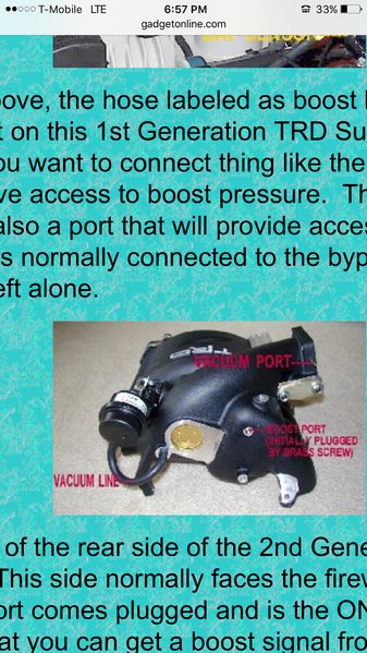

    Sweet I'm gonna grab that. Now I just put a boost gauge and its reading vaccume. I put it on the port that every thing says and it basically it ties into the fuel pressure on the back side of the s/c. Please correct me if I'm wrong. I'm pulling my hair out. Lol

    image.jpg This is what o read but that port actually pulls vacuume and is where the fuel pressure regulator ties in.

    That's a port. You're cutting the IAC line next to a coolant hose.

    When I hook up to the port is pulls vacuume I can even feel it with my hand.

    Suppose to have -21 ish vacuum at idle.

    Ok, cool. Then it's working. The gauge is only reading about 2.5 - 3lbs of boost and Ye about -20 ish of vaccine. Considering it's a really cheap gauge and my wastegate is not working at all I can feel a pretty big difference. I just have to wait on the new wastegate or "vaccume actuator" and the one way valve IAC mod to come in next week to get the full benefit of the supercharger. Thabks again everyone.
