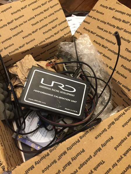

  14. Nov 7, 2016 at 3:58 PM
    #114
    Rmartin517
    Rmartin517 [OP] Well-Known Member
    Oct 8, 2016
    #199267
    144
    Robert
    Texas
    2001 4 door Tacoma limited trd
    Supercharger, 6" fab tech, 20" moto metal wheels, 34" Nitto trail grapplers
    image.jpg Look what showed up today. I feel I got a good deal. 350.00.
    TXpro4X4 and 99SuperTaco4x4 like this.
  15. Nov 8, 2016 at 8:09 AM
    #115
    Clay_916
    Clay_916 Well-Known Member
    Jul 30, 2015
    #160686
    1,501
    Fort Collins, CO
    2000 x-cab 4x4
    5100's, All Pro 3" Standard leafs, 32" KM 2's
    350 is a steal. Is it complete?
  16. Nov 8, 2016 at 8:15 AM
    #116
    Rmartin517
    Oct 8, 2016
    #199267
    144
    Robert
    Texas
    Everything except the T to the 7th. I'm gonna buy a new fuel pump though. If I'm gonna go through the trouble I'm gonna put a new one.
