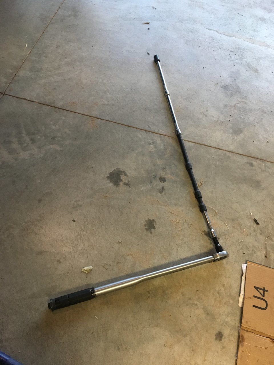

    Hey man so I pulled my trans not too long ago and its actually the easiest trans to drop and reinstall I've ever worked on! The top 2 bolts on the bell housing are the hardest part but if you have some longer extensions you can get to them no problem. If you don't have any, I'd recommend going to harbor freight and getting the 3/8 drive set of extensions that has the wobble built on to the end of it so the socket has a little bit of wiggle room. A tranny jack is also gonna be a lifesaver here. I did this job by myself in about 5 hours. But all I did was remove the trans, install the sleeve and reinstall the trans. I didn't disassemble anything else besides the crossmember and a few other things needed to get it out... Good luck.
    This is the extension set I used, comes with three drive sizes: Also the jack I used:

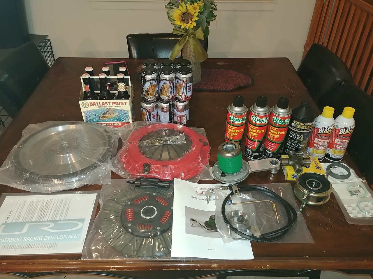

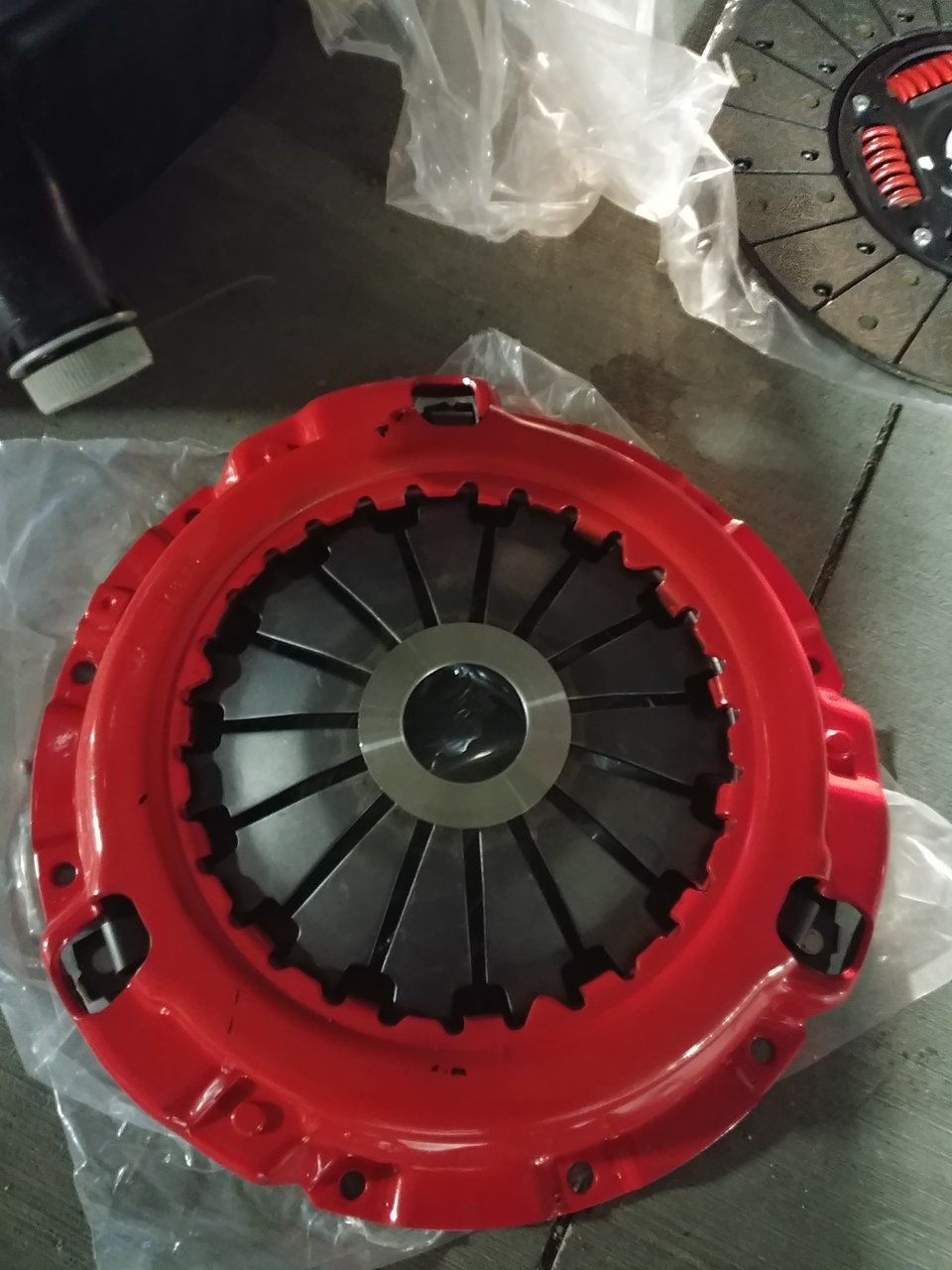

    So I have all my parts and I have one more thing even better!!!!!!
    Im in Utah. Im a part of Wasatch Tundras and Tacomas, an 1100 member group here for the folks in Utah that just cant get enough of Toyota. There is a certified Toyota tech coming to help me tomorrow for this job. Thanks to WTT, that is. So I intend to be as thorough as I can on this. Especially with his help. I want to make sure that if any issues come up, I can rule out installation. Anyway.... Heres a taste of of the job.
    So as you can see, the most important thing is the beer.
    Ive got a new carrier bearing and U joint going in. All the exhaust gaskets since we've got to take that off. Some cleaner for the housing, dot 4 for the blead, pb blaster because, well, you've gotta have pb blaster, hydro bearing conversion kit with lines and all, stage 2 URD clutch, and the torque-u heavy flywheel. TBC.......................
    bdbrown, WPNZ, kryten and 1 other person like this.

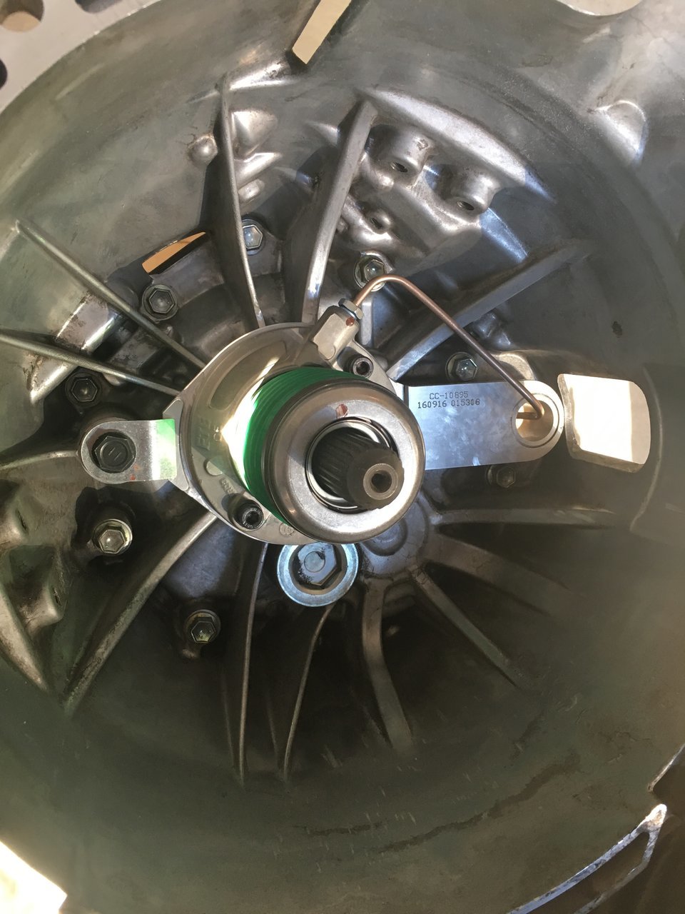

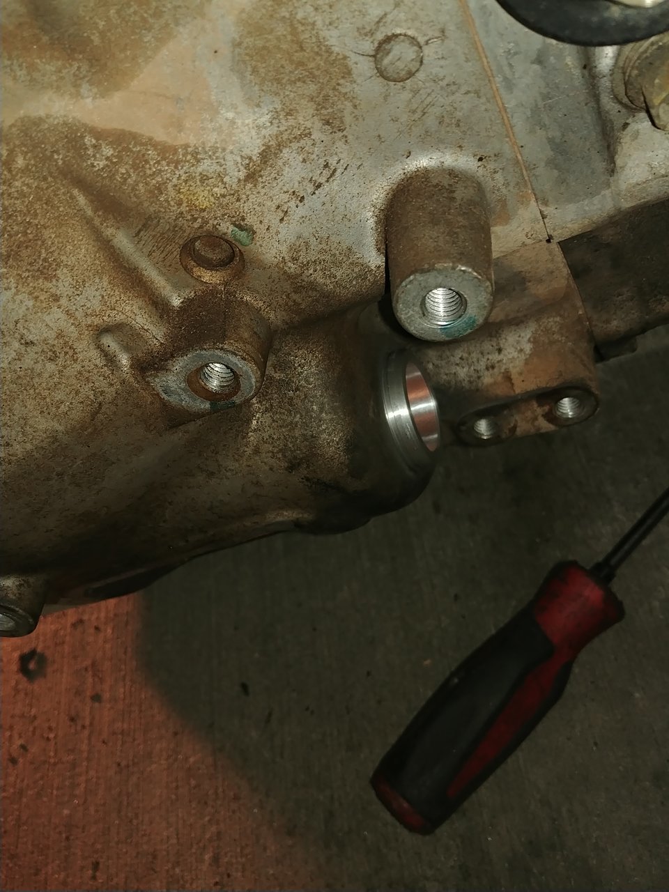

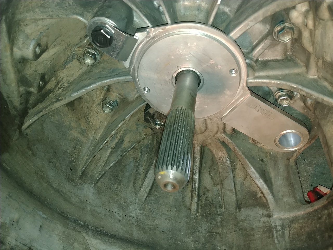

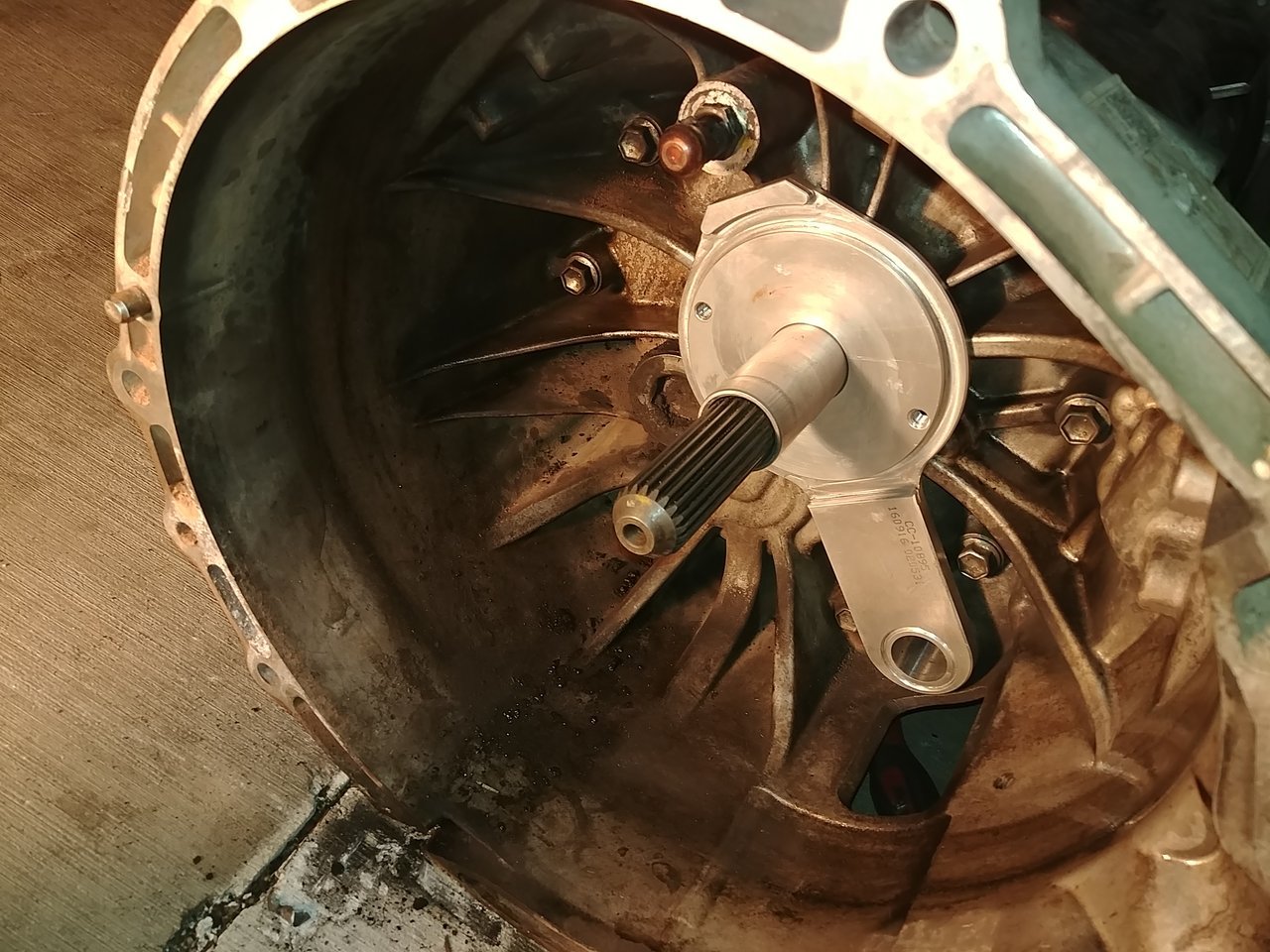

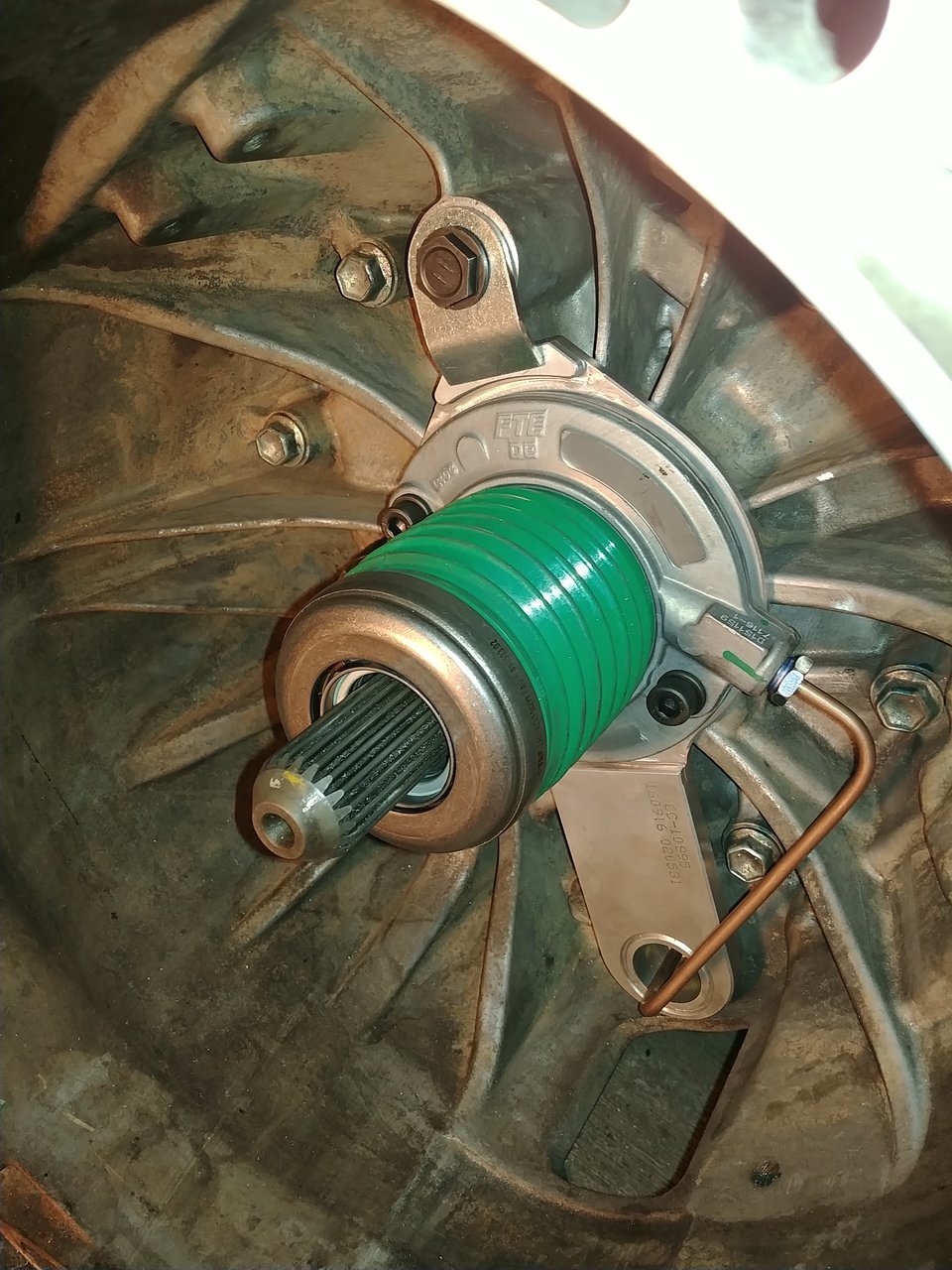

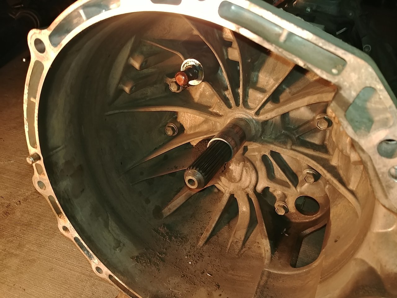

    I did this myself last year, not too bad. I went ahead and replaced the rear main seal just cause it was there, but I messed up putting the new one in and had to do a "do-over".
    The one tip I do have is that I had to shave/grind down some of the casting inside the bell housing to get the bracket to sit right and be able to put the snap ring on. it took me the better part of a day to figure out why i couldn't get the bracket to sit right.

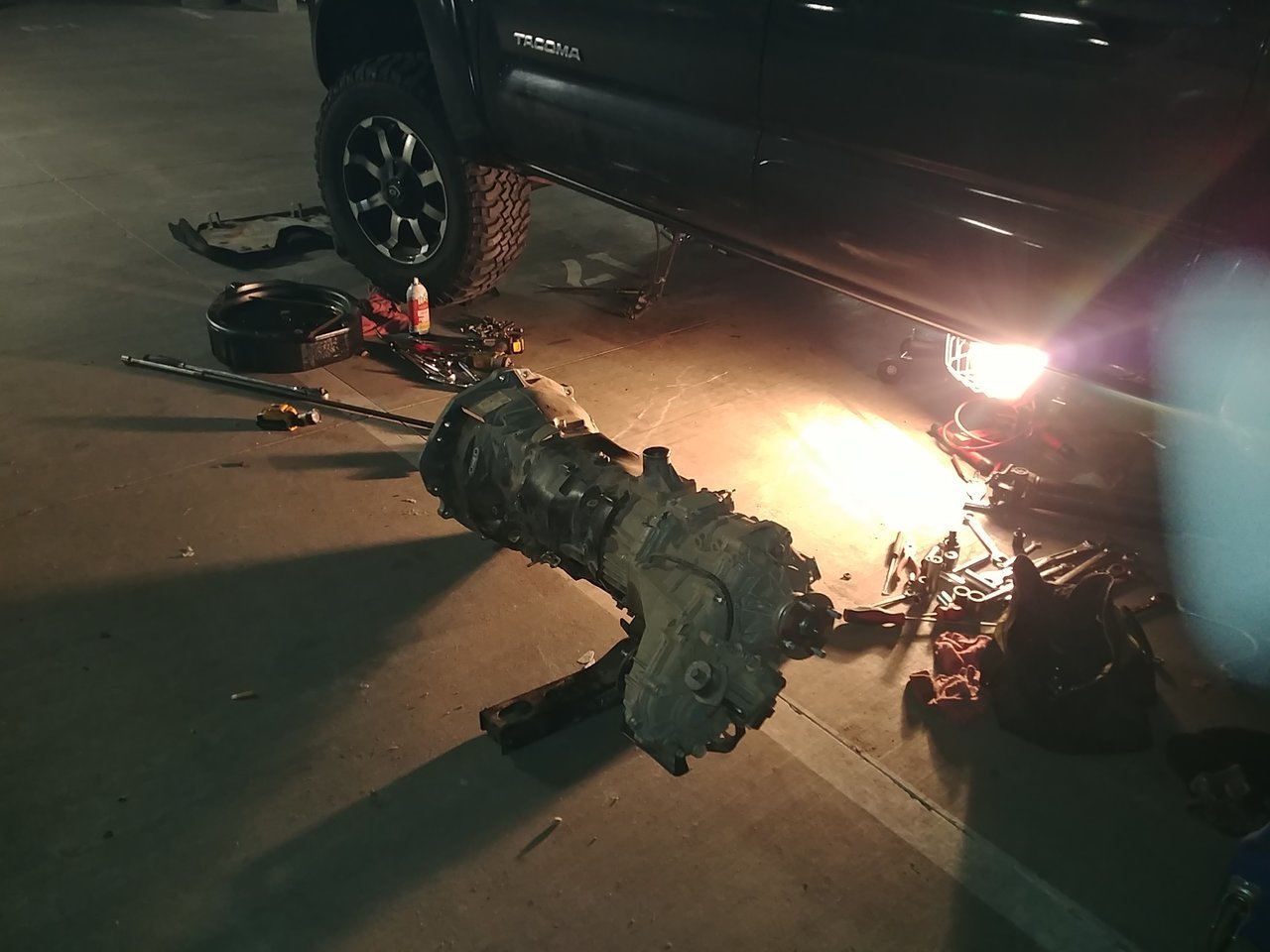

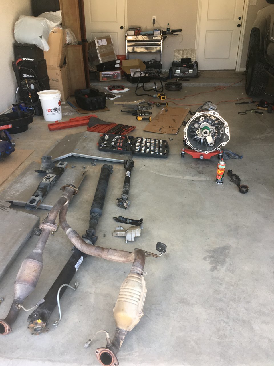

    Well everyone, it went smoothly!!!! It took a very long time. I had a toyota tech come help me and getting the transmission out was fairly easy. I have pictures I would upload later. Here is what we did in order for those of you who haven't pulled this trans before.
    1. Disconnect batter since you will be removing starter
    2. You will have to remove your center console. It's not super hard.
    3. Remove the shifter covers and the shifter. The shifter will push down and twist to remove from the transmission. Look up some videos if you're not sure.
    3. Undo the exhaust flange from the cat back. The cat back can stay in the truck.
    4. Undo the exhaust flanges between the y pipe and the first two cats on either side. This section will slide out from the rear of the truck. (remove 02 sensor clips first) there are also some brackets connecting the cats to the trans. Remove those while you're there.
    5. Undo front and rear drive lines. Make sure you index the driveline with a punch. You can do this by punching a mark just on the housing right where the drivelines separate. there are a thousands of ways do this so however works for you. Just make sure you bolt them on in the exact same position as you took them off.
    6. There are some sheilds you'll want to remove. one is under the trans and then you can also remove the one where the peak hole is going into the trans.
    7. If you're doing this swap, you can remove the slave cylinder. Otherwise, just disconnect the hydraulic line.
    8. Undo the electrical connectors to the trans.
    9. Undo the starter. There are two bolts and three different wires. Its a bitch so good luck. You don't have to remove it all the way. We didn't pull it from the truck. We just got it out of the way of the trans and it rested in its home. You cannot leave the starter on and pull the trans without it being a struggle getting the trans out.
    10. Throw a jack under the crossmember that holds the transmission in place and rest it there. Undo the two bolts on each side that hold the crossmember in place. Drop the cross member onto the jack with the transmission and all. If drop that cross member with the trans about 4" under its normal height and rest it on the jack, you can reach all the top bell housing bolts with about a 3-4' extension. its really not too hard. you just need that extension on a swivel socket wrench and you'll get it. they're 17mm.
    I'll upload more later. There are some basic steps for pulling the trans. I'm so sore! I started at 12pm on saturday. My toyota tech helped me until 10pm. We got the bell housing bolts torqued and the clutch bled and then I did the rest myself. I was up until 430am finishing her up. Long day. Very very sore. Slept 12 hours the next day. I have pictures coming.

    Didnt get as many pics as i wanted but here you go. 20180120_191927.jpg 20180120_191852.jpg 20180120_160802.jpg 20180120_170036.jpg 20180120_172731.jpg 20180120_172740.jpg 20180120_182021.jpg
