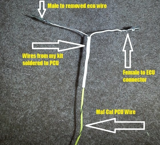

    not they arent the plugs, they are pig tails that have the correct terminals, you remove the wire terminals from the ecu connector and install the pig tail into the connector, there will be 2 pig tails for ever wire on the ecu, a female to plug into the connector on the ecu side, and a male pigtail that goes inside the removed female. you only solder the pig tails to the PCU. i will post a pic to explain better this week ;)
    It would be possible but you would need a 6 pole double throw switch, and there's more risk of failure. it could be done but i dont think it will be a route i will pursue for these kits :eek:
    Pic of example wiring:

    I don't think it will take a 6 pole switch as I was only considering bypassing the functionality, not the entire PCU. I believe that you only need to bypass the MAF sensor wire, not the tach, tps, power or ground. But, end of the day, your choice. I just thought that might be something to consider before you start selling.
