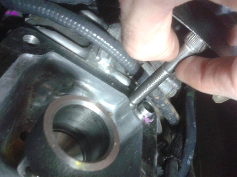

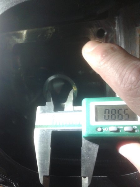

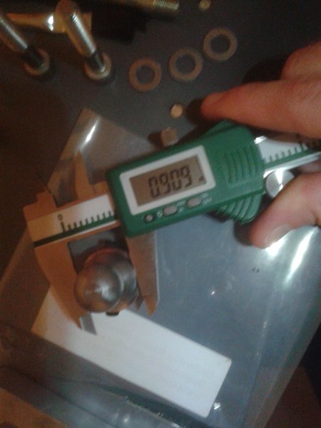

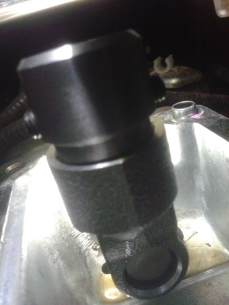

    20161027_130610.jpg 20161027_131431.jpg 20161027_133307.jpg 20161027_131828.jpg 20161027_130610.jpg
    Alright so I removed the shifter assembly. Trid to do a dry run with the spacer/shifter. Like I said before the bolts are 2 1/4" OAL. From tranny top to tunnel is 2 1/4". There is absolutely no way to get the bolts into the hole with the dowel pin in the way. Can't get the bolt up and over it. I ran over to Ace hardware to pickup a 45mm long bolt vs the supplied 50mm. This did the the trick, however I'm now concerned with having the proper amount of thread engagement. Naturally the holes with dowels are counter bored to allow for the dowel to fit inside. This obviously means the threads are well below the mating surface. A few options here. Cut/bend/drill the tunnel, or drop the tranny down a little. I say fuck that shit. To add to all that, my shifter ball bottoms out in the rod socket before allowing the shank of the ball to engage the sides of the socket. Plus the od of the shank measures at .910" , and the socket id measures at .865" so there is no way it's fitting even if it was the correct length. I'm thinking URD gave me the incorrect ball. Do you have access to a caliper or mic to measure yours? I sent Gadget an email, likely closed shop by this time on the East coast.
    Edit: With a 45mm bolt it gave me approximately 1/8"-3/16" of thread engagement. In the aerospace industry we typically use the diameter of the fastener as a minimum for thread depth engagement in aluminum. Ideally you want 1.5x diameter. In this case 8mm minimum. Pulling threads can be the outcome. Not an option for a transmission.

    Oh geez. You have surpassed my technical knowledge as I've never used calipers to measure anything. So youre saying that the shifter does not fit into the transmission properly? As if the ball is too big for the transmission and doesn't seat well? As far as the figment of the bolts, what about bending the metal up a little and then bending it back once it's in? This is my project for this weekend so I hope you find the answer. Gadget called me the other day so I'm sure he will follow up with you.

    I'm not sure cutting a bit of sheet metal would cause any harm as long as you seal up the bare metal after. The TRD shifter for 2nd gens had a step in the install guide to remove some metal, although not as much as it looks like you would have to cut. My 15 had lots of room to access the bolts from the top, so it may have only affected older models or something. As for reverse being more difficult, it is, but it's nothing to worry about. This only affects the 6 speed with the tension spring, which really is only there to keep you from accidentally grabbing reverse by adding extra resistance. I'm guessing people commenting on reverse with the 5 speed wouldn't notice any difference.

    could a button head socket cap screw give a bit more clearance? Or maybe drilling a hole above the bolt location on the sheet metal... either way, I can definitely see some issues there!

    I got a email reply from Gadget a couple hours ago. Apparently the ball extension is not meant to press all the way into the socket. The white plastic bushing locates the ball inside the socket, and that's it. He said I could pop out the dowel and install in the spacer so it doesn't interfere with the bolt. I had thought about that, but I was hesitant to remove it for fear of crushing or gouging the id of the dowel. I'm going to try that tomorrow.

    Sounds like a plan! I'm sitting over here wondering why the dowel is even necessary. Couldn't you pull it and toss it out?

    He emailed today and said they can be eliminated completely. I'm not sure if I agree or not. I did remove one in the front, the other is stuck. I'll likely leave the stuck dowel in rear hole between tranny and spacer. The other will go between spacer and shifter plate. I'm trying to get this "20 minute" install wrapped up tomorrow. It's dragged on for to long lol.
