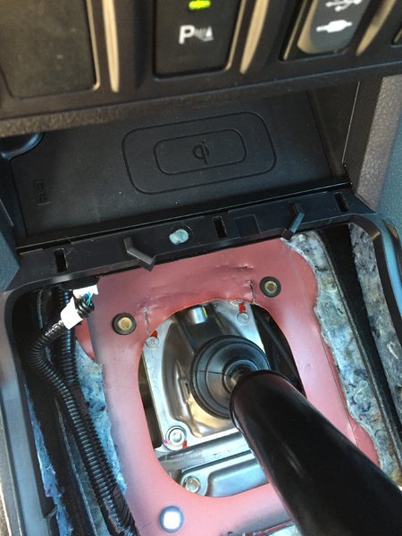

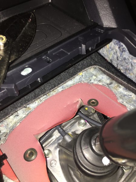

    Ok, so I tackled mine today. I still could not get enough leverage on those front bolts to remove them so I used some tin snips and cut the tunnel in two places and folded a section back. Once I could access them it was so much easier.

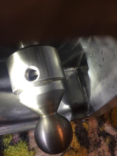

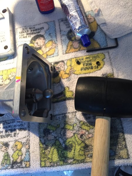

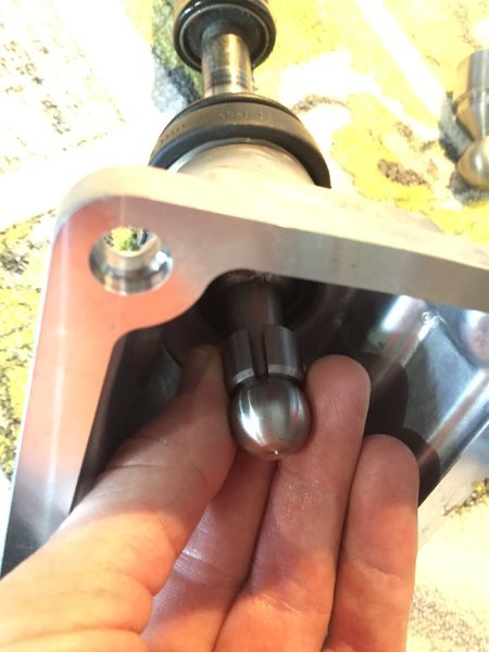

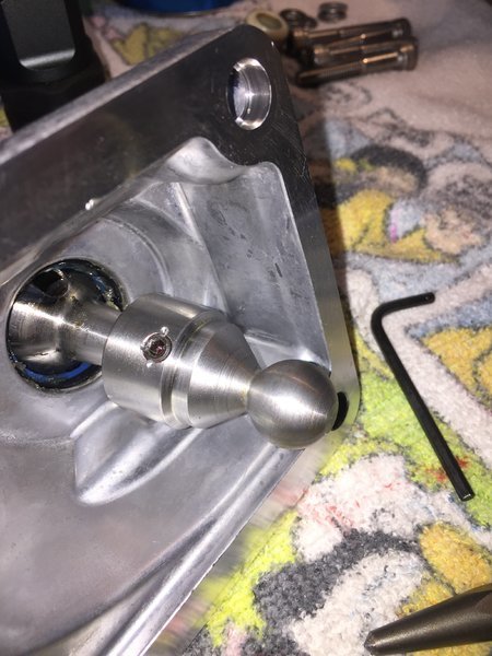

    The c-clamps did not form a complete circle around the shifter and getting the urd shifter ball onto the stock shifter ball was tough. I ended up having to line it all up and tap it over the stock ball with a rubber mallet. The urd ball goes on far enough to be able to see the c-clamps through the set screw holes, mine came about 1/2 into the set screw hole. Tightened the set screw as much as I could And secured them.

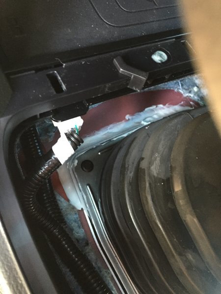

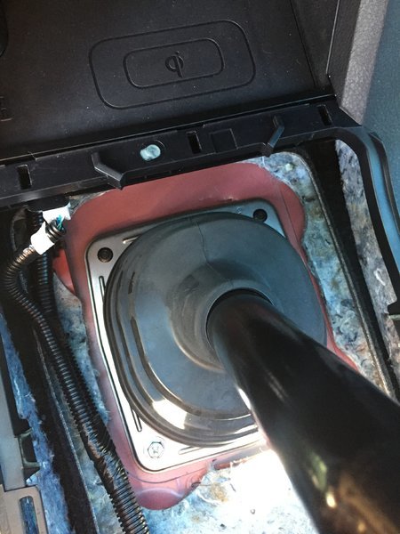

    The dowel pins were stuck in the transmission and would not come out. I just placed the spacer onto the transmission and then set the shifter assembly on top of the spacer without dowels. I tightened all the bolts and replaced the shifter boot. The front part of my boot had a small gap and did not sit flush with tunnel. I'm not sure why they used bolts in the back and plastic fasteners up front. I used some caulk to fill in the gap.

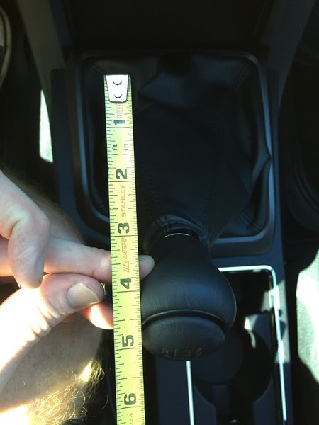

    The distance saved on the shifter throw is awesome and it feels more like my sports car now. The old shifter had a 5" throw from 1st to second and the urd has a 3.5" throw.

    I am currently stuck at the C Clamp stage.. Cant seem to get the new ball over the old one.. Wondering if I do indeed need to rubber mallet them on there.. I ran out of time so I had to abandon and put my stock set up back together... Anyone have this same problem?

    Yes, you will need to hold those c clamps in place and then use a rubber mallet to seat the new ball onto the shifter assembly. I used a little bit of grease to help the process along and it seated well with a few hits. Good luck!!

    Not that I recall. Just make sure to use locktite on those set screws and secure them in place by using a small punch like in the directions. Reverse will be really tight and will require some "slapping" but you get used to it. Let me know how it turns out. I love the difference it made.
