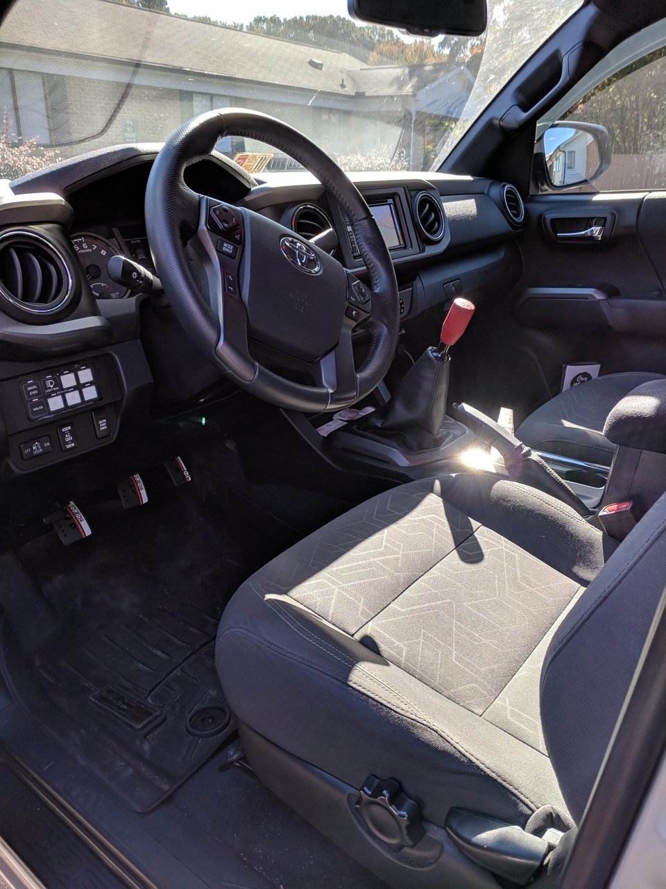

    look on the MT BS thread, many pics. when you unclip the OE knob's clip, then the boot drops. ¾" grommet takes care of it. i did it a little different by also wrapping suede leather strapping cus that's where my fingers land.
