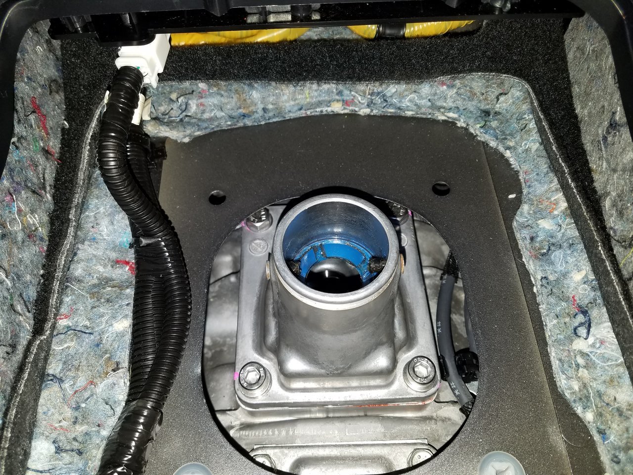

    Well it's done but it wasn't easy. However I was able to avoid cutting or drilling the transmission tunnel. I did not use the studs, I used the hex head bolts up front and the Allen head bolts at the rear. The trick was to remove the dowel from the right front hole of the transmission with vice grips. Then put the two front bolts through the shifter housing and the URD spacer and slide the assembly forward into place while using one finger to hold each bolt up. Screwing the bolts in is a challenge, I contorted my fat little fingers in there and got them snug, then finished up using both ends of a 13mm wrench just a fraction of a turn at a time.

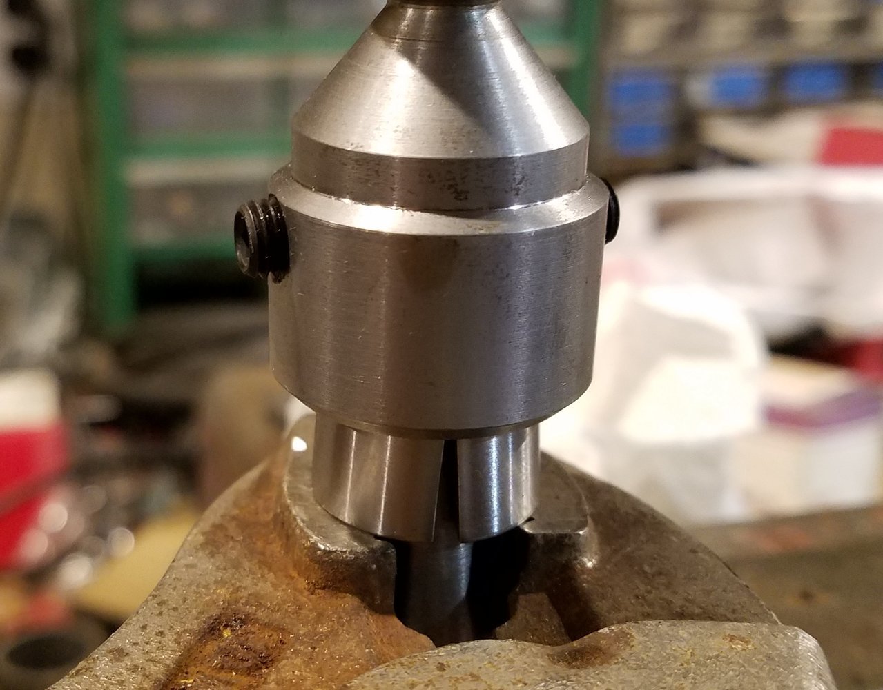

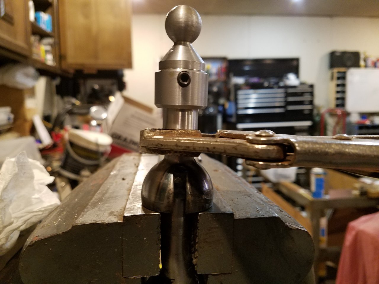

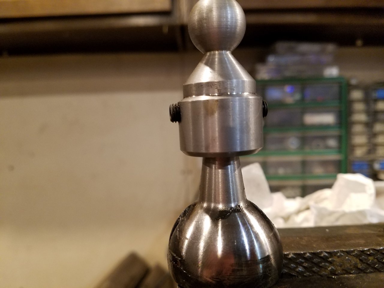

    Installing the extended tip was also a bit tricky. The first time i tried tapping the extension down over the two clamshell pieces, one of them shot out and across the garage. My solution was to put vice grips on the shaft just under where the clamshells needed to be to keep them from getting away. That allowed me to get the extension started, then i moved the vice grips up to the clamshells and gently squeezed them together while tapping the extension on further. When the extension is fully seated, the clamshells are not visible.

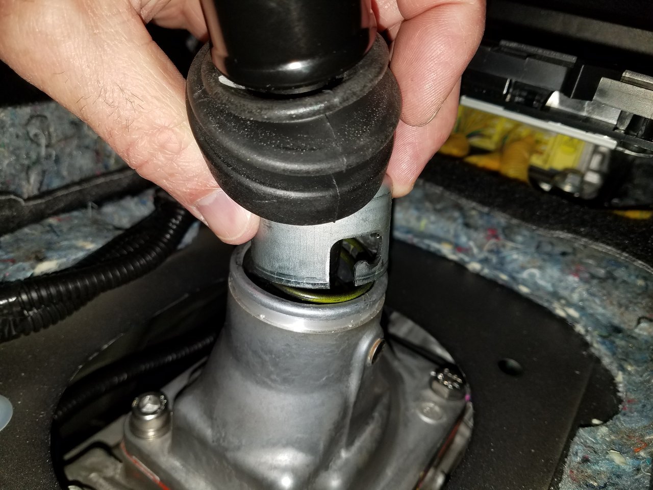

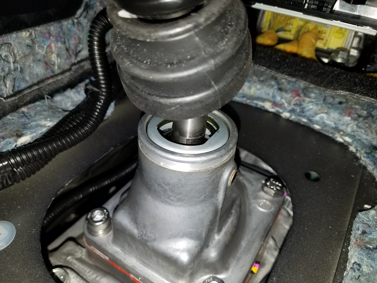

    I noticed not everyone is removing the shift lever from its housing. Doing so will make things easier, especially installing the extension ball. To remove the lever, pull the rubber boot up. Push down on the inner ring with both thumbs, then turn it counterclockwise and release, it's that easy. Then pull the lever up out of the housing.

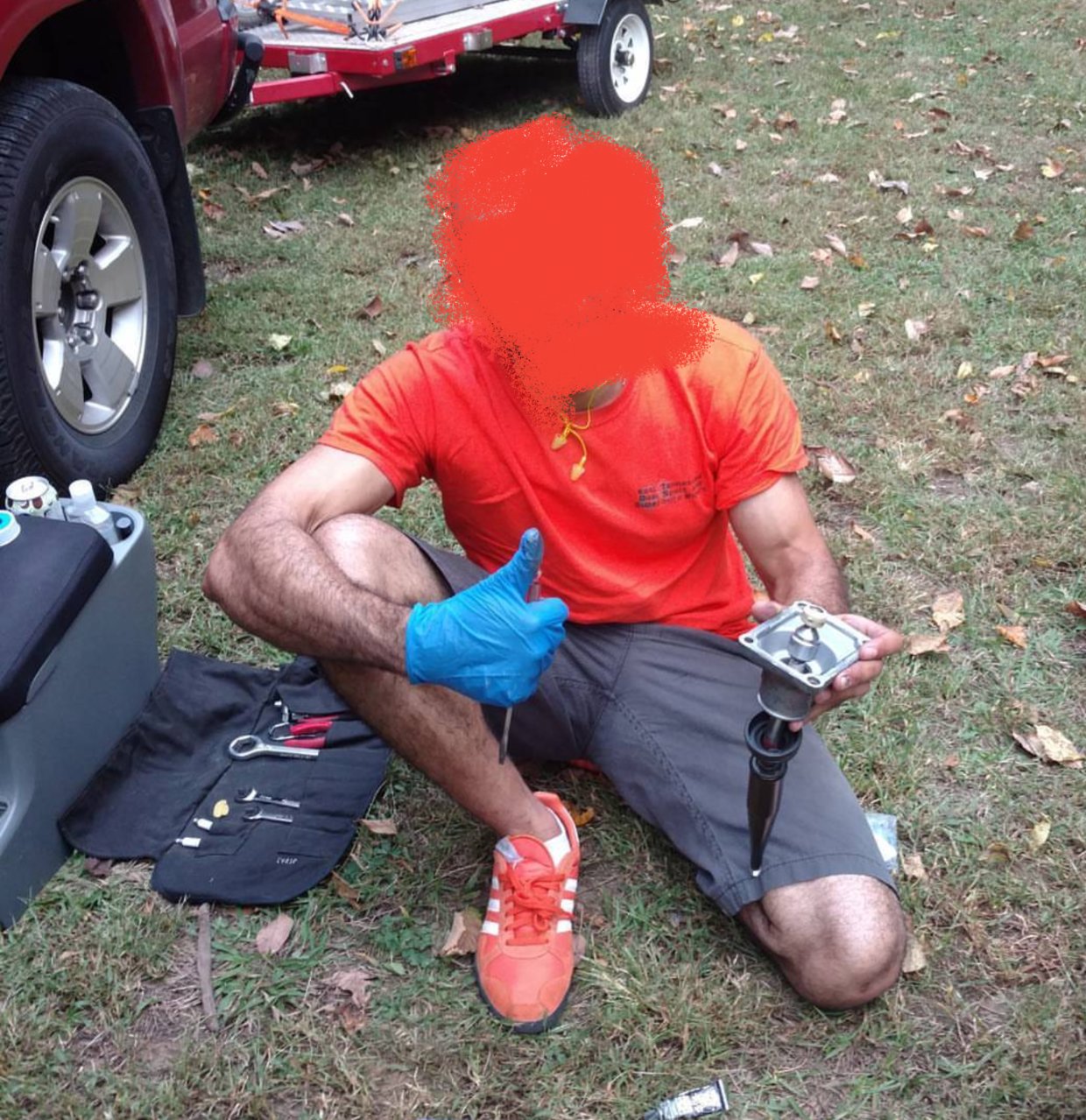

  20. Feb 27, 2018 at 6:32 AM
    #140
    bwanamukubwa
    bwanamukubwa Well-Known Member
    Mar 19, 2013
    #100061
    295
    Tennessee
    For anyone reading this, i had a good experience with the URD short shifter.. until it broke while putting it in reverse. I was riding dual sport in the woods with my wife and had packed up headed home for the day when it broke.
    Luckily, i had JB weld so i put it on and waited for about an hour. Tried to go from 2nd to pretty much 6th (or 4th if i had to) just to minimize changing gear. As luck would have it, the shifter separated again as i pulled into our driveway.
    The shifter (Toyota part) itself broke because i believe it wasnt meant to take the shear/torque. I've since replaced it with the TRD version. Just some feedback for anyone deciding between the two.
    edit: I apologize for the sidetrack but i realized i'm missing a center cap for my 17in alloy wheel and if anyone has an extra one, i would be much obliged if you could sell me just the one. Thanks in advance.
