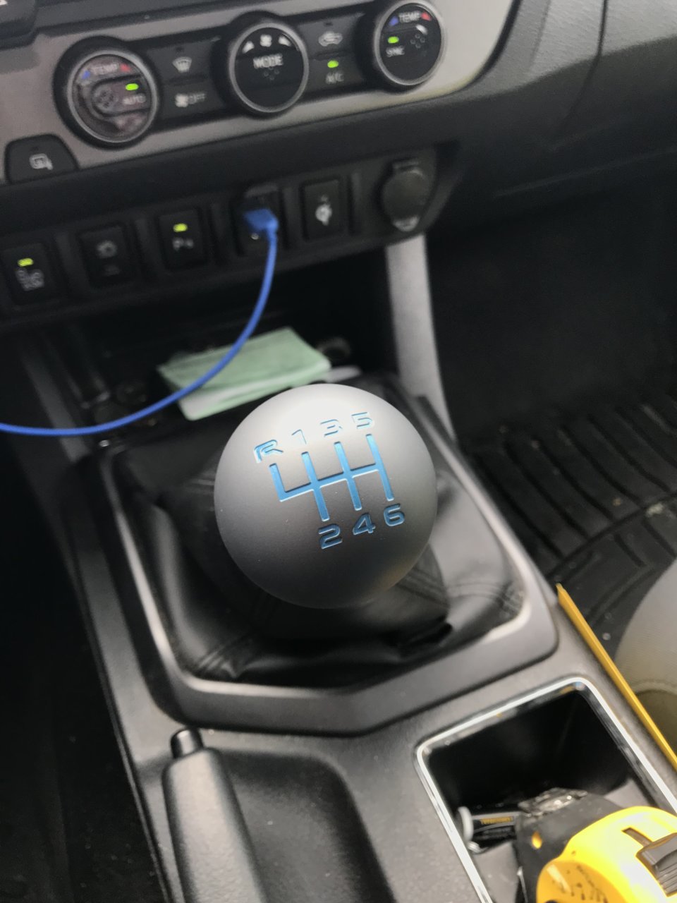

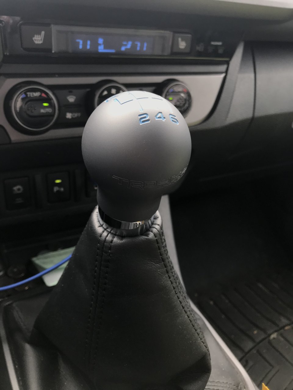

    I took my weighted SS knob with Aluminum core off to have it cerakoted and put the stock knob on in the interim. Wow what a difference the weighted knob makes. Such a better experience shifting it with the combo of the URD short shifter and the weighted knob. Cerakote paint job turned out pretty good too. 50BCAFC9-F678-41A1-96BD-B517029EEDC9.jpg9122FEDF-B30C-4A1D-B8D8-85EB73787BB9.jpg
    Hiker trash, Shepherd12 and pinochle like this.

    How do you people not burn yormur hands on those metal knobs? Does it just never get hot there?

    It doesn’t generally get hot in Portland, OR, but we did have several 90+ degree days this summer. I just close the moonroof shade and keep the knob shaded from direct sunlight.
    But I also don’t keep my hand on the shifter all the time. It only takes a second or two to shift from gear to gear. I can imagine it might be an issue in warmer/southern climates though. This morning it was refreshingly cold to grip actually.

    Were did you get that knob? Looks awesome!

    That thing is beautiful! How much did it cost to get it cerakoted? And how did you color the numbers?
