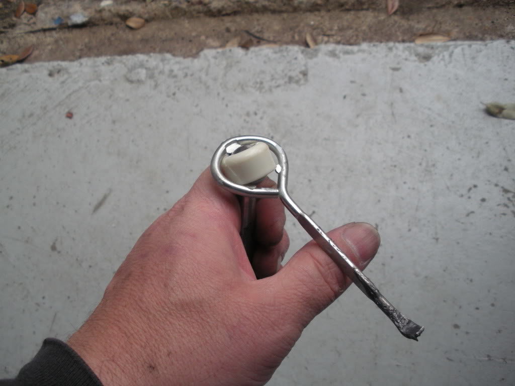

    While installing my Urd shifter the plastic bushing cracked. Is it still usable? How f!cked am I?

    i would probably get another one.. not a good idea to have something like that disintegrate while your driving and get plastic chunks in your trans
    i thought something was wrong with your thumbnail at first glance before i clicked the pic too lol

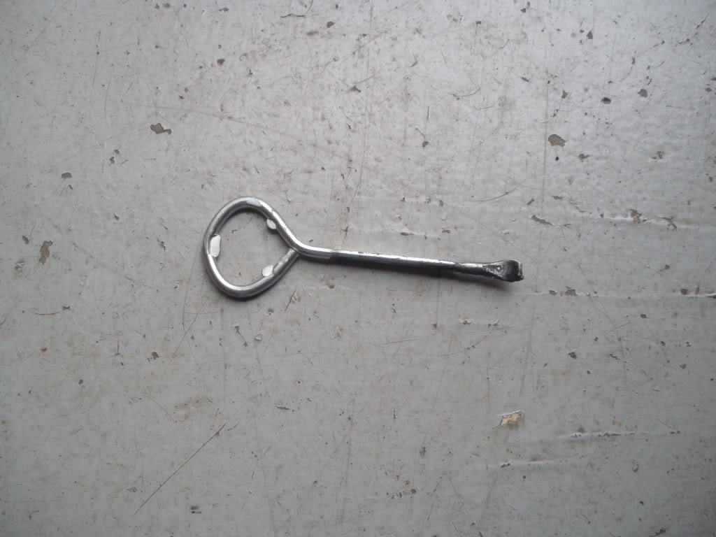

    The dealer normally stocks this part. I have bought several. Should be in the $10 ~ $20 range, depending on the dealer.

    When pulling these off, use a paint can opener, like what they give you at Loews or Home Depot, when buying paint.

    nice tip Coupe! ^^^
    I remember how hard it was for me to pry mine off to install my URD shifter kit, wish I would have known that tip back then!

    You aren't kidding...I spent a good 25 mins on this part of the install...and 25 or 30 mins on the rest of the work...
