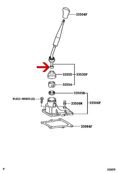

    went to a second dealership and they said the same thing, they do not even have a part number for that piece. You have to buy the entire shifter assembly for about $200

    Anyone with a lathe could easily turn a new bushing in a matter of minutes. There is no way in hell that you have to buy a $200 shifter assembly to get it.

    So a week later and I ordered the bushing from marlincrawler, only problem is they sent me the lever ball seat instead. I have tried calling them all day and have got no response from them. I sent some emails as well I hope they get back to me.
    I also got the 6 speed bushing from Tinker_Troy it was too big so thats a no go. I really want to get this done.

    yeah that is the same looking diagram the guy at the parts department showed me. It looks like the part pointed to in red is the one I need and it is not an individual piece. Unless it's one of the other pieces...

    finally got the bushing from marlin crawler, took two weeks but they finally got it right. It is very tight right now shifting and sitting in neutral. Should get better with time. Thanks for the help all.
