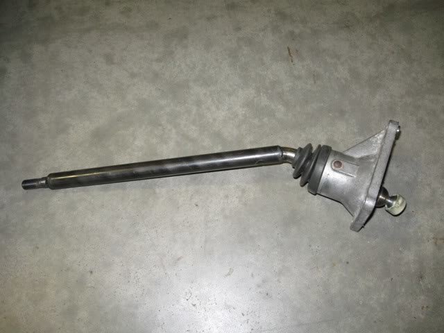

    Heya Gadget, thanks for jumping into this thread!
    They're talking about a piece on the stock shifter and not your components. The issue some people have had is that the change in leverage from the extension wears out the rubber bushing between the two pieces of the stock shifter.
    The issue doesn't always arise and is most likely the result of poor shift technique. My truck was fine until my dad drove it for a few thousand miles. He had issues finding the notch for reverse, would muscle it in, and wore out the bushing pretty quick.
    My personal solution was to cut the stock shifter and weld a piece of chromoly tubing in place. Also did some brazing to make sure the URD end had zero play in it and would never come undone.
    Ignore the fact that the shifter is installed backwards in the base in the above picture. :eek:
